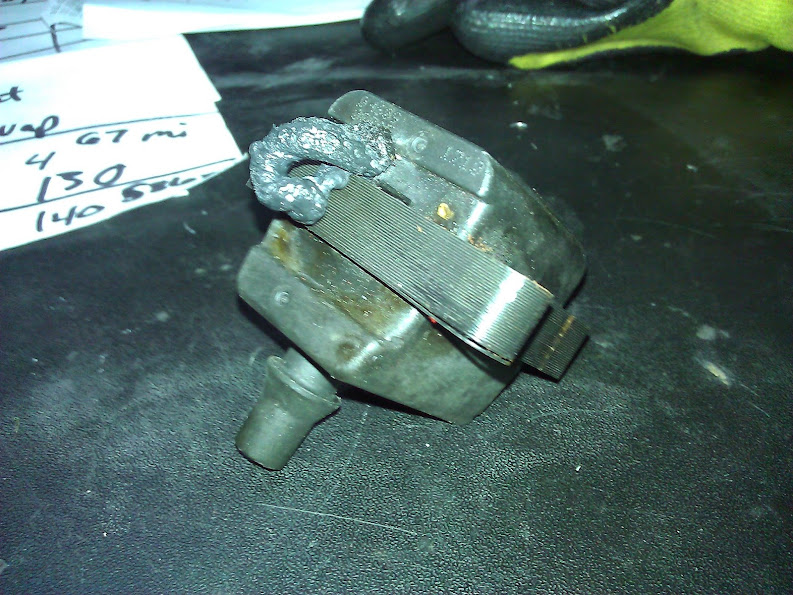

Hopefully its just a bad ignition module. That will cause the car to sound like a subaru too. I've had it happen a couple times on different cars.

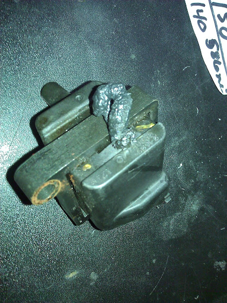

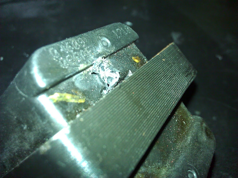

Well, fixed the car. Check this out:
The #1 coil literally sh*t its guts out. I guess there's something in the wiring or in one of the coils shorting out the system. I swapped a new coil into #1, and the car ran good for about a minute. After about a minute, it started running like sh*t again and I shut it down. I popped the hood and felt the new coil I swapped in, and it was hot. Noticeably hotter than the other 3. I guess I have to tear down the COP system, and see what's up. After I figured out the issue was with the COP, I swapped in the factory coil and a set of plug wires. After that, the car ran awesome.

Brett, that coil looks crazy. Looks like you burned one of those snake fireworks on it. 210 is a tad high. Have you swapped in the 180 thermostat yet? It really makes a difference. I'd do that asap.
