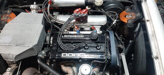

If all goes well we should be up in BIR for PG #1. We have put a few miles on the motor and at WG pressure everything is looking really good. I plan to take it out for a 3rd gear hit at WG pressure tomorrow then load it on the trailer, and leave work asap on Friday. We need to finish the tune at the track so their will be some un eventfull 3rd gear runs on Saturday, then all we need is a 1.5 short time out of the thing then try for a full pass. ATM I don't care what it runs as long as it's going in the right direction. My end goal is to get a high 8, but in the 9s for this weekend would make me happy. Also with the exhaust cam timing fixed and the new super smooth Competion Clutch triple disk the power graph is looking better as well compared to 2014. And we switched to RAT k116, oxogenated 116 octane fuel. I am tired of head gasket issues and pushing my FIC Bluemax 2150 injectors to 90+ percent duty cycle. At 25psi on gas we were down to 55% duty, lol.

So the fuel change was a good thing for the car, off E98 and onto RAT K16. ATM we are at 72-74% duty cycle @42psi and log wise the car is happy. It has not lifted the head, even though its spendy I now have some street miles on the car and built up the confidence I need to get back to the track and try and try to better our 2011 peak of [email protected].... that seems like a lifetime ago now but we are still after it.

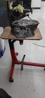

At the end of the 2014 season we hot lapped the car and hurt the trans, and also burnt a hole in the #4 exhaust runner into the coolant passage on the center divider, and we had major clutch slip issues with the Quarter master twin disk, and we broke an ass load of rear axles along the way.
So pulled the head and valve, welded and reinstalled, ordered a Competition Clutch Triple disk and DSS stage 5 rear axels. I forgot about the trans over the year and fixed the head issue, then at PG in 2015 with the Rocket boys holding up the show we figured out the trans was hurt, and we were limited to WG boost pressure, wiring issue to BCS. But the final pass of the day was a 11.8@130 with only 21psi.

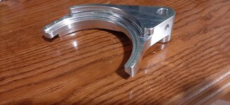

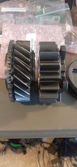

Now onto this year... after helping 2 local guys with trans builds I was trying to figure out how I could make this syncro mitsu parts trans work. I am still in the boat of no dog box, even the face plated trans at list price is out of my sights. I also worry I am well beyond what the stock gears can handle and putting a ton of money into faceplating does not make sense.
Also we were are having a hard time to get the car off the line at a sticky track, so the tall EVO 3 1st gear and 26" tall slicks proved to much. We were not able to up the power at the line enough to get the tires to spin in fear of breaking stock driveline parts, we adjusted the rear suspension to limit weight transfer, but with the hurt trans, low boost, and limited track time its hard to say if that will help us.
So over the winter I ended up using a Stock DSM 1st gear, but with reving to 9800rpm the 1/2 split is not ideal but working atm, and with a hole stack of fresh synchros I also shimmed the trans super tight, I found some info on how much more pre load I should be putting in based on HP level.
We also finalized our plans to make this a 4 speed trans to reduce weight of the input shaft and make less work for the synchros. So all said and done we were able to reduce the weight of what needs to change speed on shifts by 17%. Its a little harder to get into reverse but the up shifts have been super smooth, I also installed a trans temp gauge so we can make sure we have enough trans temp and not to much to over work the fluid. This was a easy modification and I was able to eliminate everything to do with 5th gear. So the trans is a little easier to work on now, lol.
