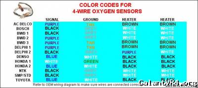

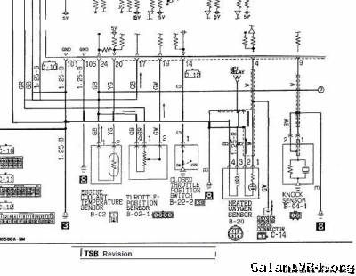

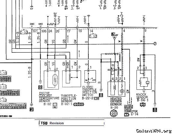

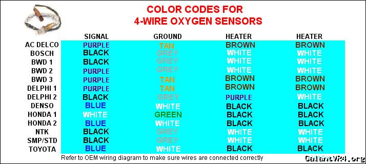

My o2 sensor is 4 wire plug but I am missing the plug ( on the harness) . Soo I need to cut my new denso 4 wire o2 sensor plug to match it to the harness . Maybe ecu wiring could help also !
