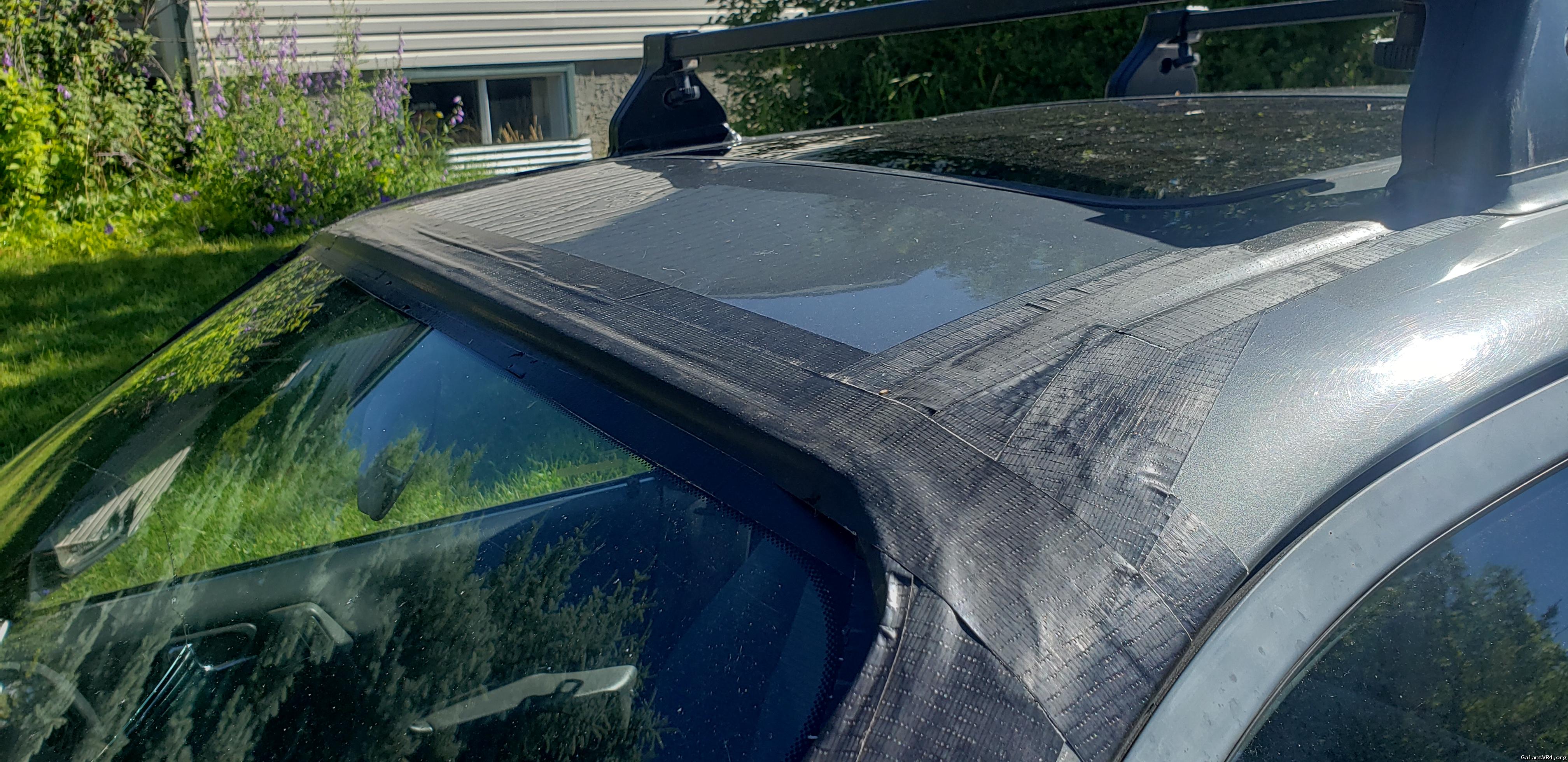

I've got tons of research to do to understand the ins and outs of this thing but I'm loving it so far. I was about to pull the windshield out and do some rust repair on the A pillars and roof where it meets the windshield, I called my trusty supplier and it turns out they can't get a windshield for it anywhere in Canada and gave me a big ole maybe from the USA.

Yep. We are in the same year group as the 1G DSM, because we basically are 1G dsm's. Nearly identical, mechanically wise. Crossover parts is basically what keeps our cars going, as the eclipse aftermarket was so massive. Glass should come off a Galant and fit yours exactly right, but I'd wait for more experienced members of the board to reply before you trust what I say
