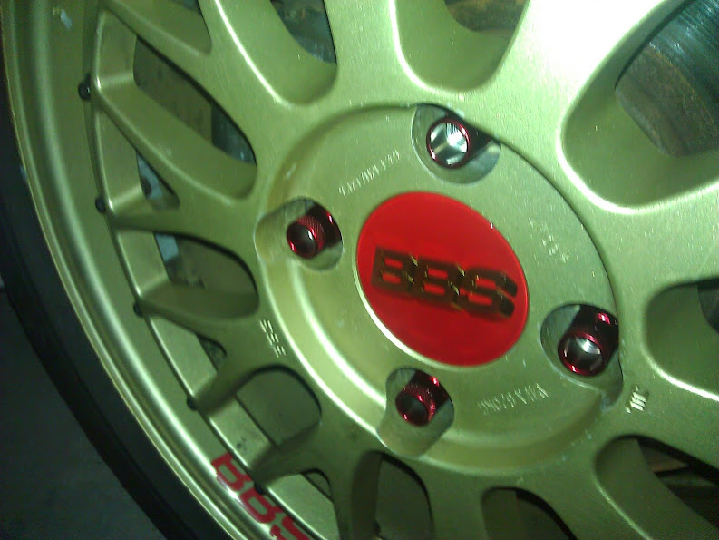

I picked up some new lugs. They look great compared to the old ones.

Quoting 89Patches:
Are those lugs aluminum?
They are made from forged 50BV30 steel, whatever the hell that means...

Ahh, I was going to say if they were aluminum throw them in the trash! To many bad experiences with aluminum lugs /ubbthreads/images/graemlins/banghead.gif

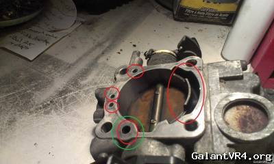

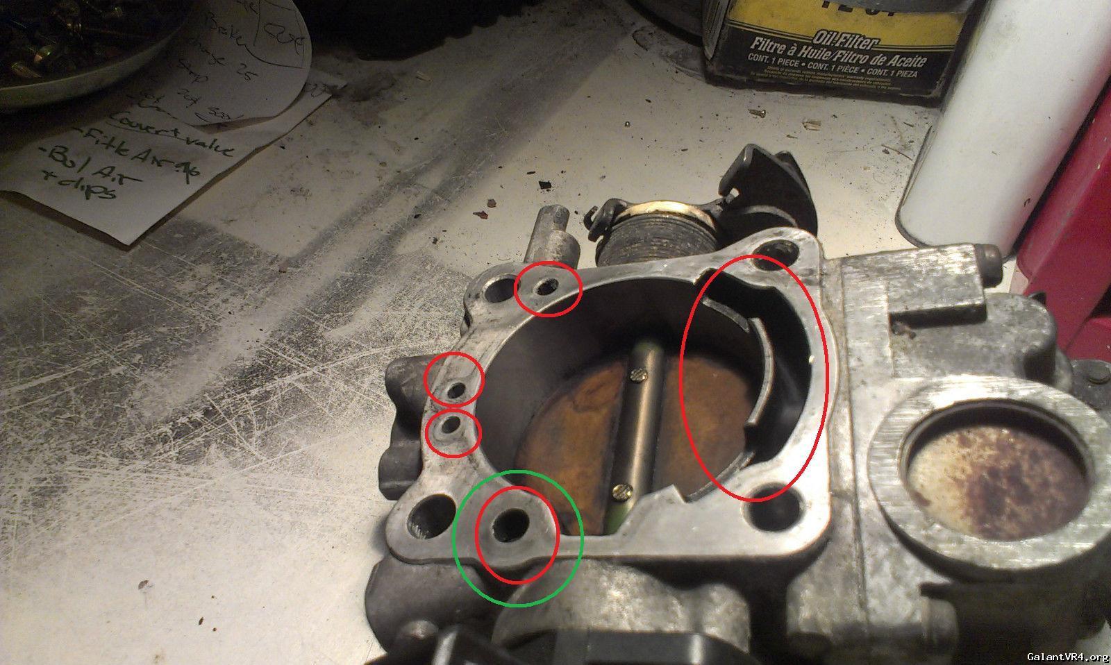

My other issue was a super low idle. I screwed around a bit with the BISS screw in an attempt to get the idle sorted out. I got the car to idle well enough to set the base timing to 5* BTDC. After I got the base timing set, I still wasn't super happy with the idle. I decided to boost leak test the car. I threw on the tester and charged up the system. I could hear a hiss coming from around the throttle body, but for the life of me I couldn't find it. I sprayed soapy water on every fuckin thing, and could not find the leak. Turns out, I think the BISS port on the inside of the throttle body is leaking. If I turn the BISS screw in, the hissing gets quiet and goes away completely when the screw bottomed out. If I turn the BISS out, the hiss gets louder. After looking at a picture of the OEM gasket and talking to prove_it, I'm sure all the ports inside need to be sealed up (the one I believe is causing my issue is circled in green in the pic below), and I don't think the gasket I have installed is doing the job. I ordered a new gasket, and will have it tomorrow. Hopefully that corrects the problem and clears up what little idle issues are left.

this may sound remedial, but would a new biss screw and o-ring not help with the leak, or is it way past that?
3,473
Yeah. So I made sure to check the BISS O ring for leakage when I did the boost leak test. Prove_it actually suggested that to me in another thread, so I made sure to double check it was good. The O ring itself is fine. By adjusting the screw there's a noticeable a change in pitch of the hiss. I'm fairly confident my TB gasket isn't sealing the port inside. I'll pull it off tomorrow to confirm.
