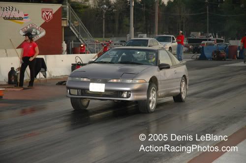

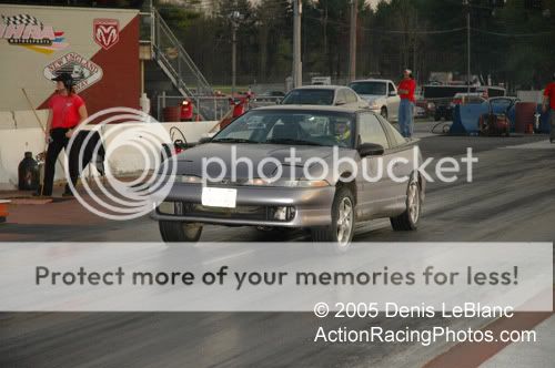

I haven't taken my Galant to the track yet but in my 91 Talon (I KNOW less weight) I ran a 12.3 @ 108 with and EVOIII, 550's, 2.5" turboback, ACT2600, and with an old school 5 knob AFC with every knob set at -30 (read NO tune) on 117 at 26psi. Everything else in the car was stock, including the tires, with 150K miles on it.
Unless your cars tune is seriously out of whack then it's just seat time and practice you need. The above time was on a 1.7 flat sixty foot on the said stock sized Eagle RSA's. I launched that thing like a mofo.
Also remember that one of the reasons our cars do SO well at the track is the launch. Hell my 14.1 second GTP will beat my friends 12.9 second EVO9 on the highway (stupid front wheel drive). So your car might not feel as fast as his because it isn't. You can just run a similar 1/4 mile time due to your launch.
And why go to a bigger turbo when your not using the one you have to it's full potential? If you haven't hit a 12 yet then worry about tuning and driving.
Here's a pick of the Talon at the track.
