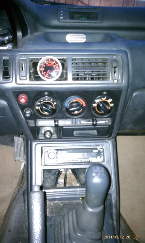

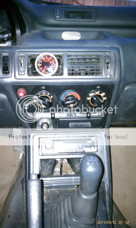

Got my prosport boost gauge wired up last night. Lights up white during the day and amber at night. I figured since the "blinds" weren't in the vent anyways that it must be meant to go there. Not the cleanest install, but I plan to make a nice bezel for it in the next couple weeks.

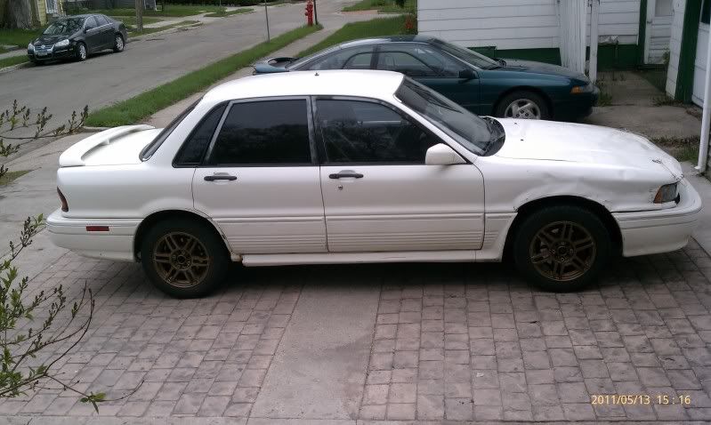

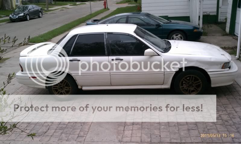

Also redid the wheels and threw on some new tires.

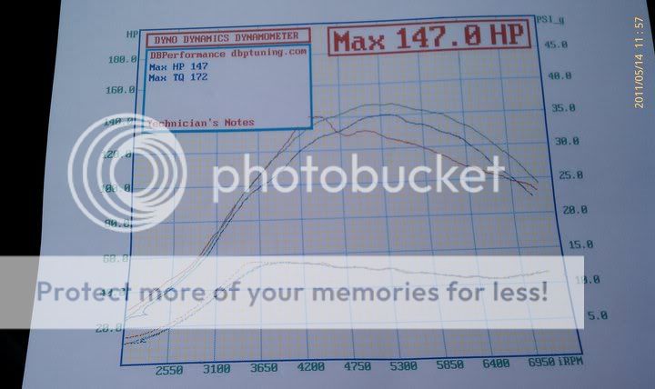

Threw it on the a dynodynamics dyno today just to get a baseline...Not a bad starting point.
a) It's stock minus exhaust and mbc set to 14psi
b) That's the power at the wheels aka after the drivetrain (not crank hp)
c) That's on a dynodynamics dyno. These read much lower than mustang and dynojet dynos.

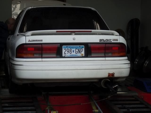

Haha I like your pedo bear sticker on the back

How much do u think it would of read on the other dynos?
My ISC is good, I've checked that.
dynodynamics vs dynojet
In this case the Dynojet would read %12 higher making my gvr4 read somewhere around 164whp on a dynojet. Numbers are just numbers though man. It's all relative and I just put the car on the dyno so I'd have something to compare to in the future.
