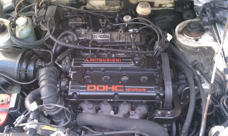

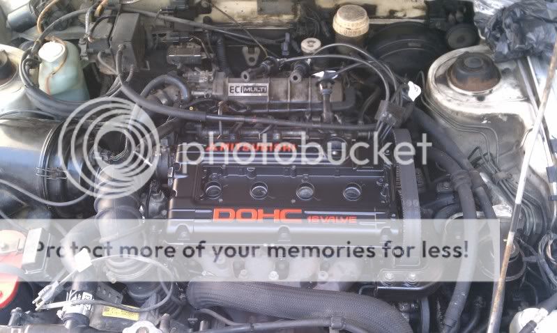

Well we got the crack in the vc welded up and I finished powdercoating it today. I think it turned out pretty well /ubbthreads/images/graemlins/smile.gif

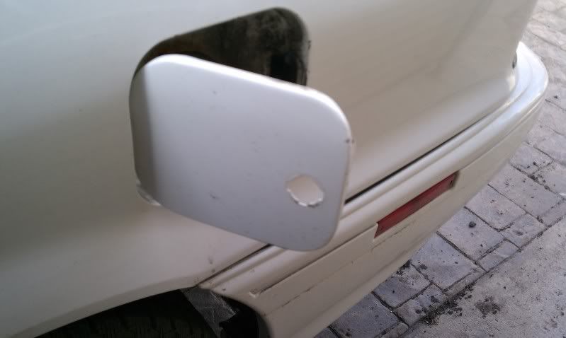

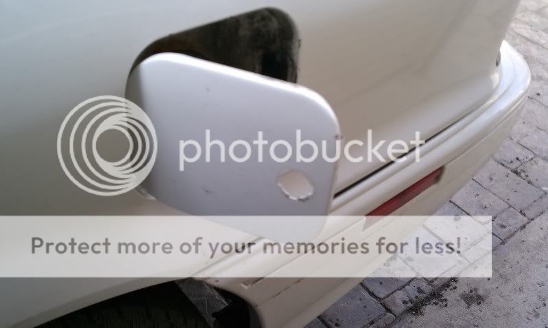

Also, I'm not really sure about the fuel door. Mine has a hole in it for what looks to be some sort of key spot or something? Anybody know if all galants have this key hole or should I just replace the whole door?
Ok that's good to know I guess. Weird that somebody would take that...Anyways, do all galants have a key hole like that? Or is there some other fuel door I could replace this one with from a different car? I thought I heard somewhere that dsm fuel doors would work...
11,990
JDM fuel doors don't have the lock cylinder and can be had on Ebay sometimes, or from one of the Aussie/NZ members here.
