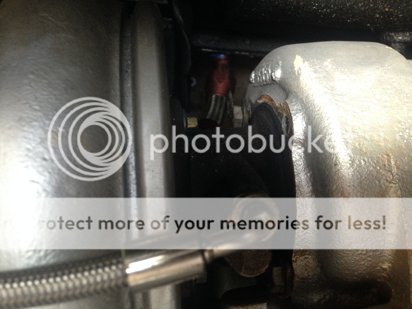

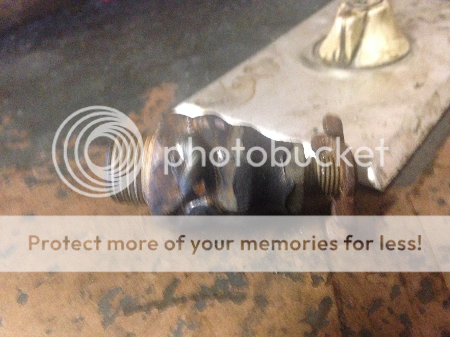

So I was maxed on boost at the 20psi so I pulled the wastegate off, thinking I needed more spring, saw this plug with the thread sealant on it was missing, so I had a big boost leak at the wastegate that was venting pressure at the top of the spring. I didnt change springs just fixed the leak, getting a hang of the settings for this new way of plumbing it. Turned up the duty cycle to 50%, and it climbed up to 30 psi before I got out of it. Realized duty cycle works backwards now and boost climbs with less duty cycle, so turned it up to 76%, and saw a sweet 22 psi and got the AFR right.

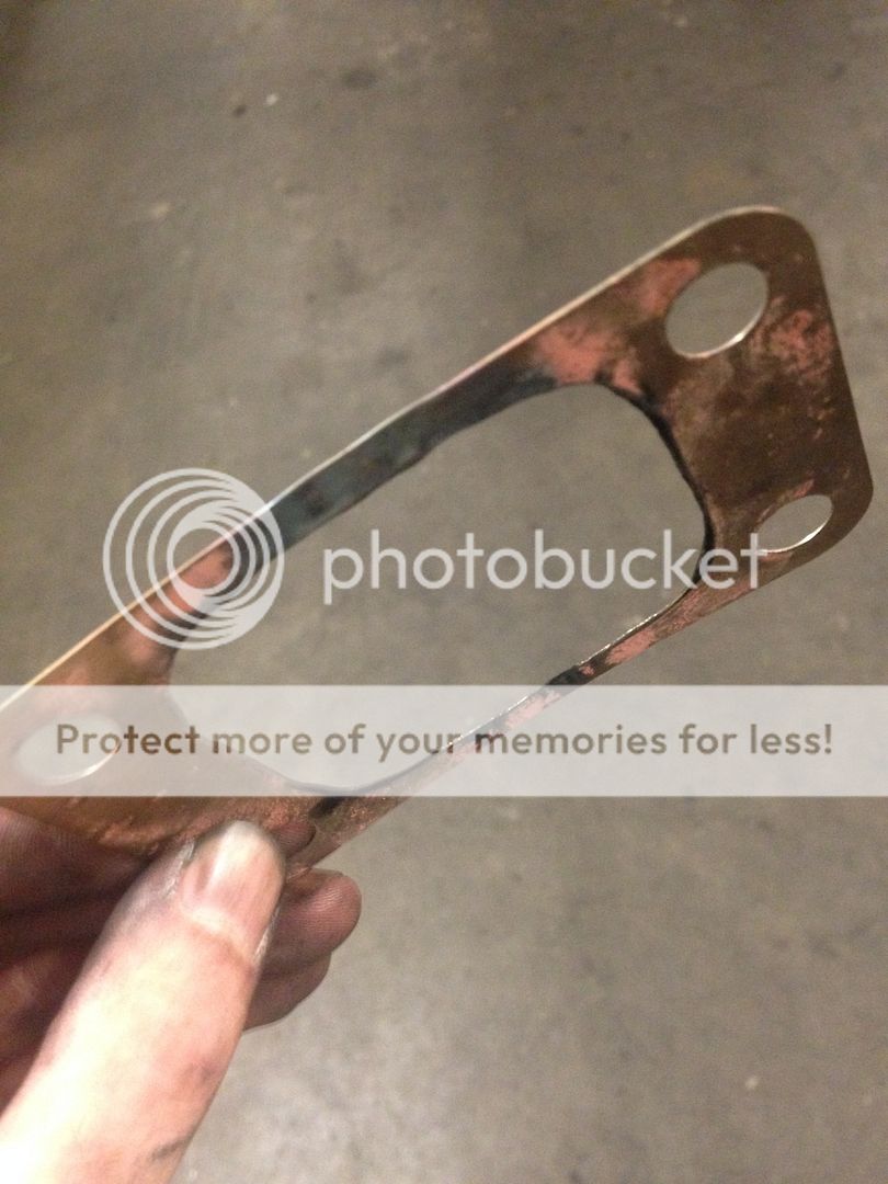

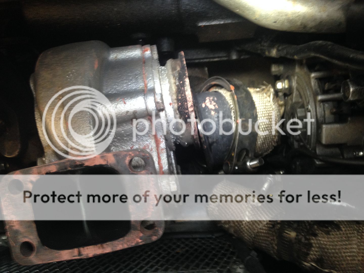

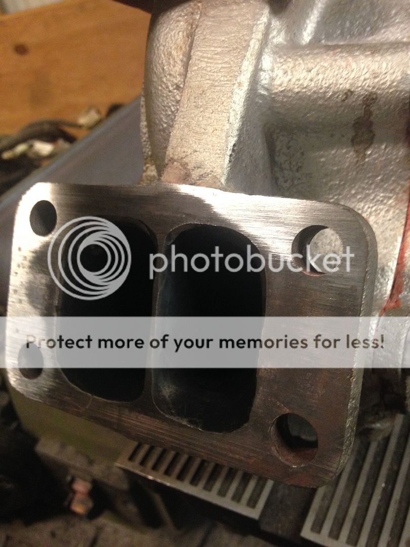

The turbine housing got taken off, and everything resurfaced.

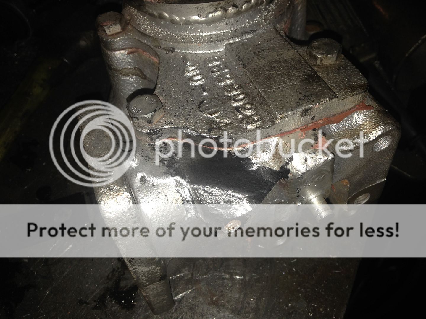

Then I milled the sh*t out of the housing to get a bolt into this corner of the housing. What it had before was a stud and a nut on either end, not ideal.

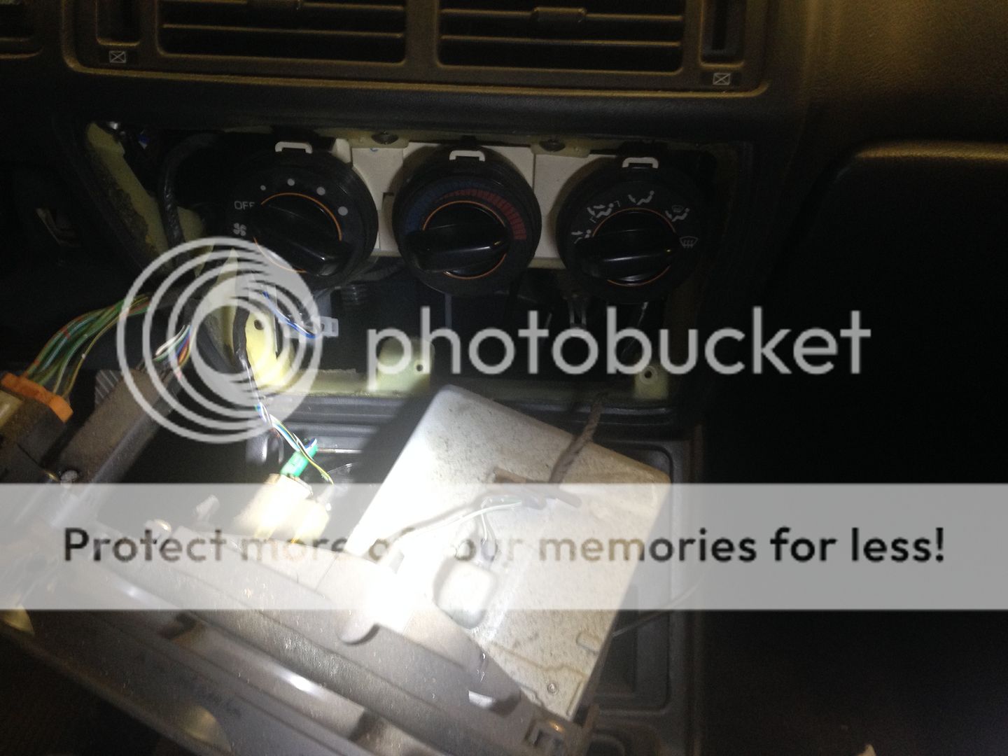

I also installed a deck. I hooked it up on the RCAs and everything, but still need to replace the full ranges before the sub/amp goes in.

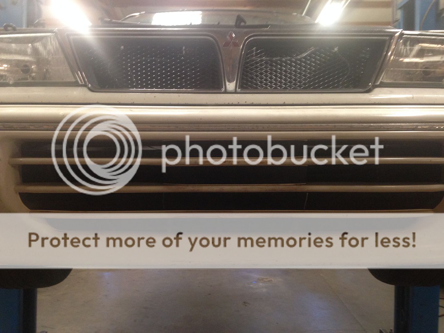

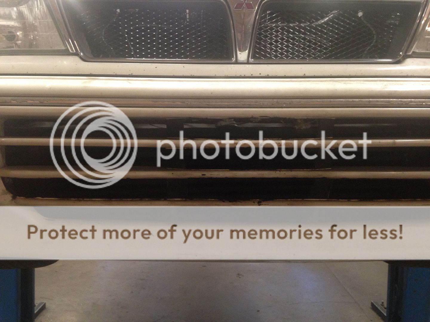

Then came a tasteful hacking of the bumper. I need more airflow without a doubt. So heres the before.
and the after
I left a few verticals cause I dont want any sag, but it should help for sure. I'll clean it up a little more when the time comes but its roughed in for now.

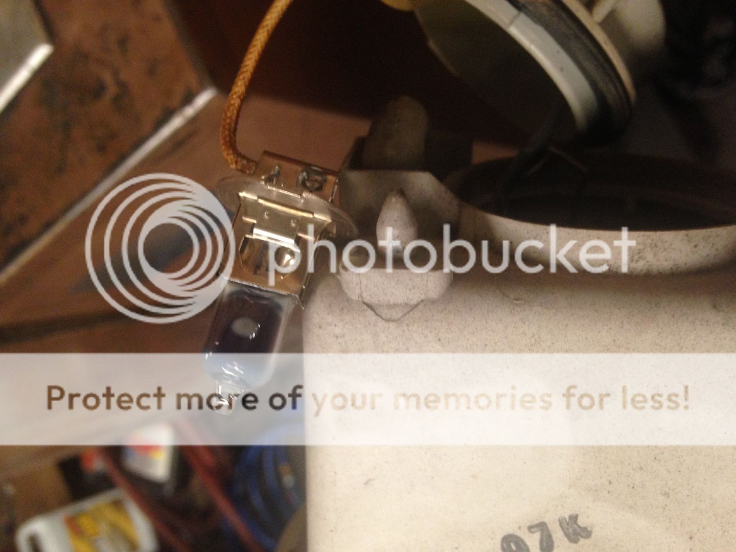

Then I pulled my foglight to make sure it was the bulb that was bad.

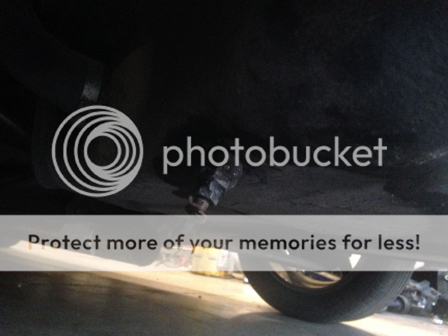

This next mod may seem a little bit odd, but it was to solve an issue I have with how I use my car. Think of it like this: Its race day, you're driving your car around on pump gas since E85 is 3 hours away. You pop the fuel feed off, run the pump and empty the tank, splash in the E85, and you're left with a weak ass mix of E45 after that due to all the gas still left in the bottom of the tank. I dont trust the tank drain plug being pulled repeatedly for this normal occurrence, so I wanted to put a radiator petcock into it. It sounded easy in my head, but was a little tougher given the fact I couldnt just drill/tap the way I originally thought. I pulled the plug, stunk up the shop, stole a petcock off a junk radiator, then saw the threads were close in size to each other and the tank drain wouldnt have enough meat left. Welded a nut as a coupler, countersunk so it could still flow somewhat, and made it all work.

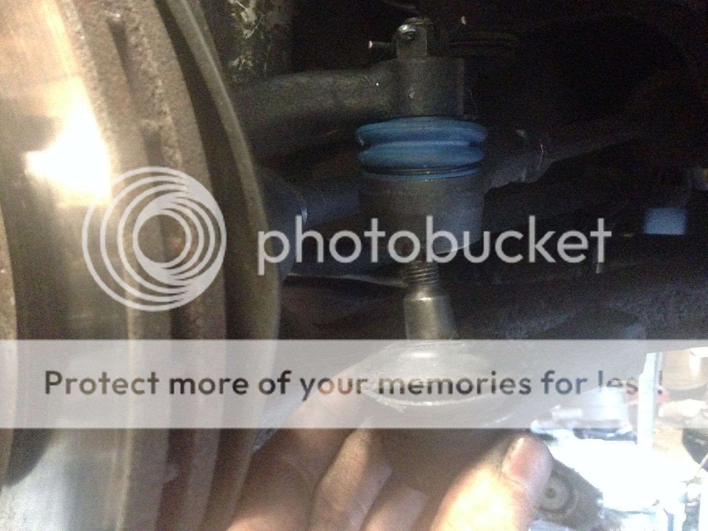

Then came outer tie rods, pretty straight forward there.

That "petcock" gets snagged on anything and you'll be driving a VBIED. Do yourself a favor and reinstall the drain plug /ubbthreads/images/graemlins/uhh.gif
GSXftw
Dec 22, 2014
111
medford, OR
Its part of the drain plug. If I snagged it on anything Id be doing something I shouldnt anyways, look how high it is compared to exhaust.

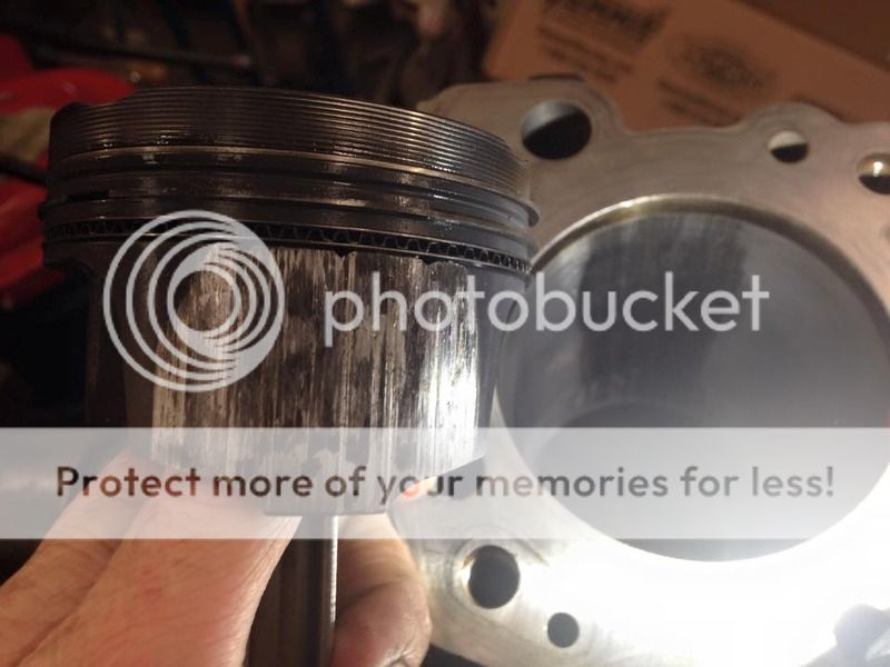

I was being super easy on it with 15 psi, 7k redline, just working it in still while the clutch broke in and starting to get a taste of the high rpm flow when a knock under load started. Its actually a mixed blessing since the trans never wouldve shifted at the 9k rpm I was hoping for, turbine shaft broke on the GTX3076 I was running, and decided to go with a main girdle.

I got a replacement piston, which are wiseco 1400 HDs, and a new set of rings. My buddy Jesse at legendary coatings
click,d.amc
did it just like he did the others back in the day which is thermal coating on top, slick coating on the skirts. Then the machine shop went ahead and honed out the block to .004 PTW for free. So basically this mess up only cost me 225 or so, definitely easier to swallow with that.
