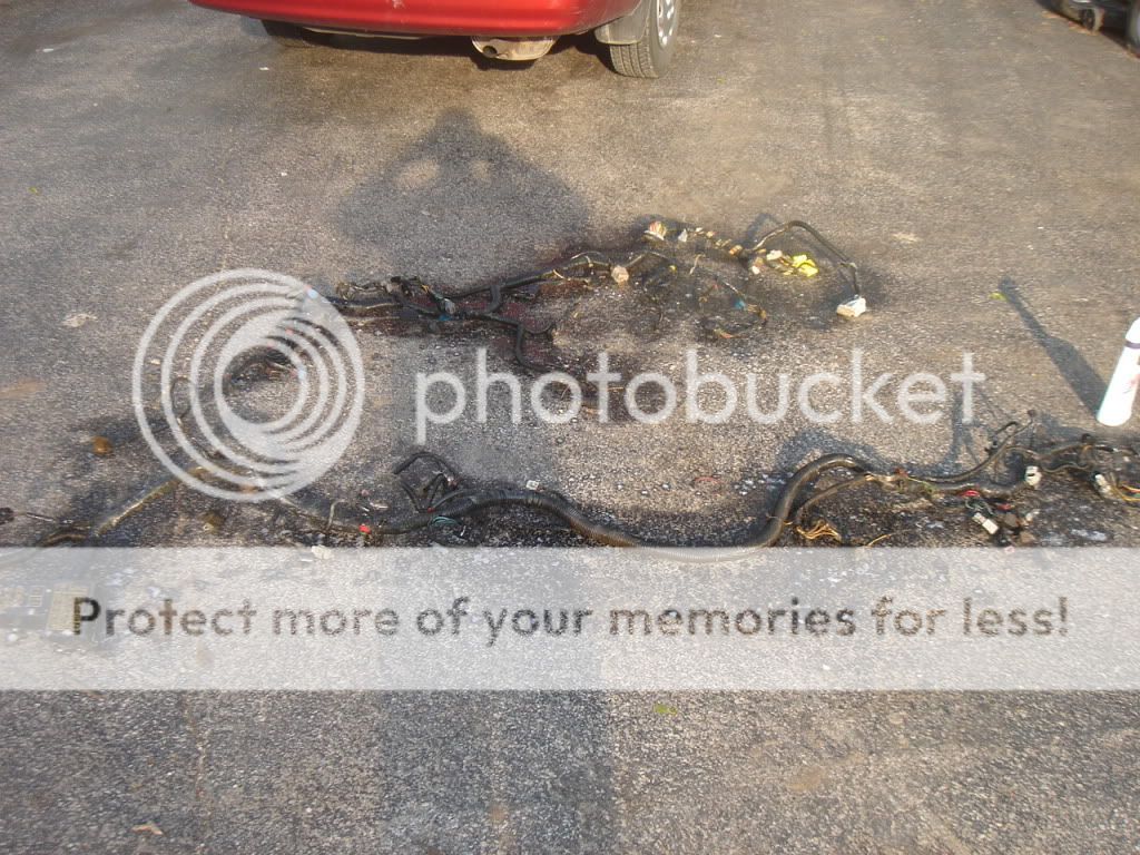

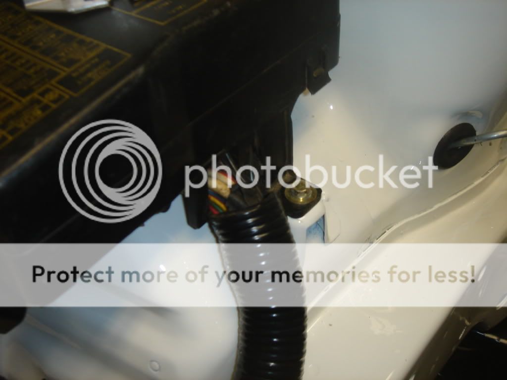

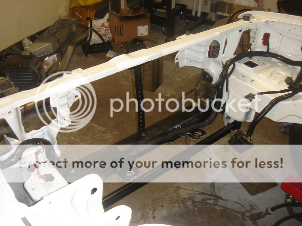

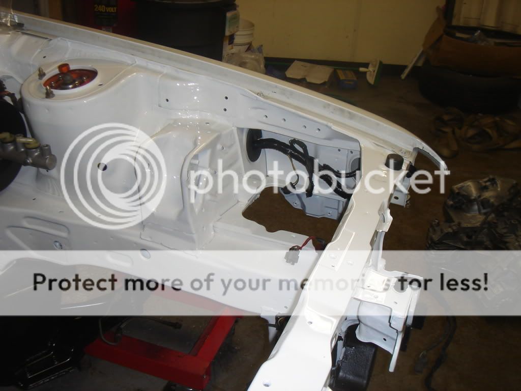

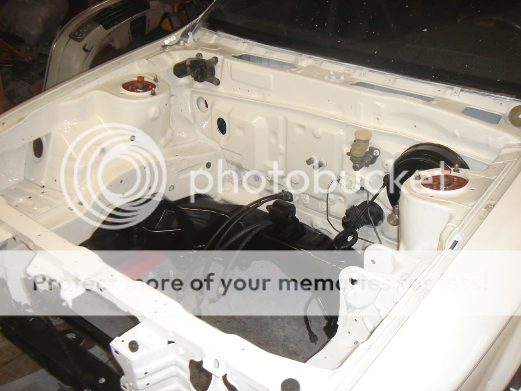

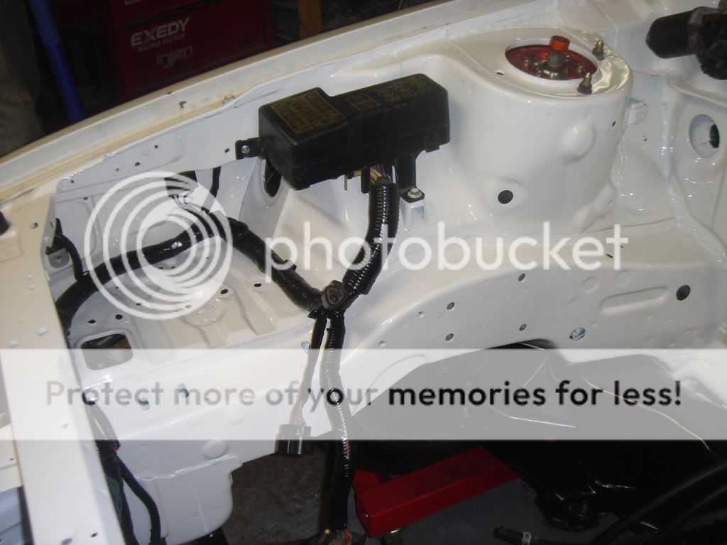

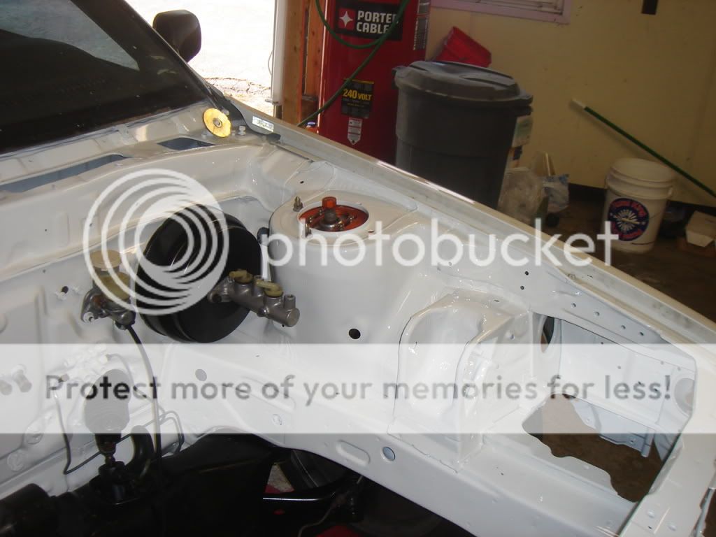

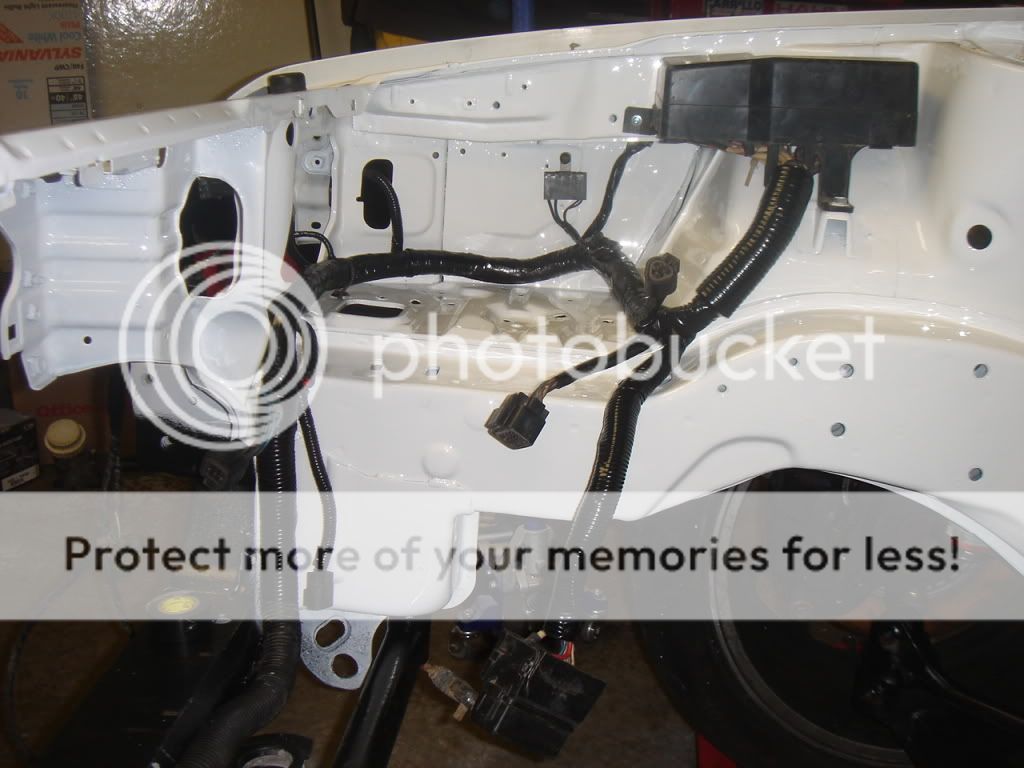

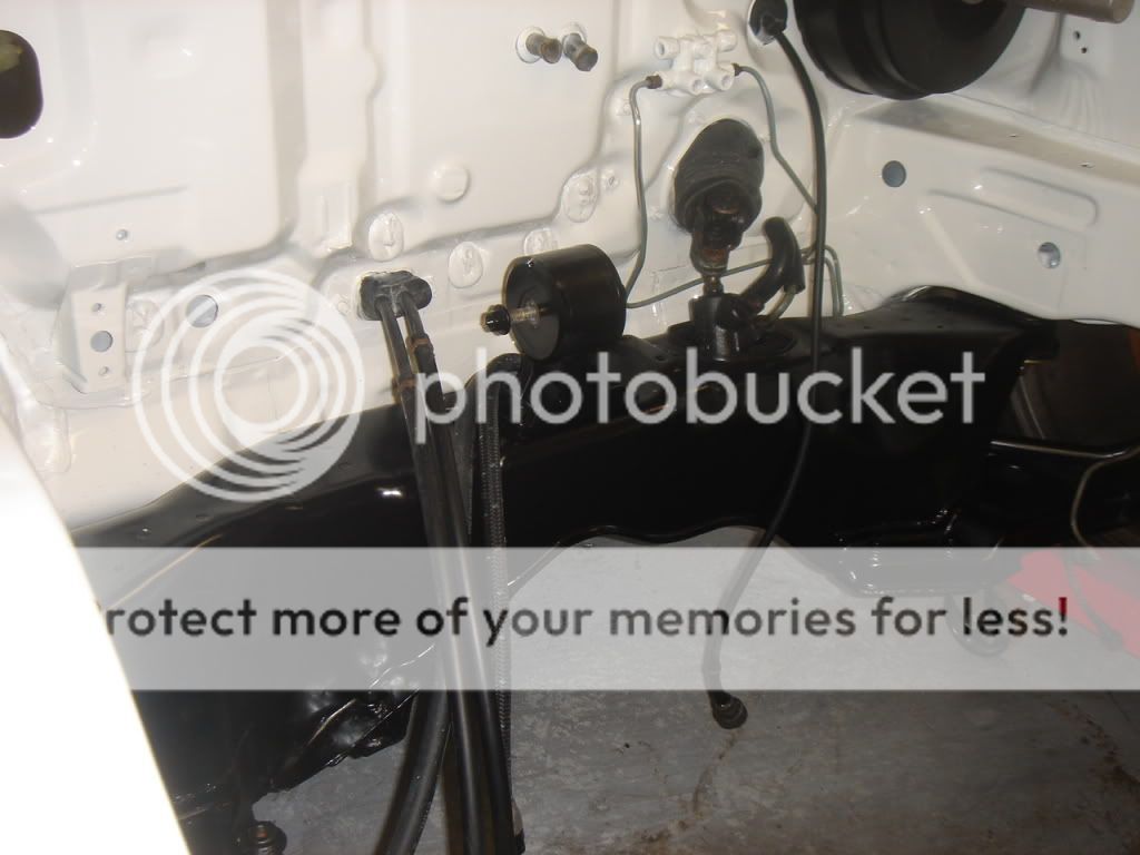

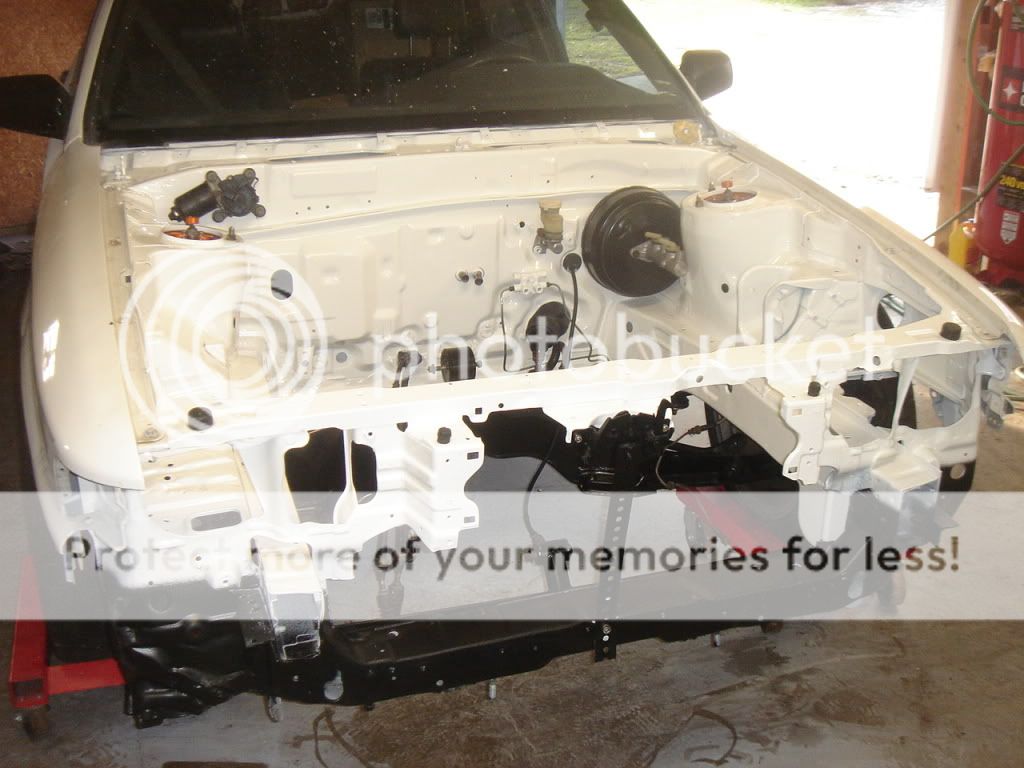

Time for some updates! So.... the subframe is back in, after a fresh coat of semi gloss black paint of course. I got the brake booster back in and some other things ran. Most importantly, the wiring came today! I got the wiring for the galant finally. Tonight, I got the chassis harness pretty much done. I am still waiting on my little zip-tie push clip things to hold the harness down to the core support, etc. But, so far, so good! Its looking pretty good. IM gonna wait to put the engine harness in after the motor is set in place, sometime next week.

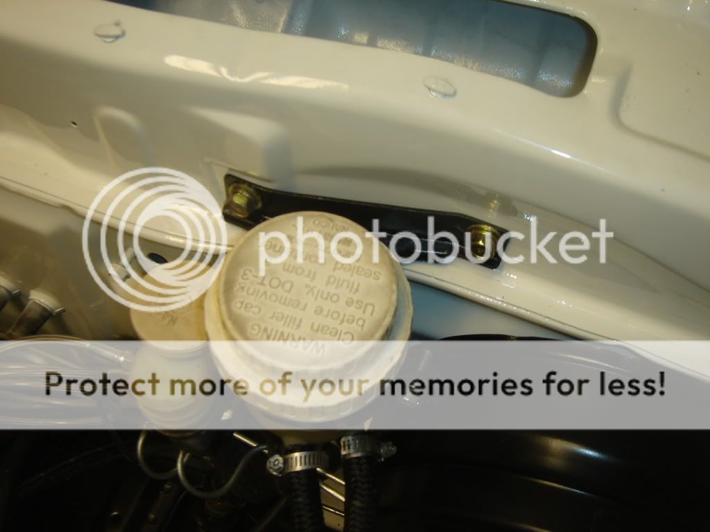

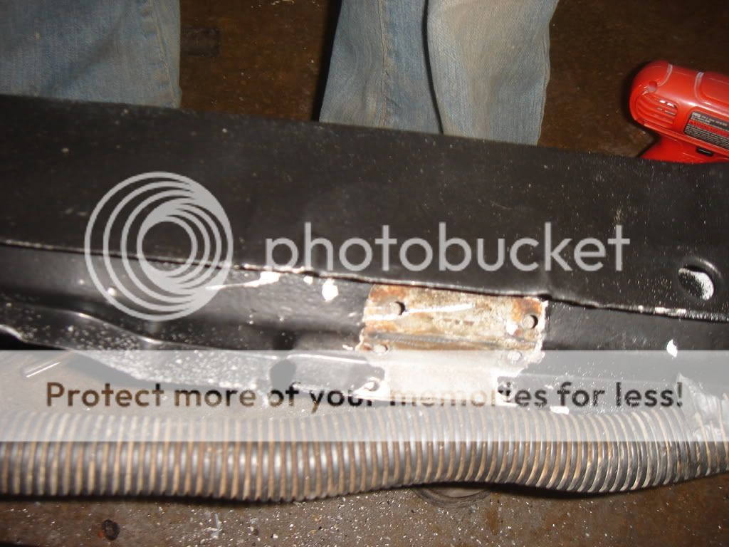

For those of you wondering about the black on the bottom half of the core support. I painted that with the truck bed coating stuff. I learned from my qg build, that a white bottom core support, just sucks to keep look nice. It gets chipped from fmic installs, removing bumpers, rocks etc. So I sprayed this on, which I dont think looks bad at all, and will help hide all the chip and whatnot.

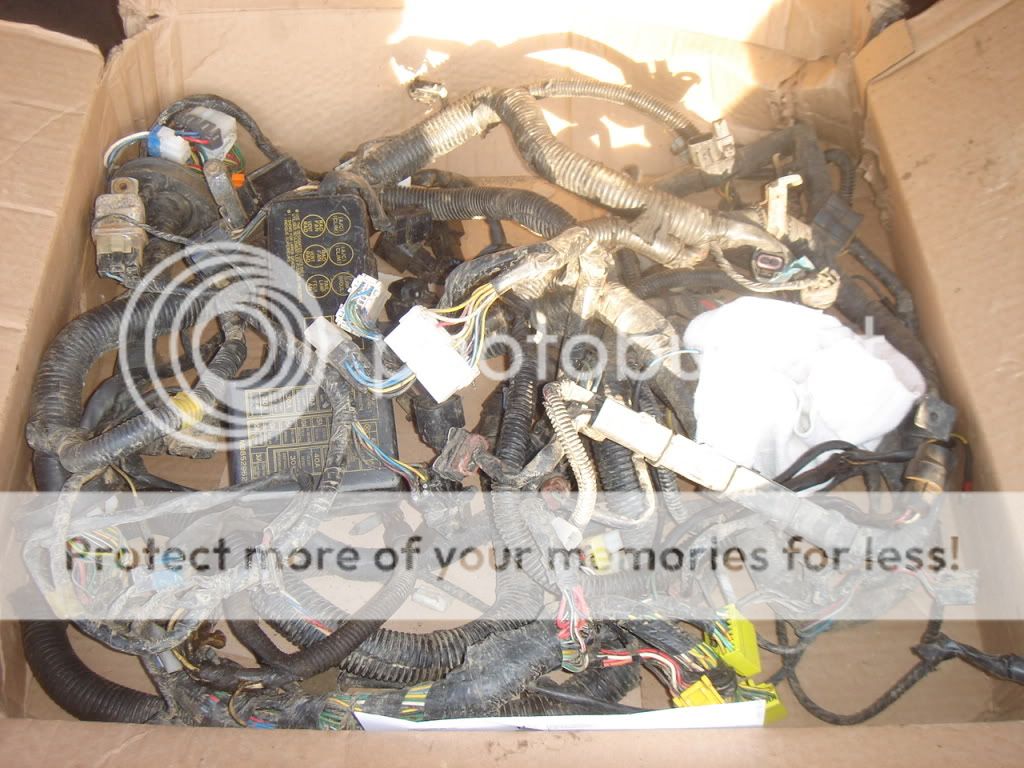

$200 worth of harness! lol

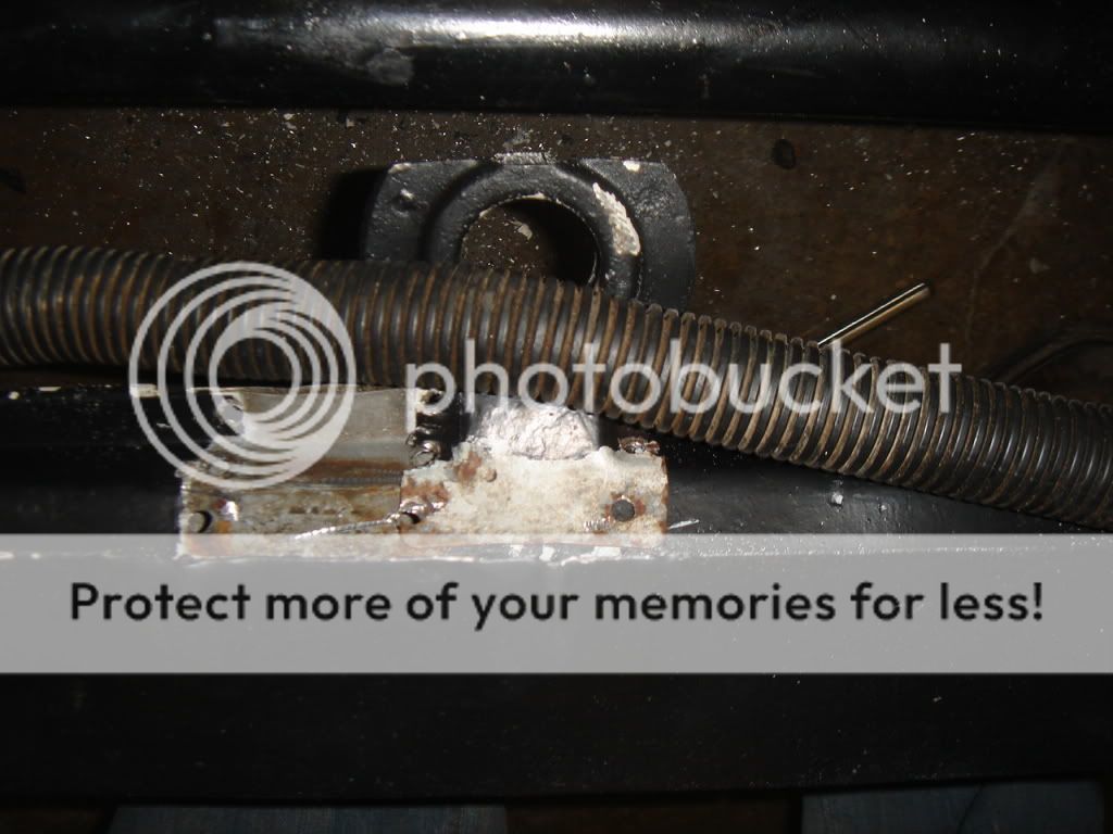

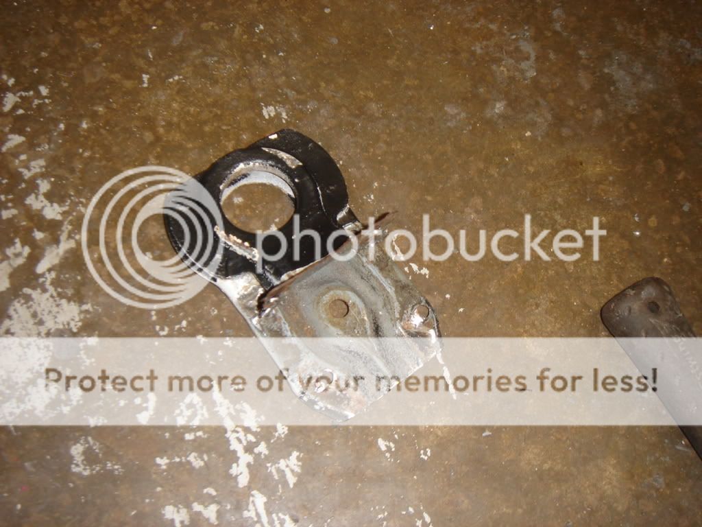

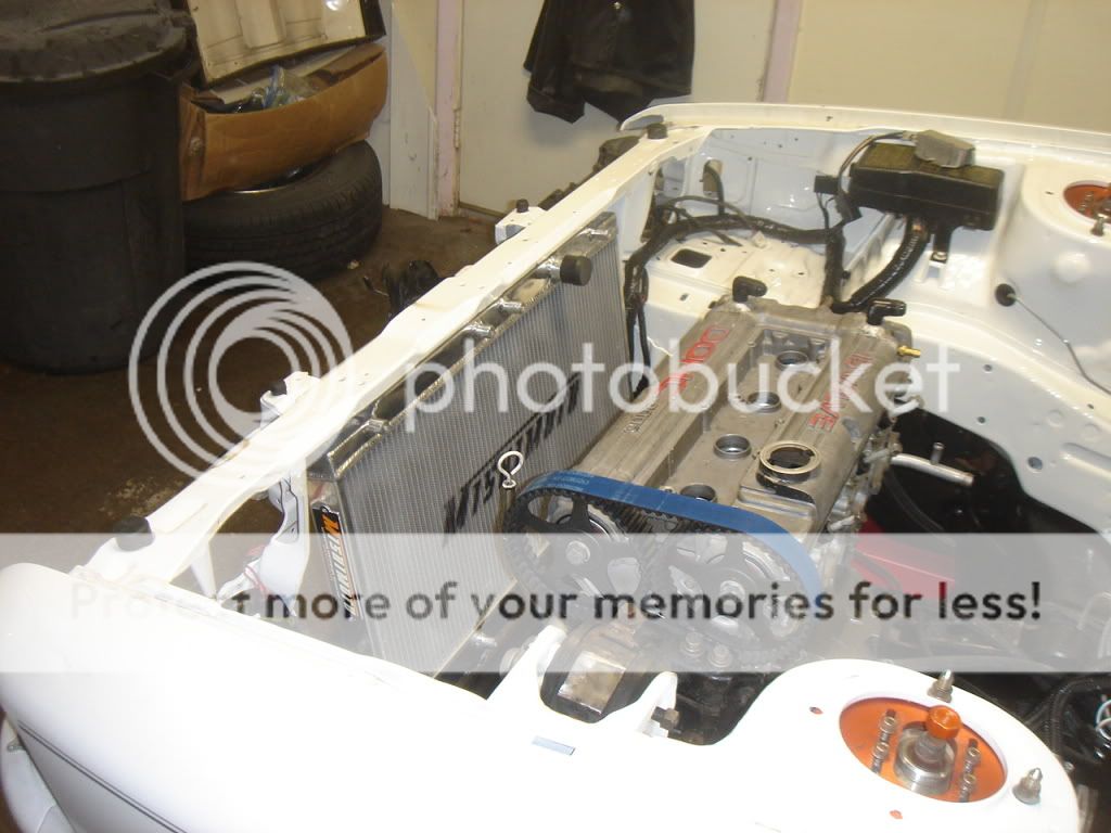

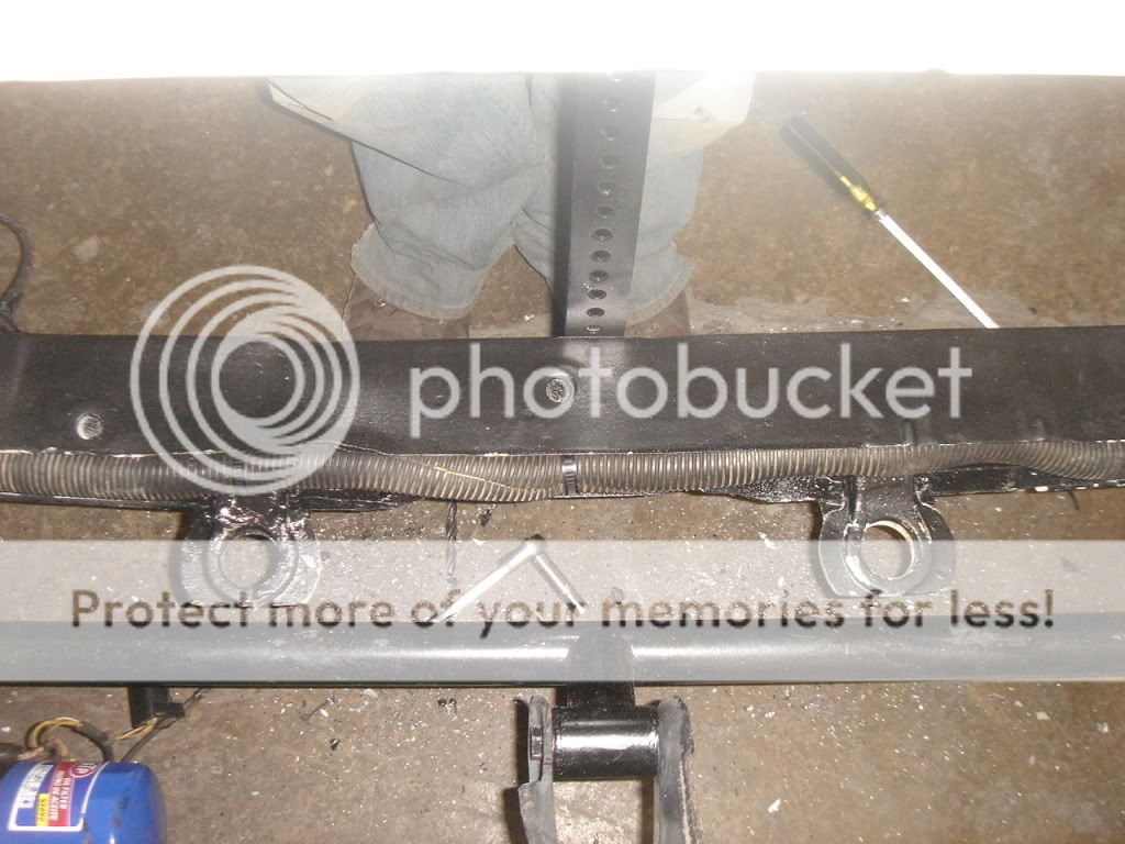

Got some more done. I am kinda at a standstill until I get more parts. I got a 1g mishimoto radiator. Well, when it sits in the lower radiator mounts, obviously its, not perfectly centered. Well, I want to keep this buschur short route intercooler on, so i had to remove the old radiator mounts and move them over just about an inch.
Finished!
1g mishimoto, perfectly centered!

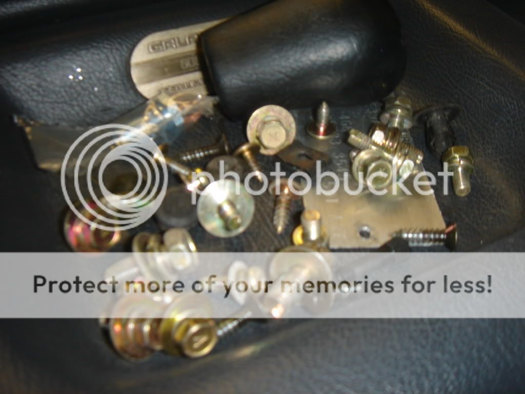

I went to the local scrapyard on yesterday. I was hoping to find some 93 headlights. I was not so lucky, /ubbthreads/images/graemlins/frown.gif I did find the much needed positive battery harness that I needed. I also got a new hood release cable too. I want the engine bay to be super clean. For that, I need all the gold/zinc colored bolts like they were new. Perfect place to find these bolts? Under the dash of all the mitsu's. No matter how old they are, the bolts and nuts under there are all still that nice gold color! So I scrounged as many as I could yesterday. I would have gotten more, but I got to the yard an hr before they closed.
