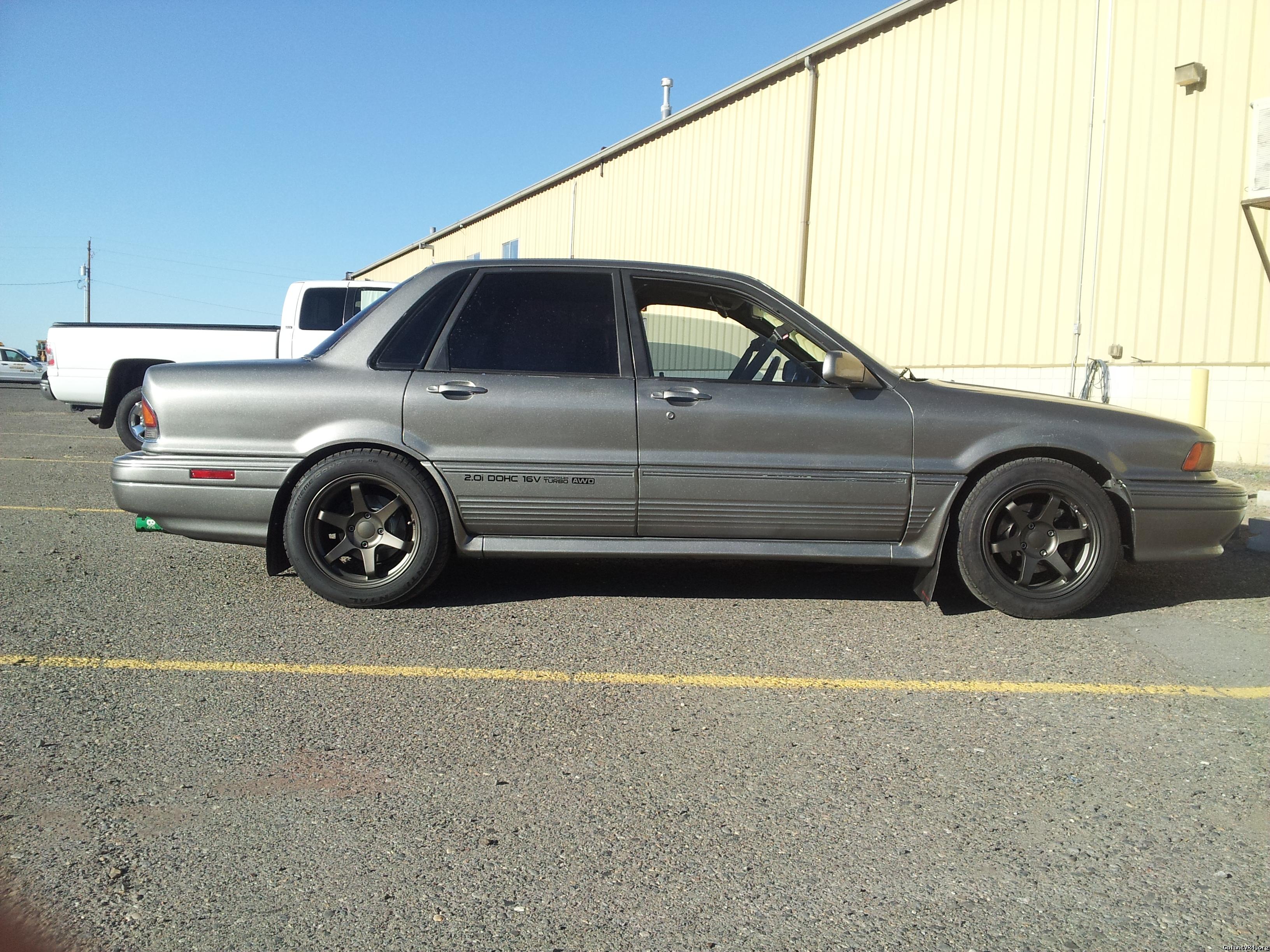

I have Robispec springs on the front, stock evo se springs in the rear. It's about a 1.2" drop. No pics now, but I think the front is still a tad high. It might be the upper camber plates, but I wish it was lower. Problem is that the evo struts don't like going lower.
Still way way better than the cut springs.
