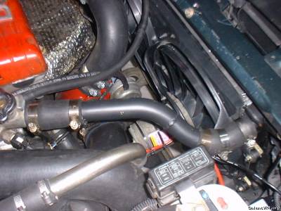

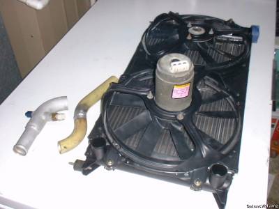

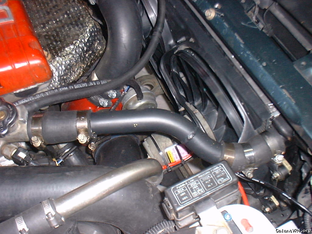

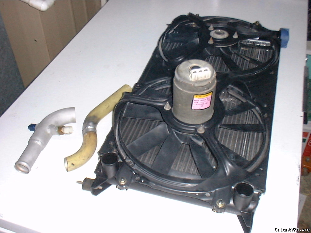

I'm running a sicrocco unit and a passat fan. Its a two speed belt driven unit. one motor two fans. You can feel the air blowing off of it at the back of the car.
The fan motor from a corrado can be used and its not so long but just as fast. The radiators can be bought at jegs for $100.
Its never gave me a problem and cools fine.

Also check for passat radiators and audi ones as well. I've seen passat complete units go for 200 or so on ebay not bad for a fan and radiator The passat ones are about 4 inches longer than the sicrocco. They still fit the galant but not with the 3 inch short route piping I wanted.

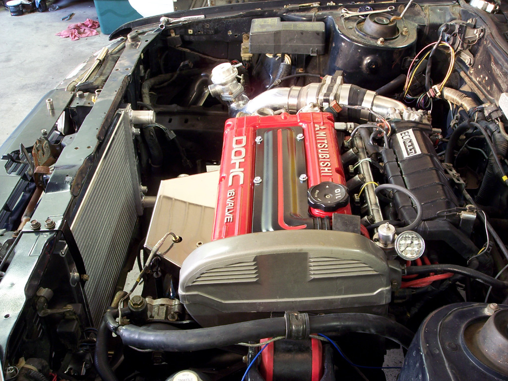

I LOVE how the radiator sits in where the condenser was. That must free up a bunch of space.
iLLeffeKt vr-4
Jul 26, 2004
2,153
NYC
integra is full size...not half.
Why? Might as well use the OEM VR-4 radiator /ubbthreads/images/graemlins/dunno.gif
