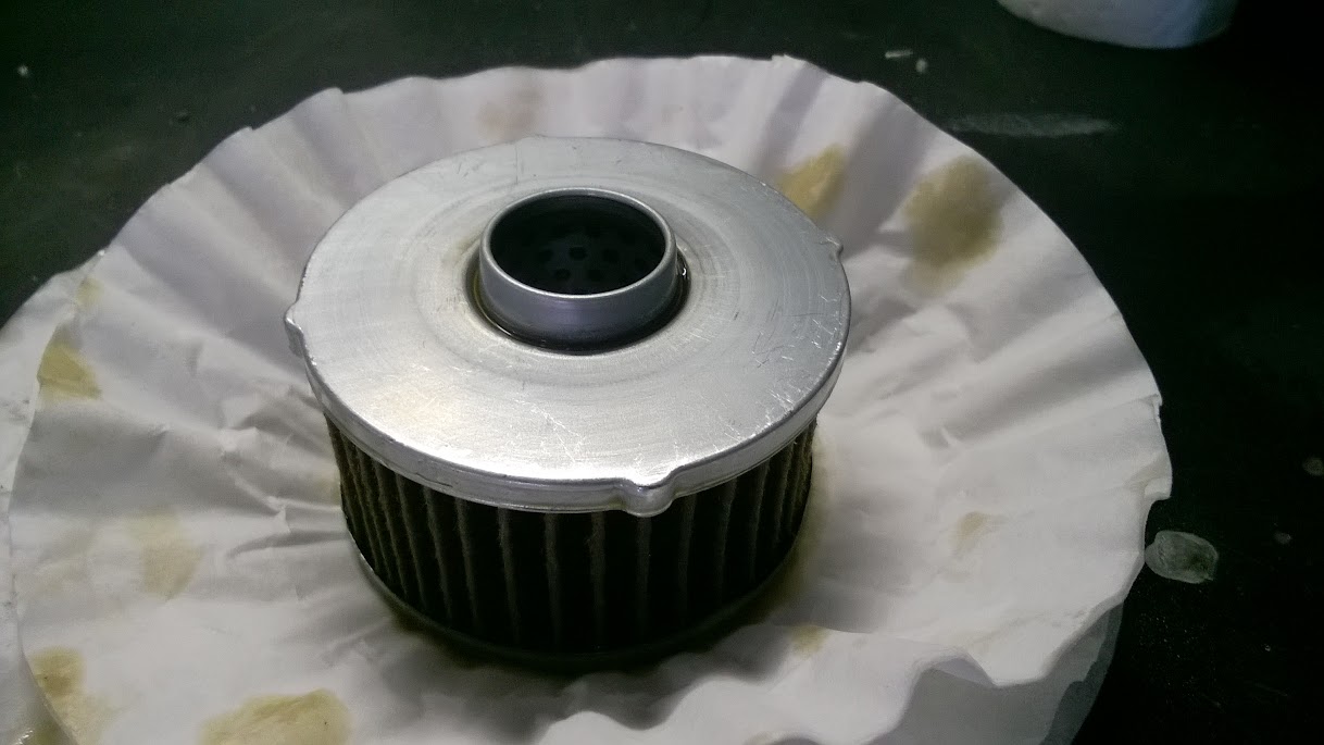

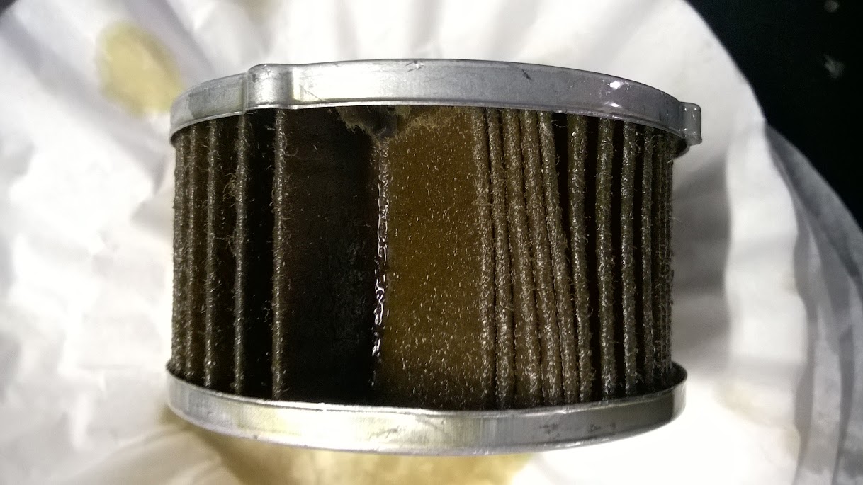

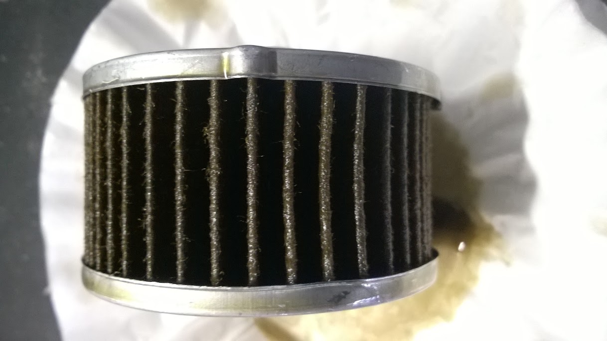

The second, and far more annoying issue is the DSS driveshaft. The DSS driveshafts are NOT for street cars, IMO. The driveshaft is noisy, and amplifies every noise in the driveline. It also seems to create some sort of weird harmonic noise on decel, which is horribly annoying. I've done hours and hours of testing, troubleshooting, and diagnosing trying to pinpoint the source of the noise to no avail. No matter how much testing I do, I still only draw one conclusion; the issue is the DSS driveshaft is just a noisy POS. Additionally, my driveline was completely silent with the stock driveshaft, further reinforcing the problem being the DSS shaft itself. I suppose I should have considered how a giant piece of 3.5" hollow aluminum tubing would act compared to the stock driveshaft, but I didn't. The moral of the story is don't put a DSS driveshaft on your Galant if you enjoy listening to smooth Jazz on your commute to work...You won't enjoy the experience.
After I got the car home I gave it a good wash, and figured I'd change the oil. It was far before it was due, but I wanted to pull the filter and chop it open to inspect after the long drive. Zero metal, and really zero contaminates overall. The filter element was spotless:

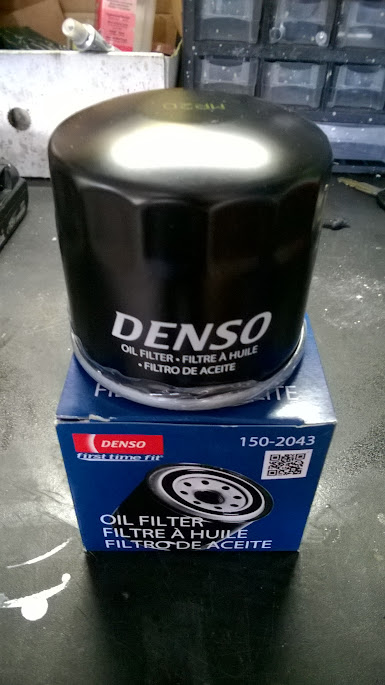

Lastly, a picture of my new filter for G /ubbthreads/images/graemlins/rofl.gif
