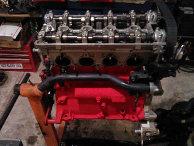

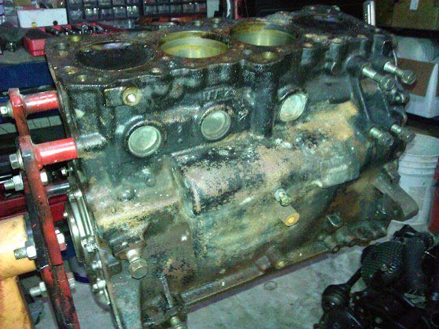

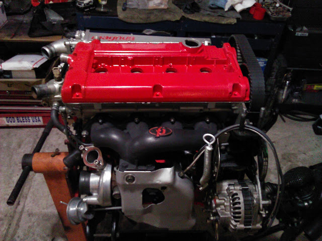

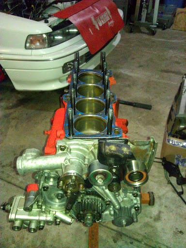

Long story short, I pulled the built motor out and am replacing it with my rebuilt stock short block for the time being. After considering my long and short term goals for the car, this is the best option for me. A stock bottom end will get me to where I want to be short term, while enabling me to make some improvements to my other motor eventually allowing me to meet my long term goals.
Motor out:

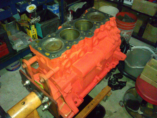

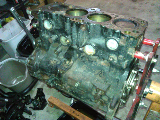

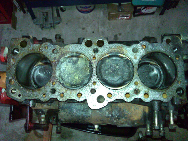

Nasty short block:

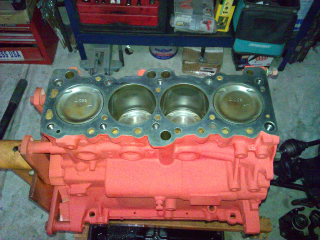

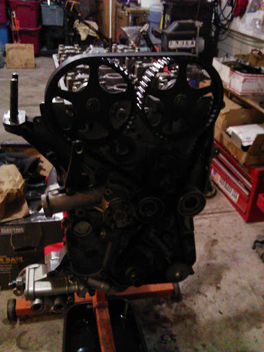

Clean short block:

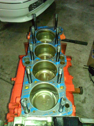

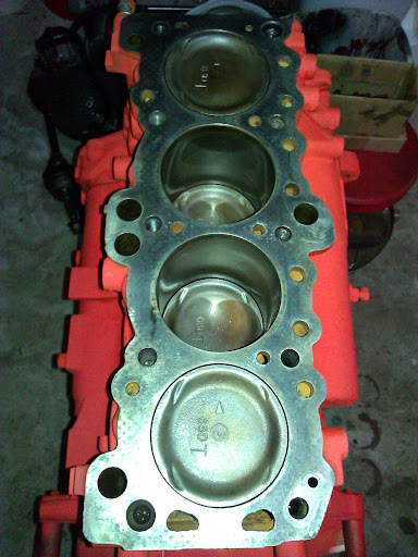

New Fel-Pro HG & ARP studs:

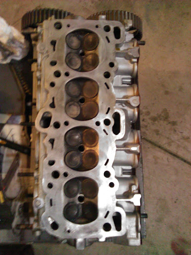

Cleaned up the head:
Head bolted up:

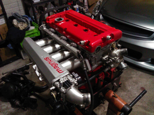

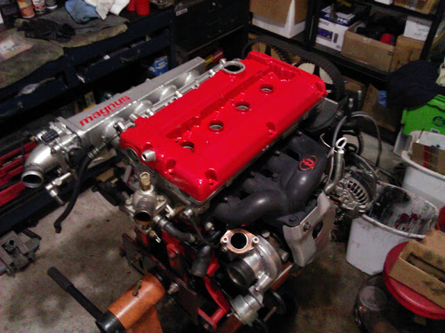

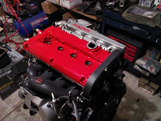

Long block mostly assembled with the -10 AN valve cover for the new catch can setup:

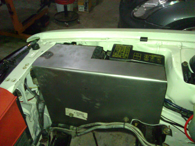

Got jelly of 15psi88's sweet cover, so here's my lesser attempt at my own version. It still needs the finishing touches, but you get the idea.

what paint did you use on the block? and what is that cover for really?
nicely done though, your work is always super clean
3,479
I painted the block with VHT FlameProof. Its not actually a "wrinkle" finish, it just dries as a dull red (or whatever color you have), which I actually kind of like. With the FlameProof paint, you can bake the part after it is coated, and I've found it's damn near as durable as powdercoating. I coated the FP manifold in the same stuff, and it holds up great even under extreme heat.

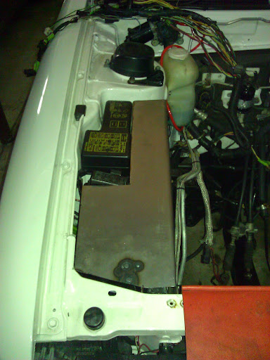

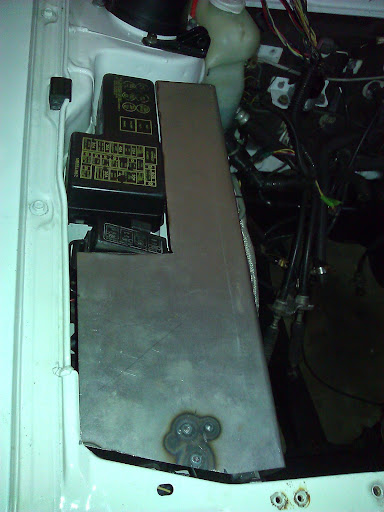

The cover is my half-assed solution to doing a full wire tuck. I hated how the body harness and fuse box/fuse box wiring looks in that area of the car. I started to pull the harness and relocate it in the body, then decided against it. After the cover is done, it should neatly hide everything while giving the bay an overall cleaner look. I'm trying to decide if I want to paint it white to match the car, or black to offset all the white that's already in the engine compartment. The edges of the cover will be covered with some flexible trim.
I've always found the little details always add up to a good look overall, so that's what I'm concentrating on this time around. The goal is a clean looking engine bay that's still functional. I don't want to pull half of my car apart just to trace a wire or check some fuses, but also don't want it looking like a cluttered mess. Finding that happy medium has been more difficult than I anticipated.

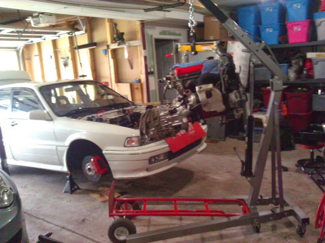

Motor ready to go in:
Flywheel was resurfaced by Jackson Auto Machine (JAM). They did an amazing job! The pictures speak for themselves.
Flywheel, PP, and trans bolted up:
Motor dropped in:

Anywho, Brett I just noticed your use of the dolly and have to say that's clever.
