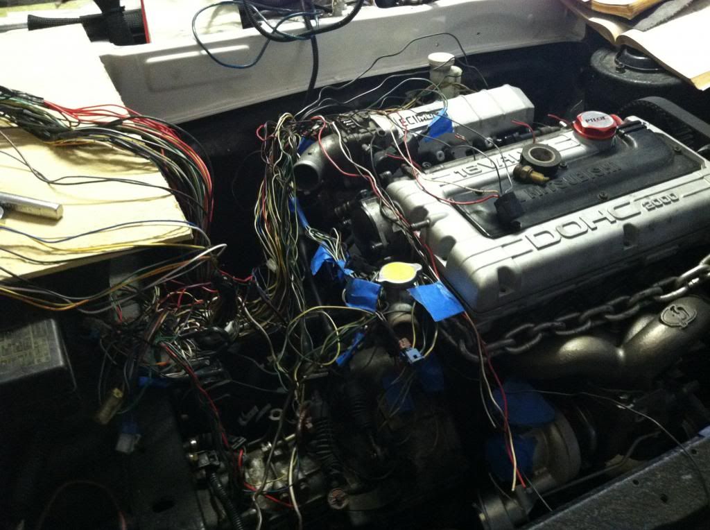

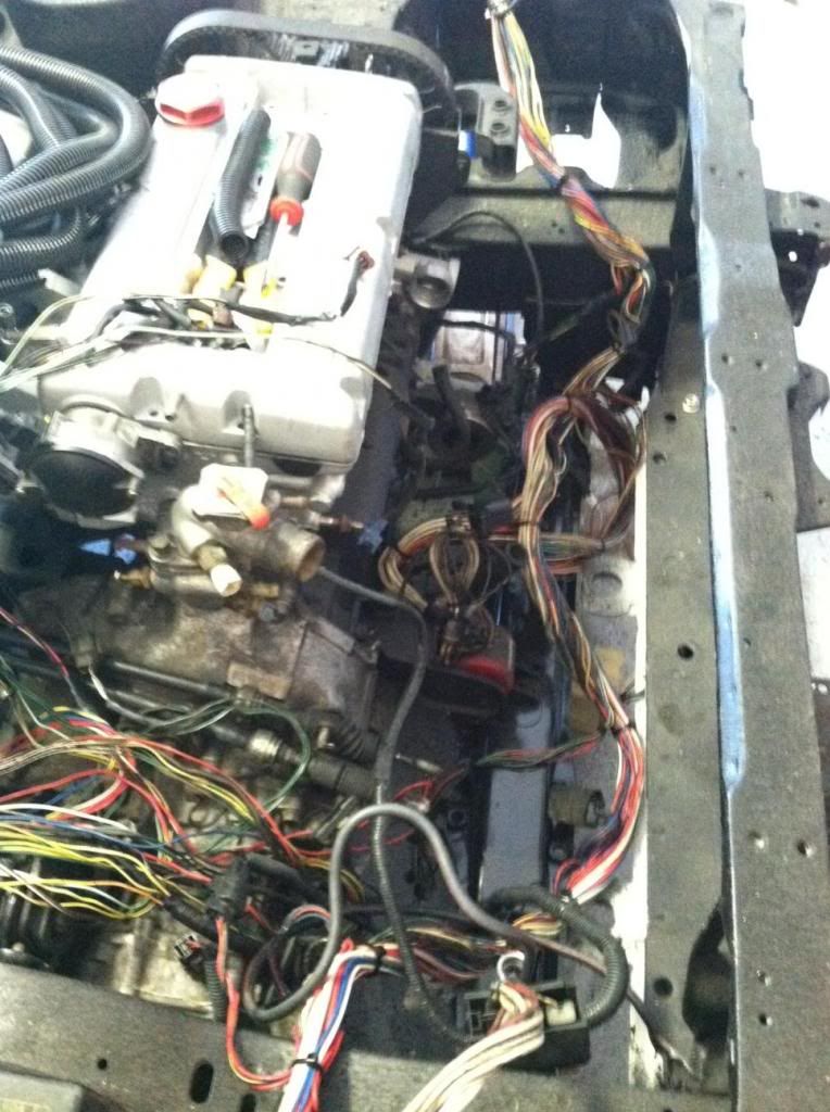

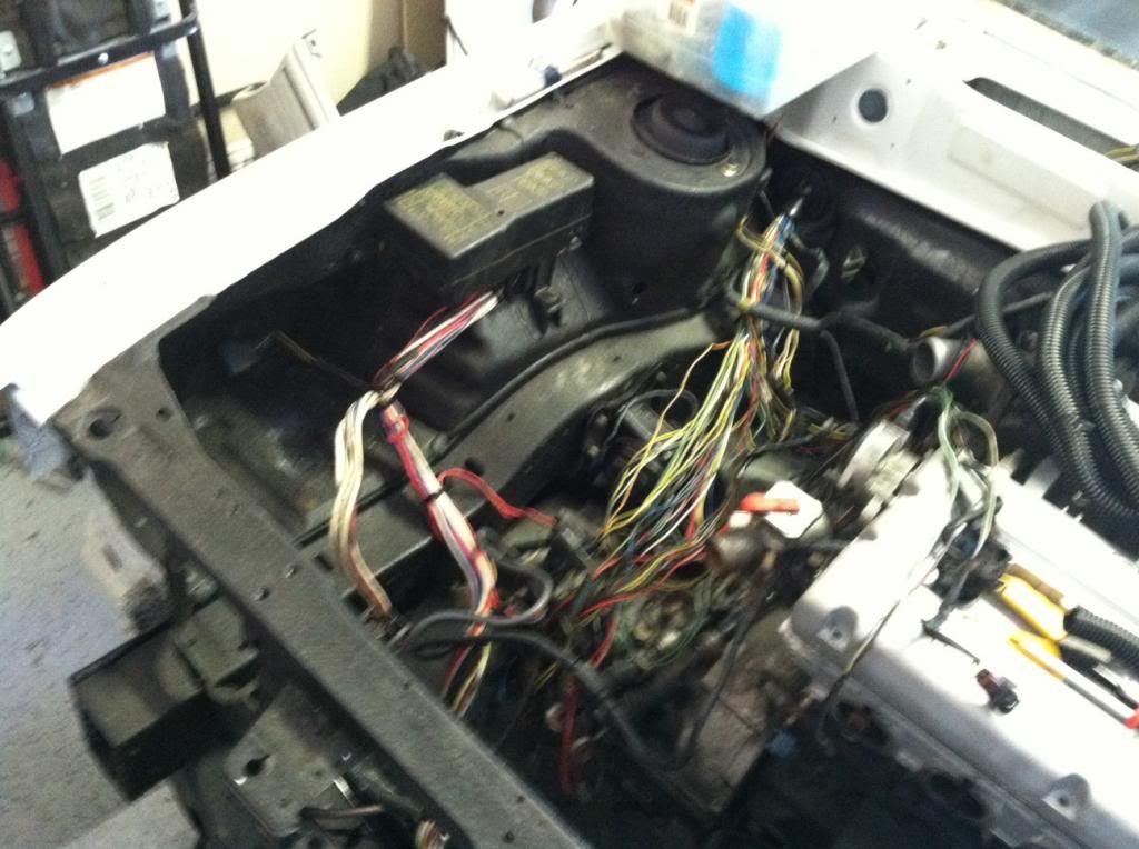

Some more pics of the current progress, this harness issue is a mess....

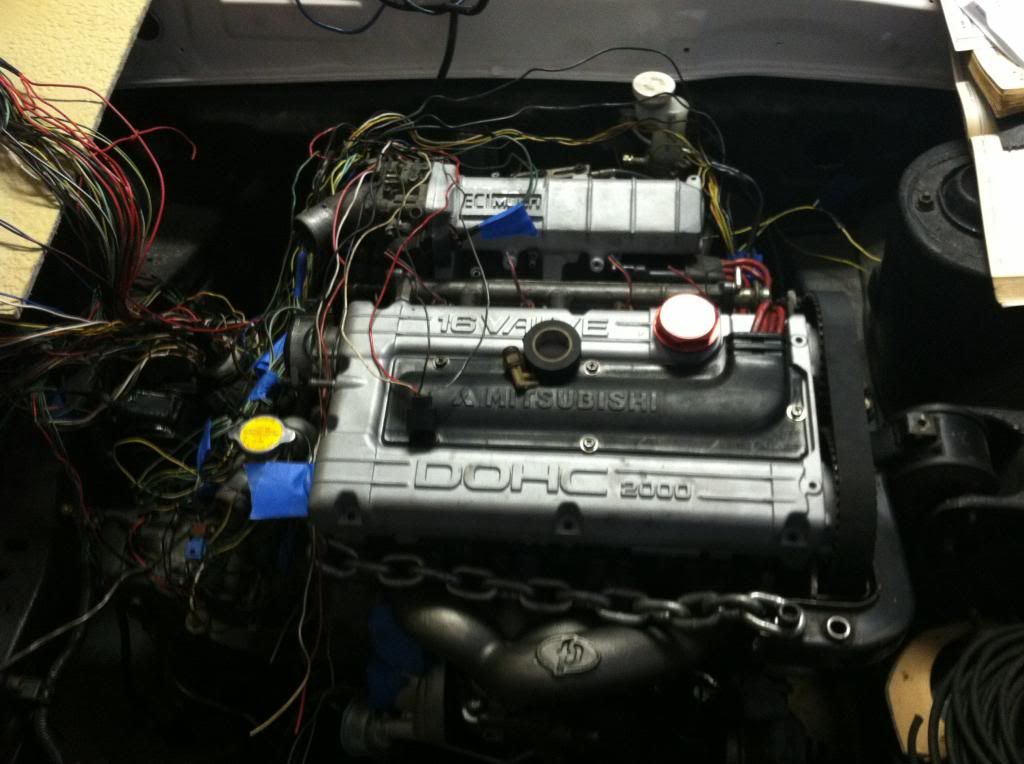

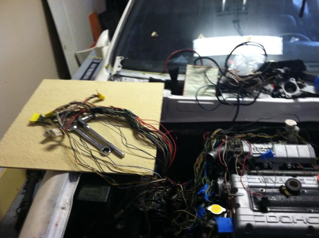

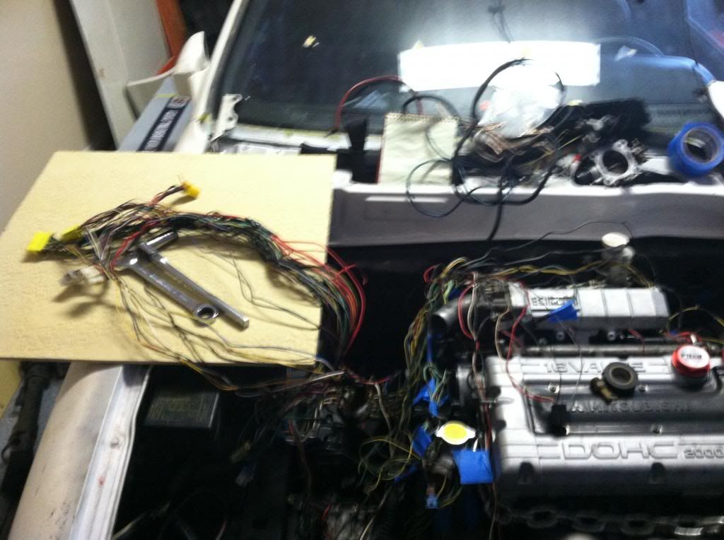

We are using a 6 bolt DSM harness, as the stock harness was hacked beyond belief and the further we peeled it back the worse it was.
There are more then a few differences in the harnesses , mostly where it plugs into the dash section.

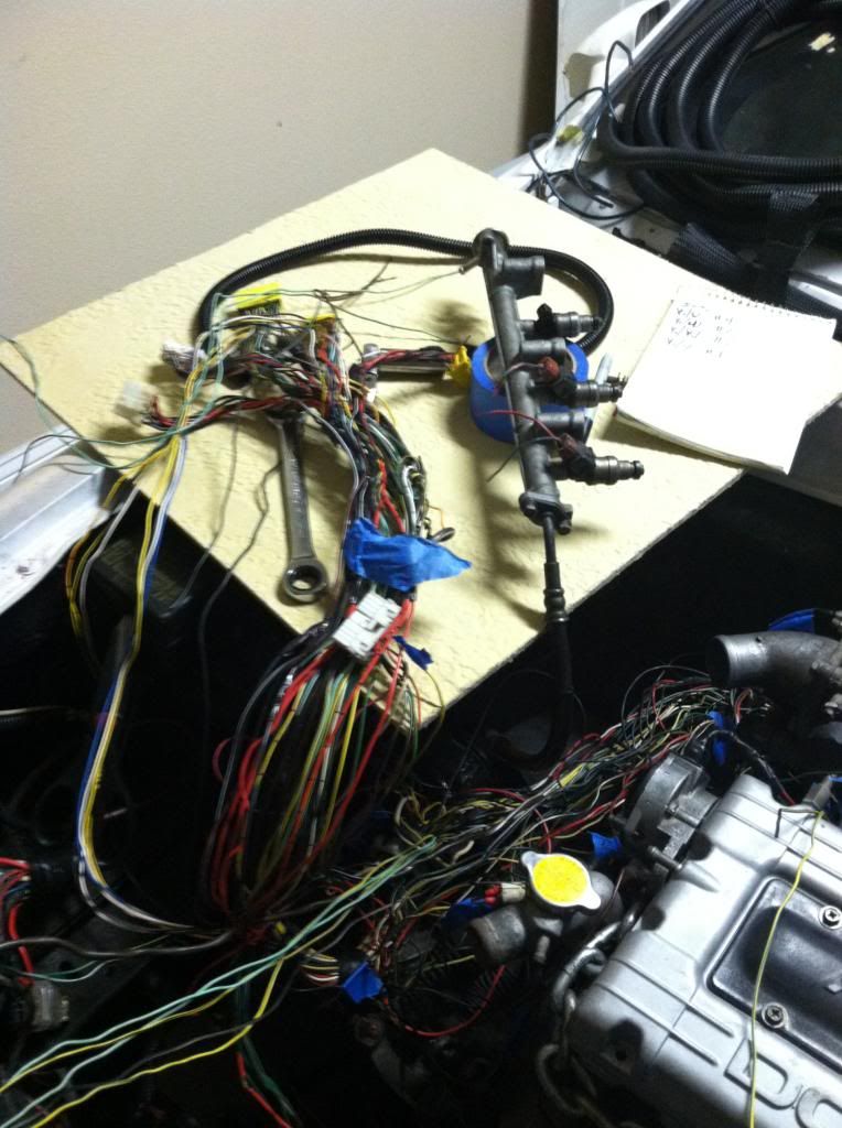

Some removal of the GVR4 connectors and re-pinning those sections of the DSM harness.

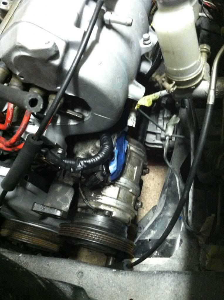

Its going along pretty good, we are keeping the AC, removing ABS and cruise only.
Its a mess though....lol

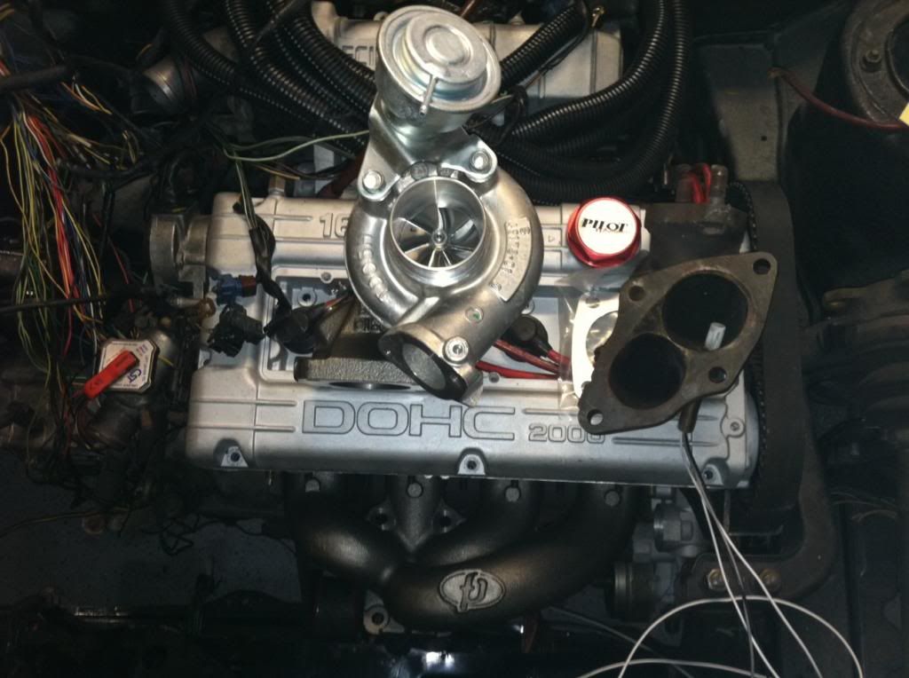

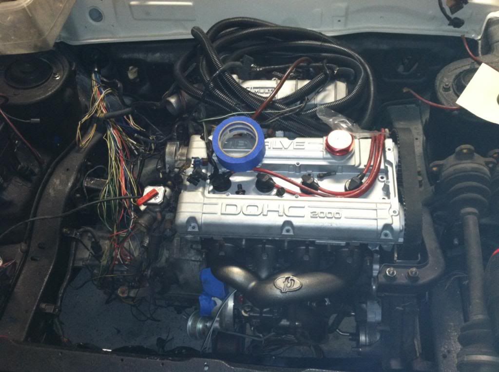

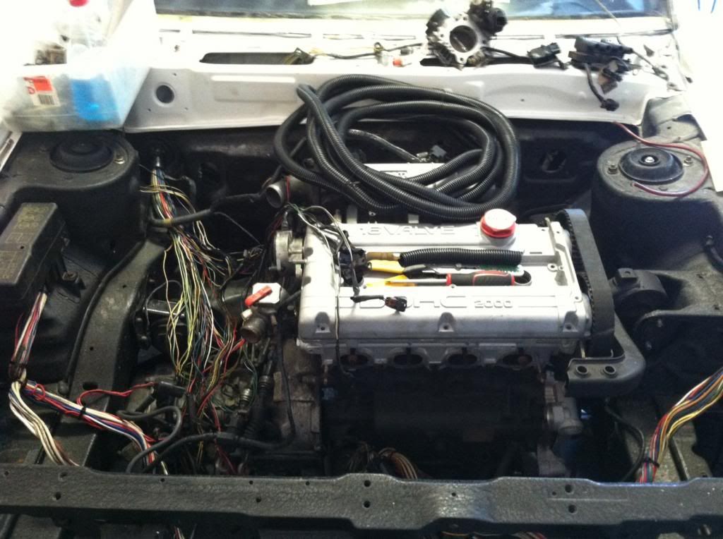

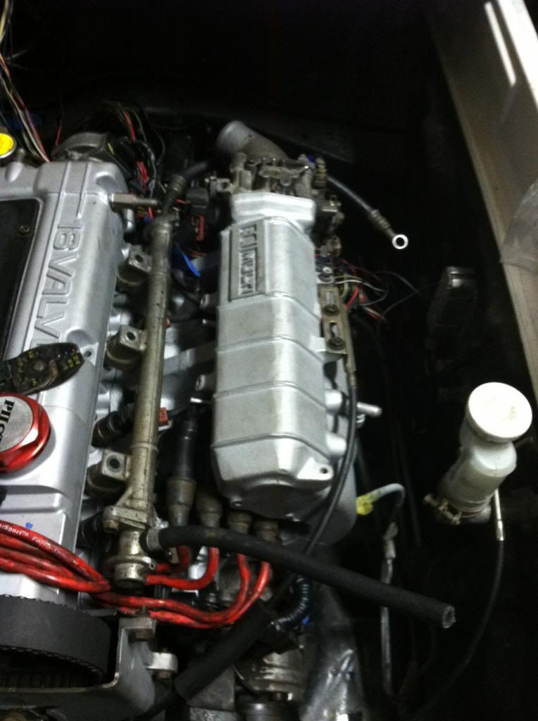

Here is where we stand,at the mock up stage.

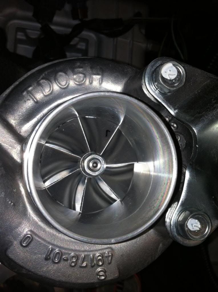

Lookie at what I broke out of the box.....hehe

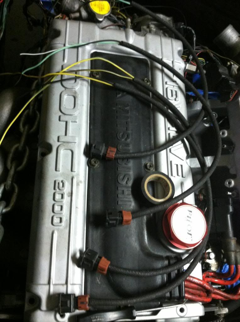

Some updated pics/progress from today to keep the internets happy /ubbthreads/images/graemlins/smile.gif

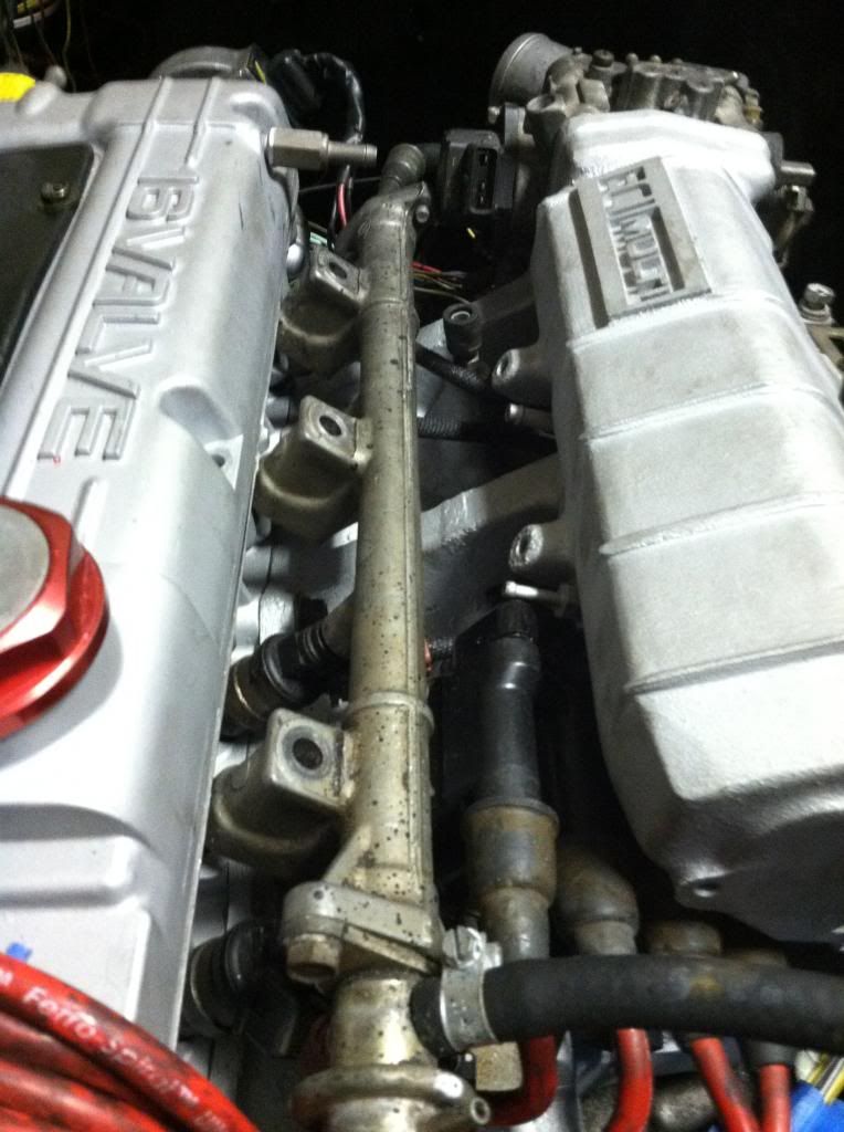

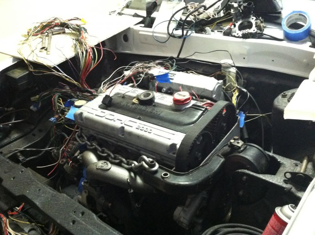

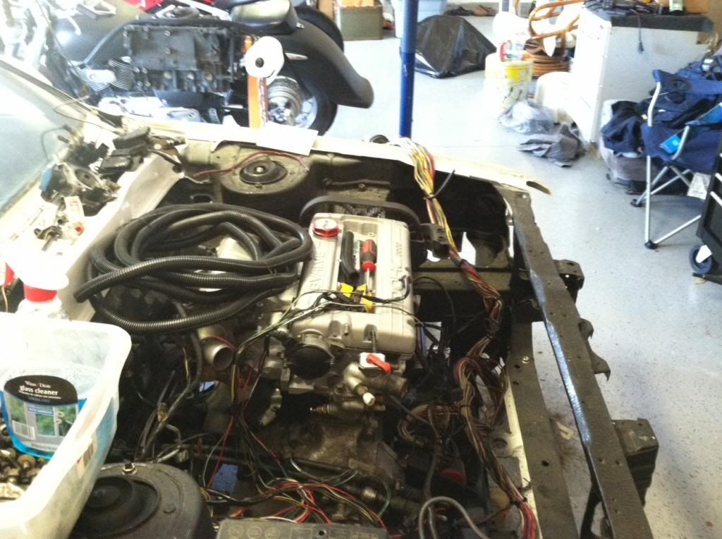

Where I started out this afternoon,

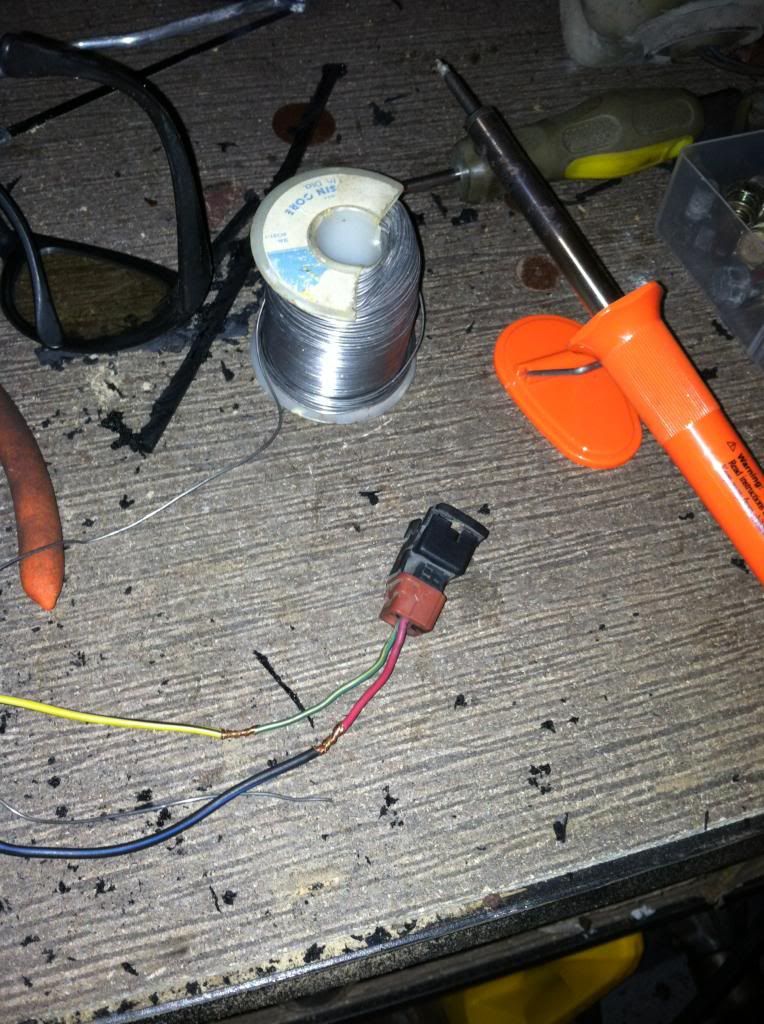

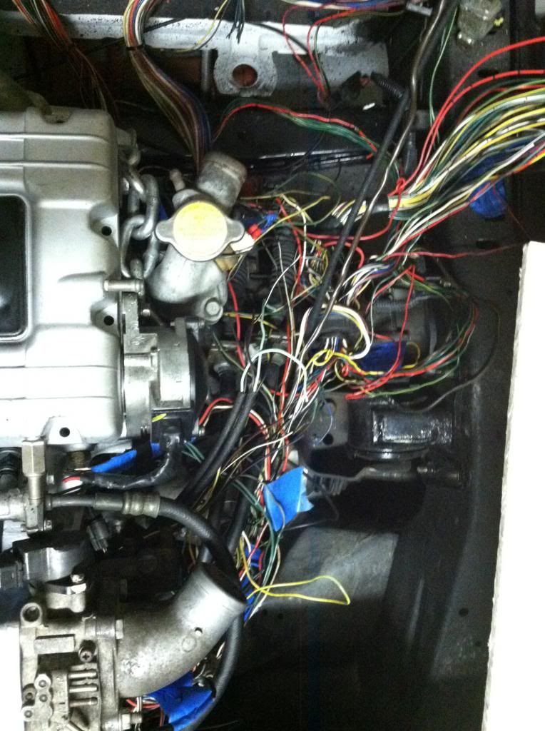

What I was working on today, Installing new injector clips and starting the wire tuck now that I have the harness cleaned up... despite what the pics show...lol

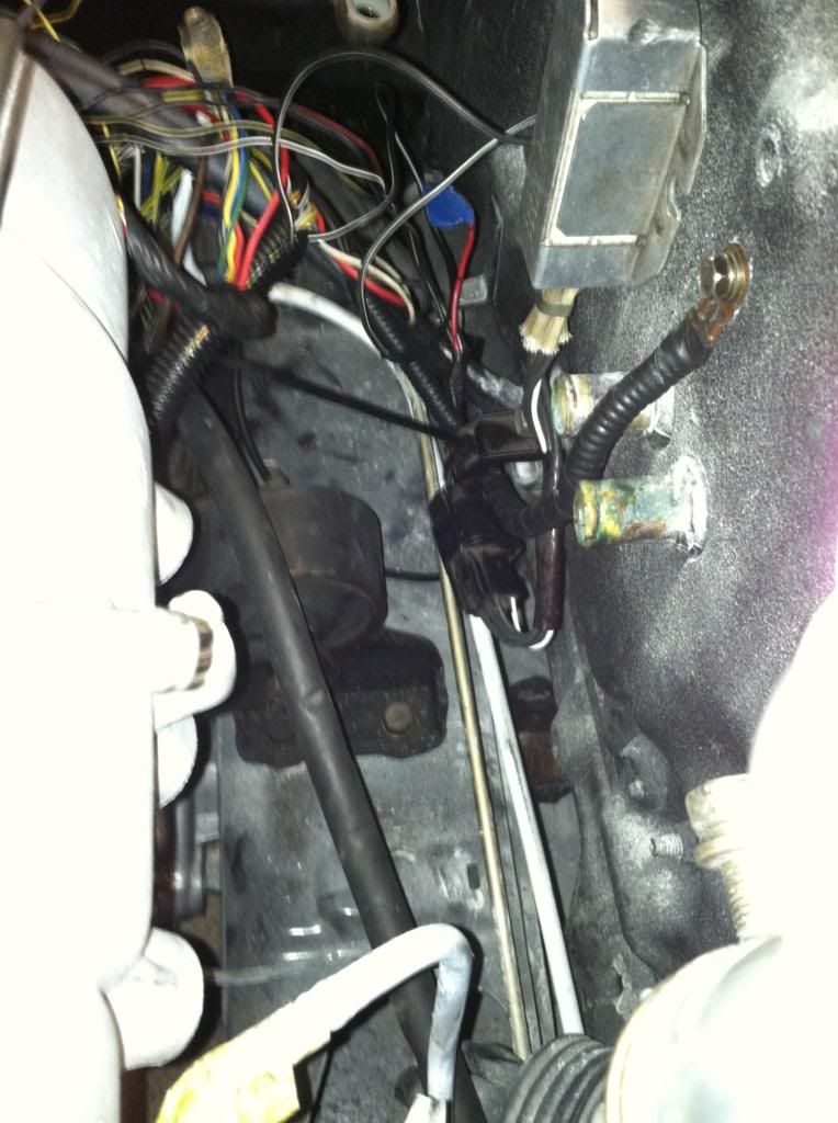

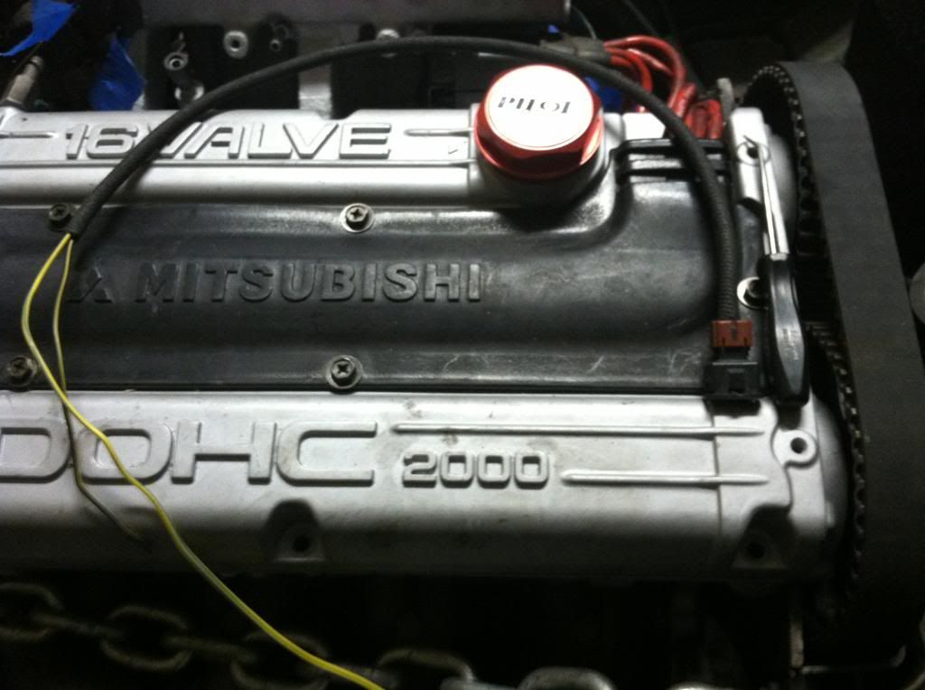

Tucked in /ubbthreads/images/graemlins/smile.gif
Still a lot more to do, but its getting closer..
