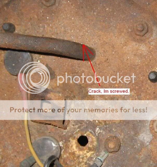

Well goddamn it.
Now what. It looks like I will have to replace the sender. Man what a let down.
I started it up and I was happy, went back to look and there was gas streaming down from under the car. I was praying it was just something that was not connected right and it turned out the pipe was cracked. sh*t!

aw, that sucks man...i was hoping all was well....you can mod it like the directions abouve, or if you order one from the dealer, they are quite pricey, and i think you have to get the stock pump with it as well. i don't remember if they are still available, so keep us posted. good luck!!

Ugg, I was wondering if there was a chance they wouldnt even be able to get a new unit. I dont think it matters though, if I heard right they are almost $500 for the assembly with the pump attached (cant get it w/o a stock pump) and I dont think I can drop that cash atm.
I will keep you posted, I tried calling already but nothing is open yet. Also the only assembly that will work is for a VR4 or GSX? Or would a FWD galant have the same setup?
Lol, well Im not too optimistic that its the right part but I think they ordered me just the sender (local mitsu dealer). They said it should be here tomorrow.
The first thing he said was "ack" and my heart sank... said it was $610. But then he said wait thats the tank, pump, and sender. A second later he said "nice how does $63 sound". I was like hell yeah!

It won't be. Probably the float arm assembly, as the only other component parts available are the gasket and the filter sock, neither of which should be anywhere close to that price.
Well we are right its not the correct part. I called him back and confirmed its just the float assembly for the fuel gauge. The whole pump assembly is the only way you can purchase this part.
Wow thats horrible. $610 is the number.
*edit: the part number is MB831333

+1 i believe you can remove the tube in question, and wld in a -6 an port to tie into the hard line, i think you need an elbow as well, but that would be it....was the link above what showed that?? i know you can only get the sending unit with the pump etc. i ran into the same issue, but was lucky enough to get a new SS unit from Dentsport. this was like 2 years ago though, i din't think they have them still...
