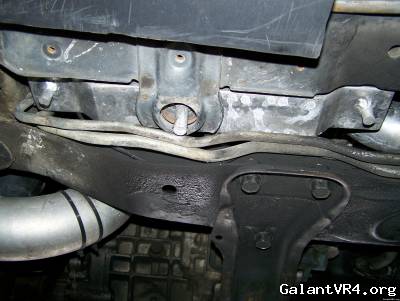

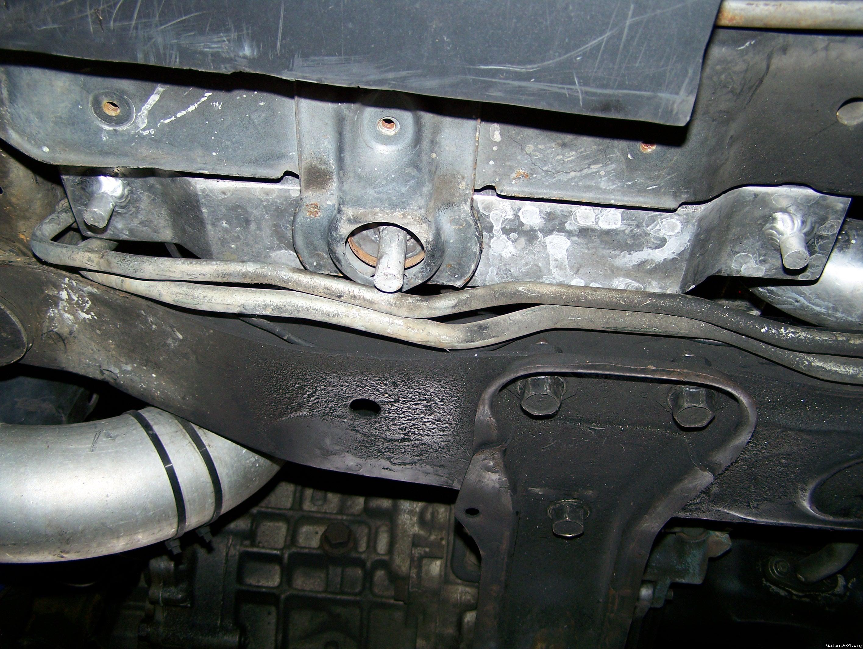

EDIT: Here's a picture of the aluminum stick welded to the bottom of the radiator to use the lower factory passenger side bracket.
