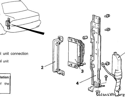

I don't want to ever use the ABS again; however, I'm actually prepping the car to sell and top priority is for it to pass inspection, so unplugging the control unit it is! Where in the trunk is that guy?
fastasleep
Jan 14, 2005
1,779
Christiansburg, VA
Hmmm, I guess I can't find it. I unplugged two things right around the antenna and the ABS light remained on. Anybody got a pic?

Pretty sure it has to. I'm not sure where else the CEL for ABS would possibly come from. In my '91 I know I don't have the ABS light on and I removed it all?

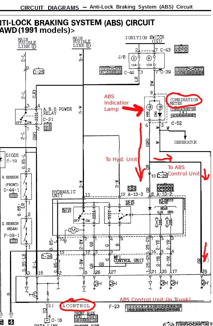

The ABS lamp in the gauge panel has 2 paths to ground, one through the Hydraulic unit (relays and such in the engine bay), and one through the ABS control unit (in the trunk):
Click image to see full size. Pardon the crude arrows... /ubbthreads/images/graemlins/hsugh.gif (This is the same for both 1991 and 1992, by the way)
If something goes wrong with either of these, the light comes on. Maybe removing one without the other causes a fault in the one not removed, and causes the light to illuminate? It is most certain that if both connections were removed, the light would not come on... seeing as there would be nothing to switch it on.
The connector numbers are listed in the diagram, but I'm pretty sure that you know which ones they are.
Hope this helps!
