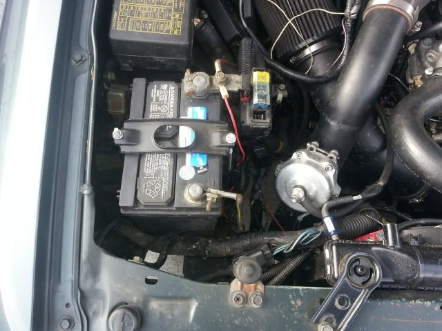

Please do, thanks! Have you had any issues with battery life, cold cranking?
its been in there since I bought the car...so 2 years? she cranks over a little slow when its 20° outside with 20w50 vr1 in there lol. but no issues to speak of. they say 340cca, mine tested 470cca when I bought it. haven't tested it since.

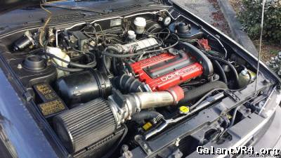

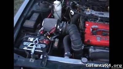

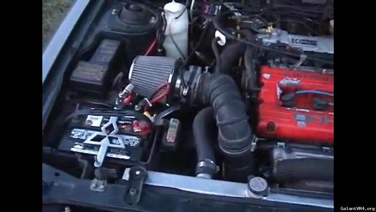

that looks like it would fit well, although I would be using my stock air can in that spot due to how my intake is designed, until I can run this GM MAF setup I have or 2g MAF or figure out some other way. I'd have to put the battery where the stock air can goes or back DSM style by the shock tower. That is definitely smaller than the stock battery though.

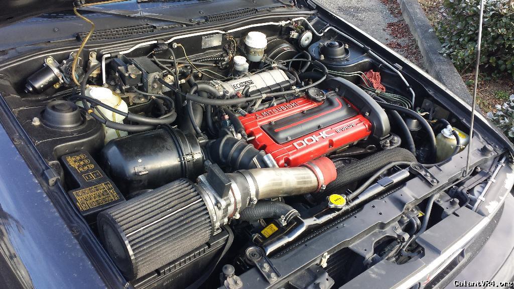

Here is the intake setup I have, complete with GM MAF. It leaves pretty much zero room in the stock battery location to put anything.

Do you have any recommendation on what I should do for the intake setup? I could just run the stock air can off that, I wish the MAF wasn't obnoxious and set up to have to be used in that thing, though. I would like to use this air filter, but not ready to set up GM MAF on my car.

move the maft to a blow threw when you do your intercooler pipes. that should give you some battery clearance. or just do an intake more like mine.

I could but not sure I want to run the GM MAF yet, I don't have a wideband or any way to tune it. It comes with a translator, I suppose I could set it to zero and run it that way. I just don't want to do wiringgggggg ugh /ubbthreads/images/graemlins/idea.gif

Why not just put in a 2G MAF? Grab a plug and play adapter harness from iceman ( click ) and you're done.
It would fit virtually the same as the GM setup you posted a picture of. It would flow better than the 1G MAF, and run better and take much less work to install than the GM MAF. Either way, there are many much better solutions than the GM MAF. I'd stay with the stock MAF before I'd use a GM MAFT.
3,479
I had a 2G MAF installed on 1813, and will install one on 1837 soon. It ran like stock with ECMlink. I used a plug and play adapter, Dejon intake pipe and 4" K&N filter. Keep in mind the setup will need to be recirculated, so plan for that. I had to rotate the intake pipe about 30 degrees for everything to line up good. With a little trial and error, you should have no problem getting your individual setup to fit. The battery will also have to be relocated before hand, obviously.
