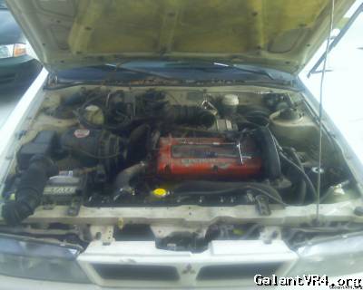

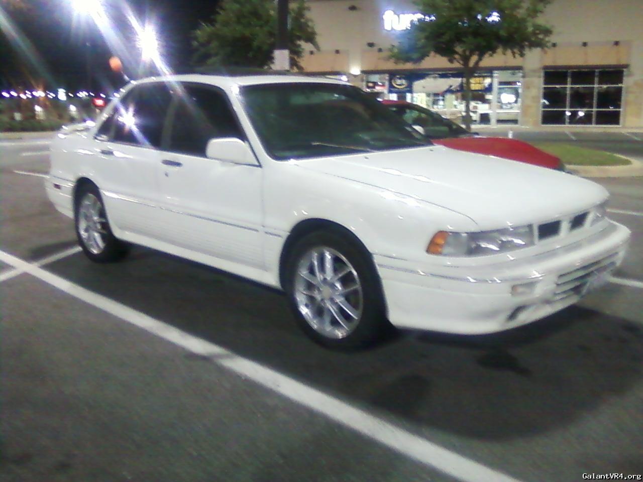

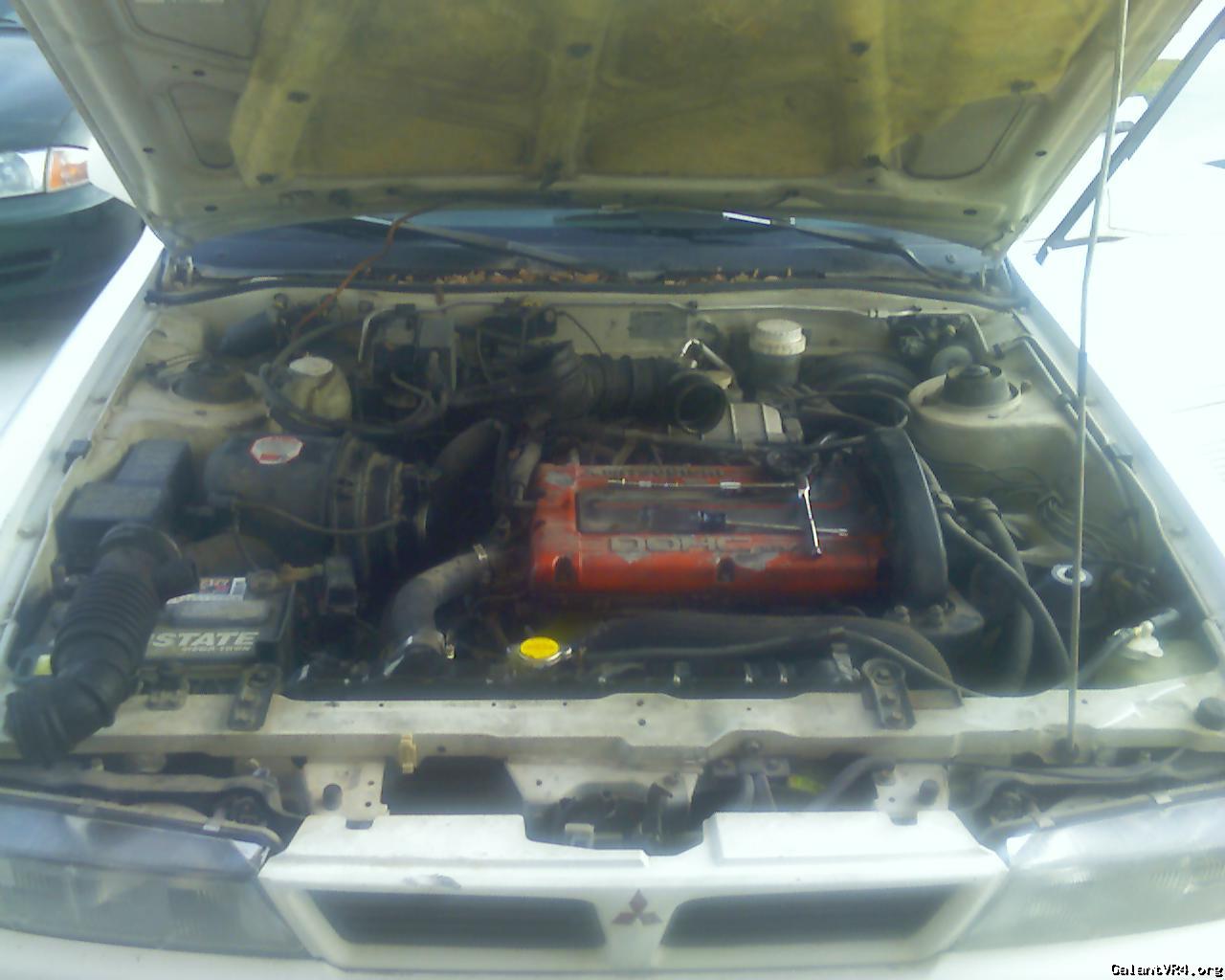

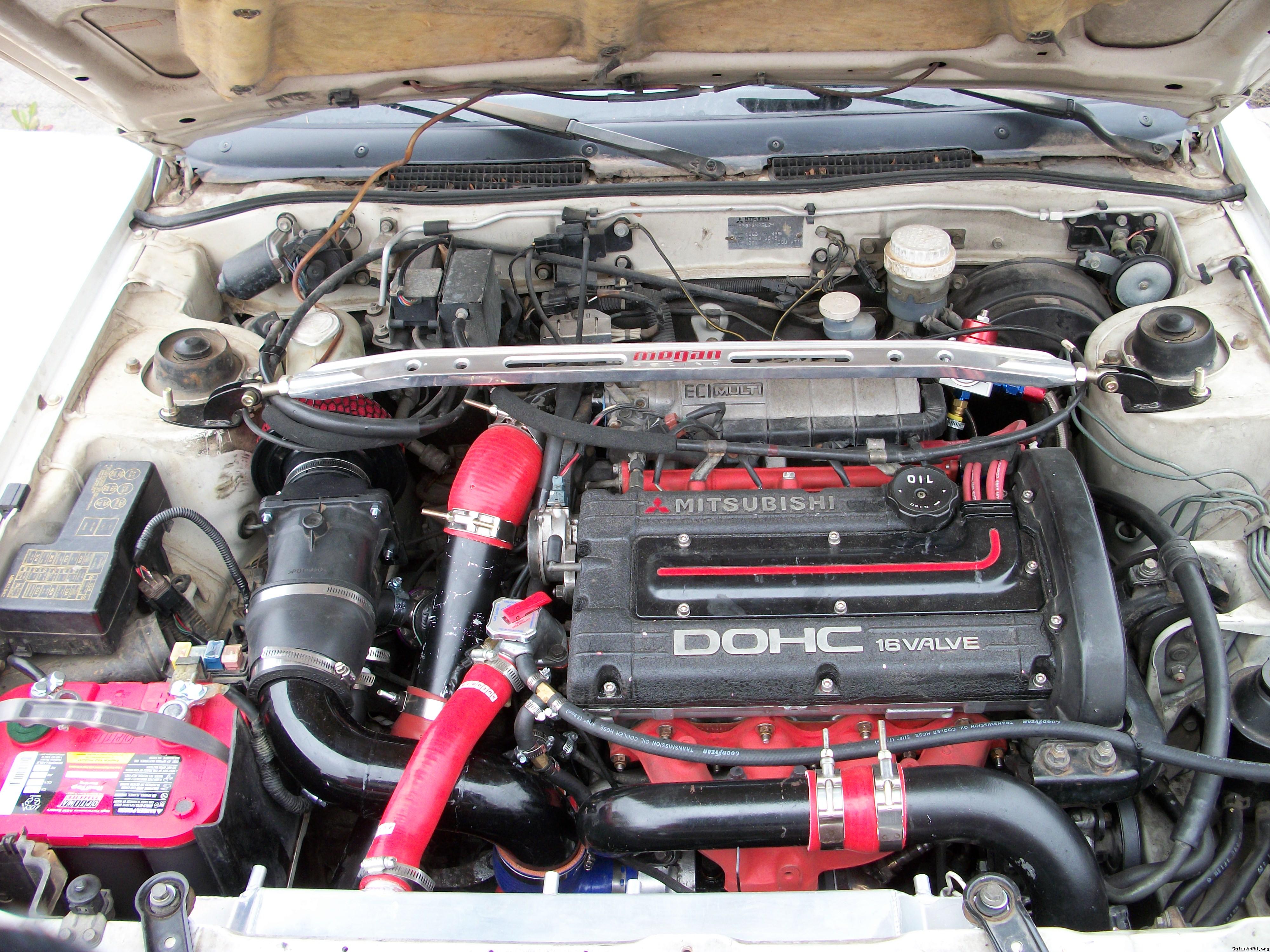

As I near completion of my current (and hopefully last for a while), I thought I'd reflect on what my Galant has become and how far it's come. I purchased Betty October 15, 2009 and drove her home from Round Rock, Tx with no boost and low compression and rotted tires. It was a great idea on my part. Of course I had no idea about the compression as this was my first project car. This is what I began with:

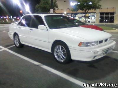

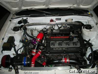

At the time I was making pretty good money and was stashing away $400 to $600 a month to build her. A lot went to tools, Most was thrown away on sh*t that I didn't really need, but hey, it's a learning experience, right? Well, by the end of a year I had a "new" head, an ebay FMIC kit, an ebay 3" catback, replaced alot of the gaskets on the top end of the motor, new valve cover, rebuilt the turbo myself, ect. This was the result:

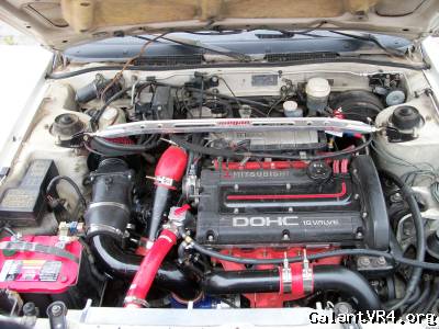

So yeah. That was Version 2.0. Not bad, but obviously not goo either. That's when I started REALLY learning and I picked up a lot of knowledge from a member of this forum. We decided that a total redo was in order, and thus it began. New piston rings, bearings, gaskets, ect. After consideration of the parts I was currently using and a crash course in physics, parts were swapped in favor of others and the engine bay was cleaned up. A LOT. And so Betty became Betty 3.0.

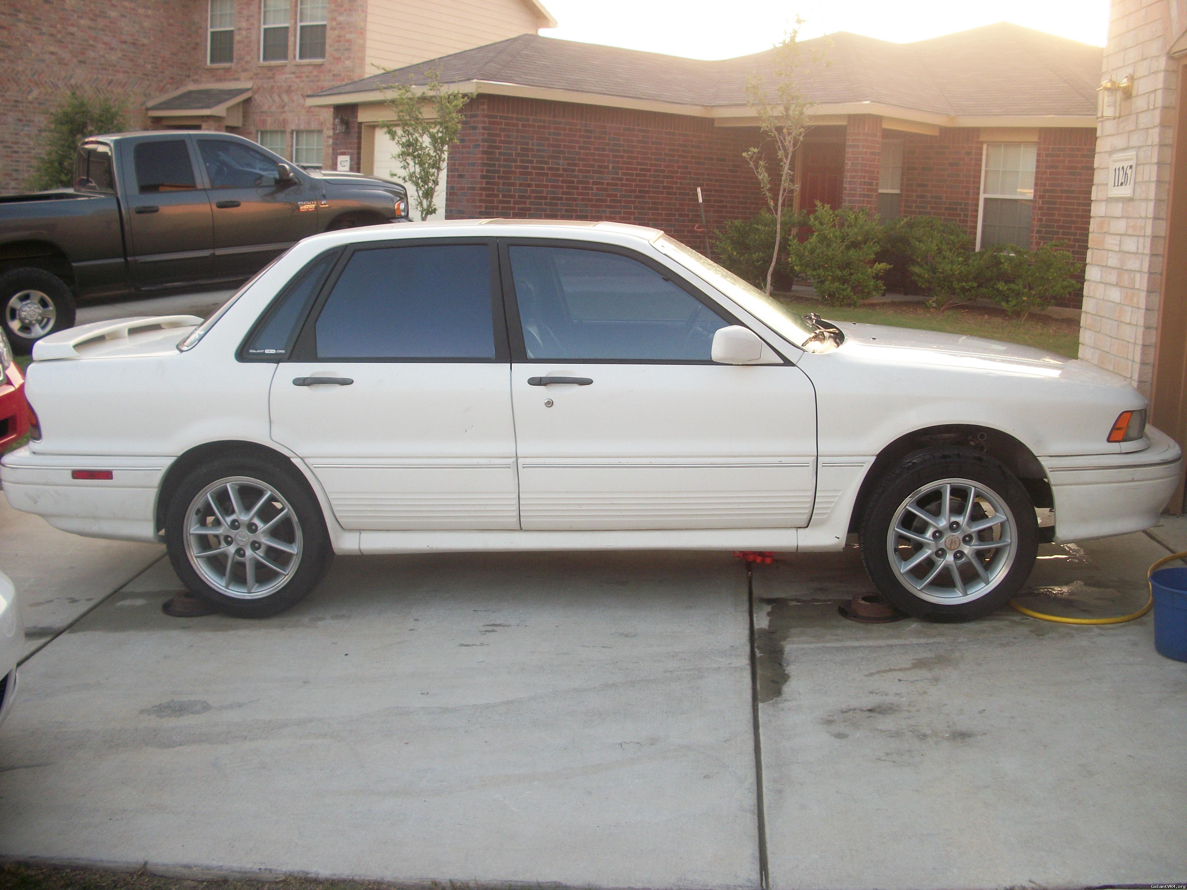

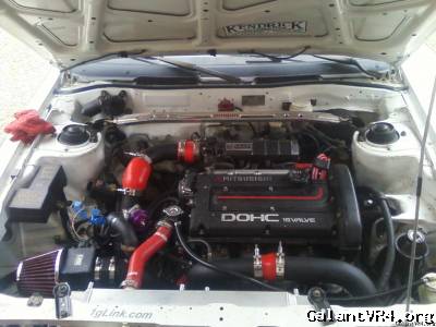

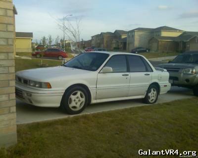

And it wasn't bad...Until the oil pump seized. I took it slow this time around. Sarted with the intereor. OEM seats in better condition than my own, dyed the carpet, a few personalized bits here and there. Then I addressed the motor. My IC pipes were welded together finally, as well as a custom intake pipe, a Treadstone IC core (much better than ebay btw) and tuning abilities from an Evo 8 ECU. Actually, she now has quite a bit of Evo parts now, with more to come. And so I give you the *nearly* complete Betty 3.5:
Modification List as of 05/01/2011
524/1000
Interior:
1g Steering wheel
1g Shifter w/leather boot and 2g knob
OEM Evo 9 MR gauges (boost, oil temp) in custom mount
Carpet Dyed
Broken/messed up trim replaced
Custom Legend of Zelda armrest <img src="/ubbthreads/images/graemlins/wink.gif" alt="" />
Exterior:
5 lug swap
’97 Eclipse GSX wheels
Suspension/brakes:
Front and rear strut bars
AGX adjustables
Cut stock springs
Stock brakes… for now…
Engine:
6 bolt block
OEM pistons, new rings
ACL Race rod bearings
BSE
New gaskets and seals
New water pump, oil pump and Alternator
AC delete
ABS Delete/Q45 Master Cylinder
Cruise control Delete
2g injector plugs
Small 16g with Ported hot side, 34mm waste gate, 17psi Waste gate actuator, MBC, stainless tubular o2 housing, ARP o2 bolts
2g turbo manifold and ARP turbo bolts
Stainless exhaust manifold studs
SCE embossed Copper exhaust and turbo gaskets
2.5” Thermal R&amp;D dual tip turbo back
No emissions
Vacuum lines deleted
Treadstone IC core with custom pipes (Broxma Approved)
Evo 8 MAF
Evo 8 560cc injectors
Walboro 255
Aeromotive AFPR
Thermal intake gasket
stock ignition with Magnecore 8.5mm wires
NGK BPR7ES plugs
1g Aluminum Radiator and Tstat housing
Silicone Radiator hoses
Minor wire tuck
1g NT Camshafts
Supertech Bronze Valve guides
Viton Valve seals
Evo8 Valvetrain
ARP headstuds
Cometec Head Gasket
1g NT Throttle Body w/ FIAV total block off
Custom intake pipe
Obviously I have alot more pics and theres more to the story than this, so ask away if there are any questions.

It sits kind of low and the mount brackets don't hold it in place. He extended the mounts with long (1" or so) spacers and ran a long bolt through them. I will eventually make new bent brackets for them like I have on mine. I also have a 1G aluminum radiator and other than the top mounts, it fits fine.
Furthermore, I'm really proud of how it turned out, even though it is not my car. We both spent a lot of time and energy on getting this car back into shape.

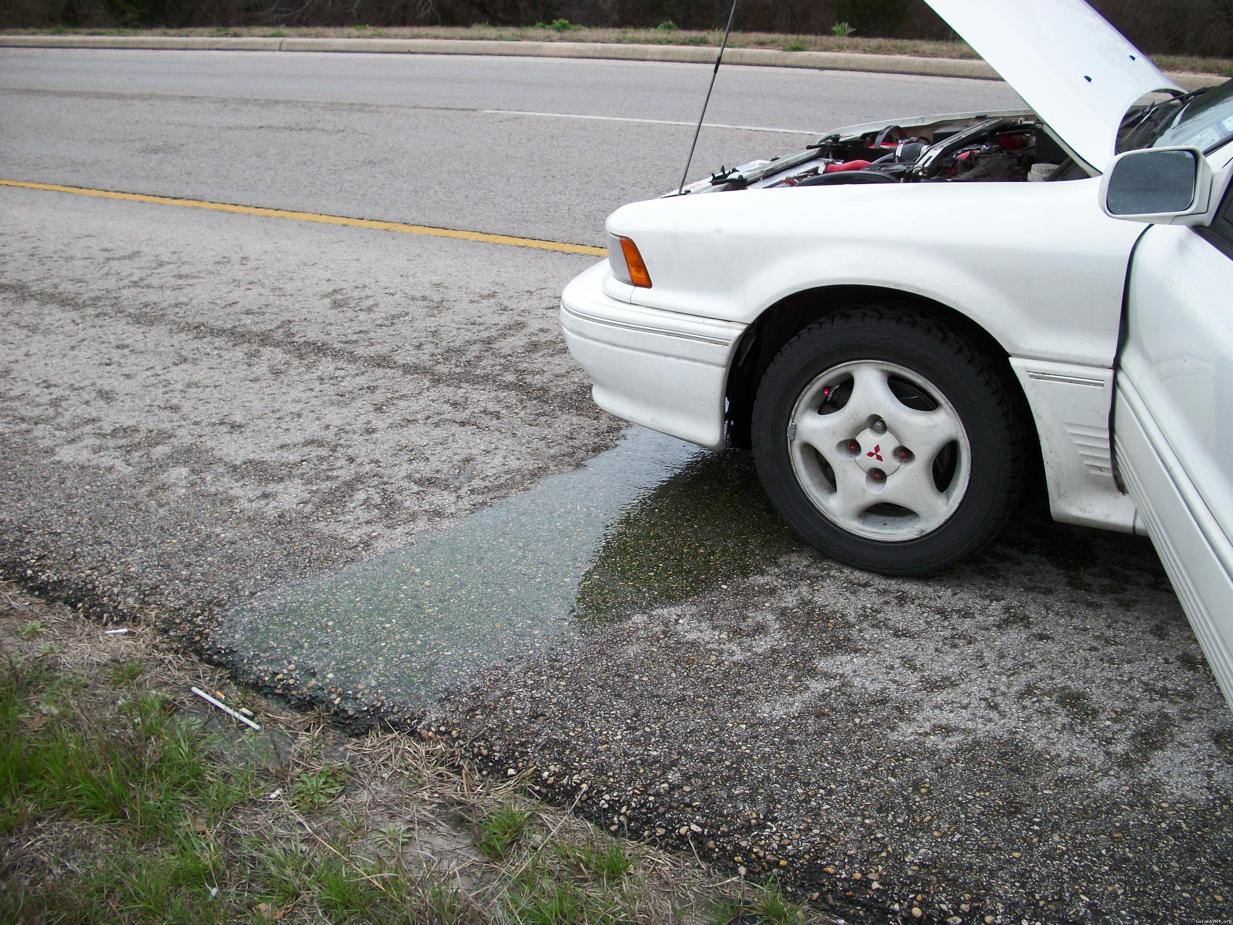

I want to know what happened here; and how you got home /ubbthreads/images/graemlins/grin.gif Hopefully it won't be such a painful story now that your car is so f***ing badass!

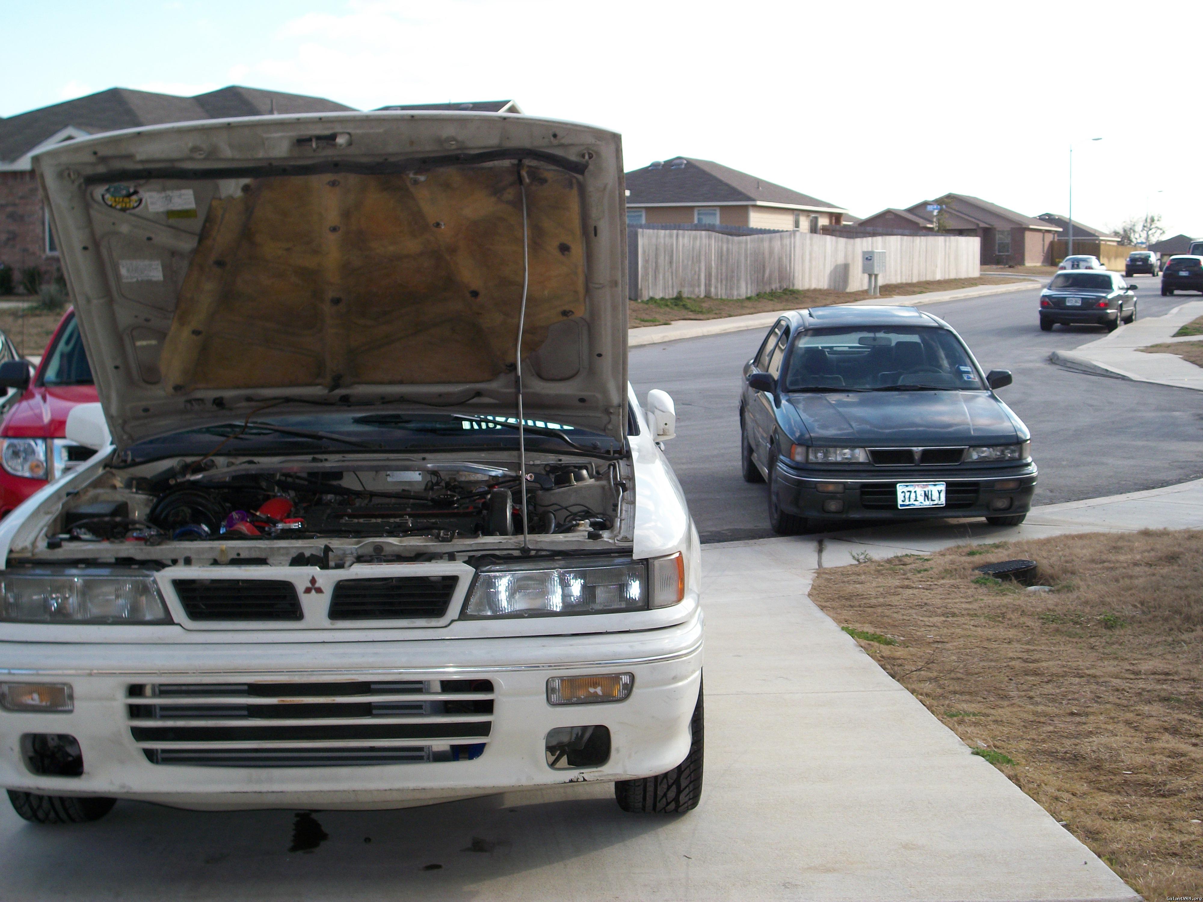

After I had got it running the first time Rick (solidviper) Larry (broxma) and I had decided to take a short cruise/meet. I still didn't know about my low compression at the time so it was super slow, but while I was accelerating on an on-ramp, Rick says I shot out a nice fire ball. I noticed all the smoke from my mirror and then the temps shot up. I pulled over, let her cool down, filled her with coolant again and limped her home. Luckily we were only about 10 minutes from my house. Here's another pic of that moment /ubbthreads/images/graemlins/rofl.gif
