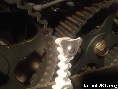

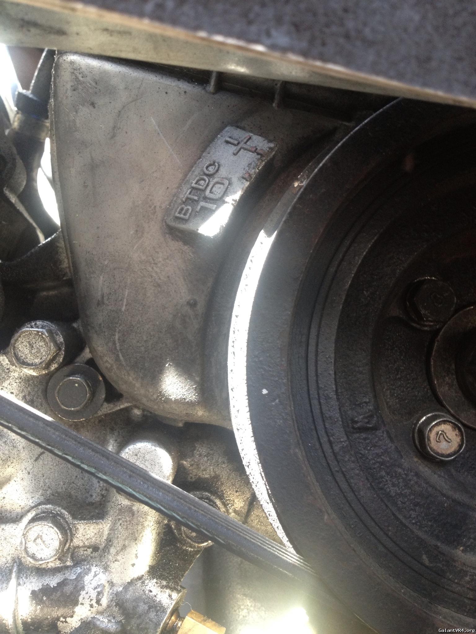

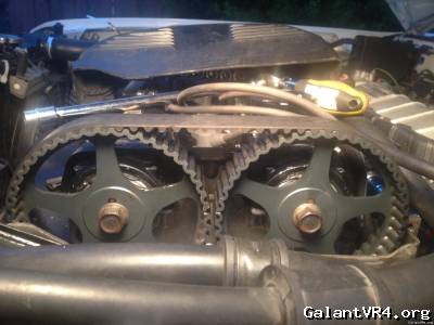

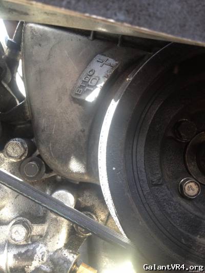

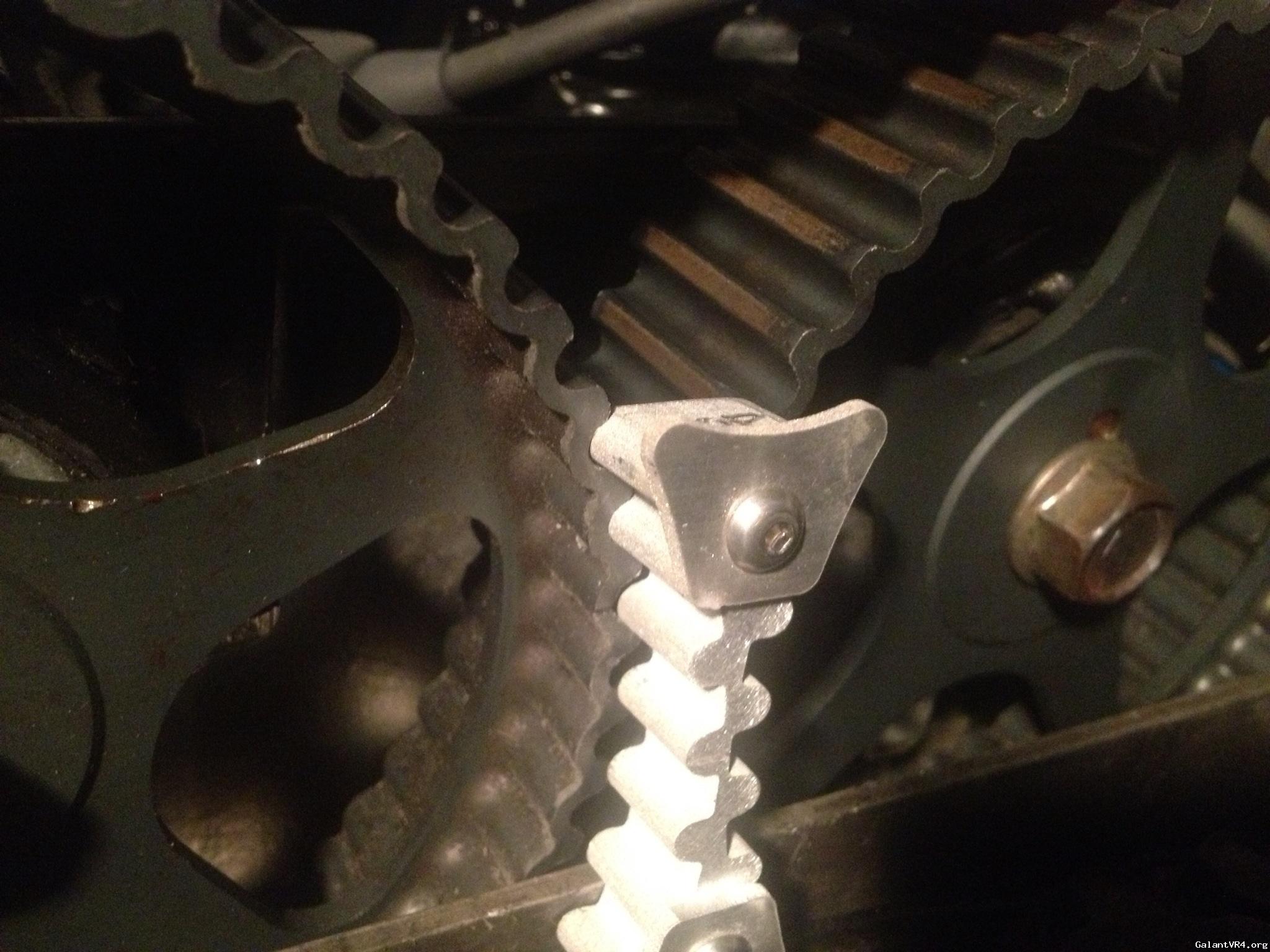

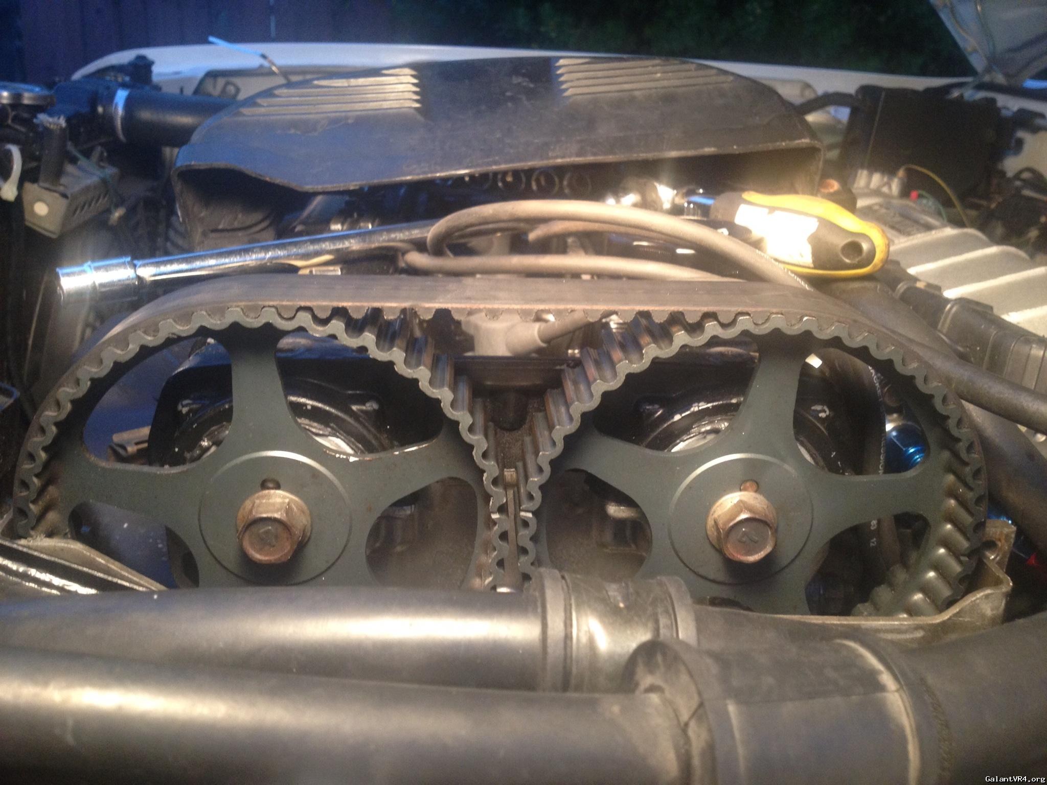

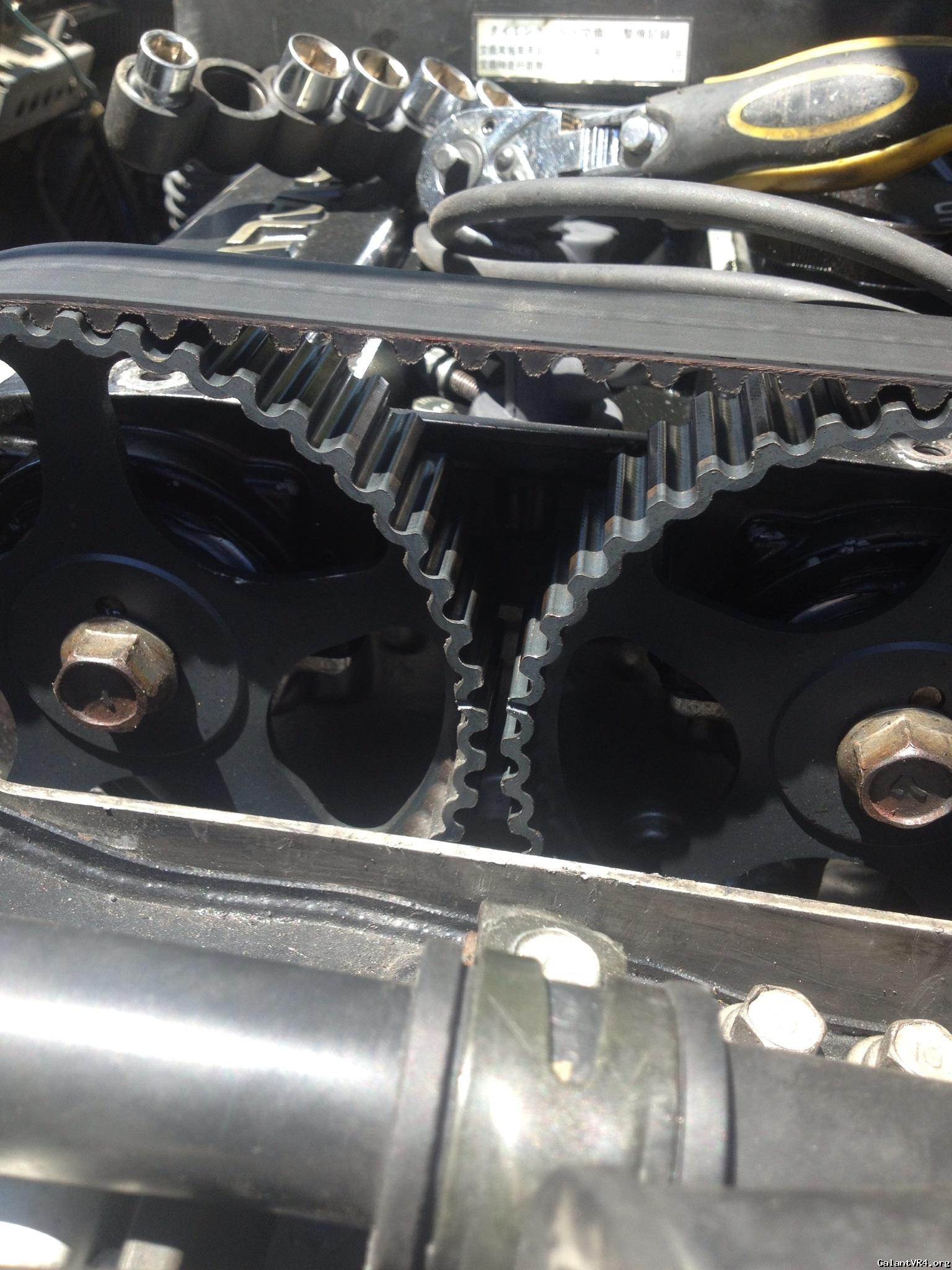

I was reading another post about bad idle and just wanted to make sure my timing marks are lined up proper..I feel my marks are lined up, but both gears are one tooth high if that makes sence. check out the pics..

It also looks like you have the wrong pan bolts in the front by the oil pump. Could be an illusion but it looks like a groove is starting in the middle of the belt.

Damm I had a shop do it.. I really need to do this my self..can i just release tension and turn the cams back,all these parts are new.. I wonder if the valves are ok..I've driven it a couple hundred miles

You should be ok. But the only way to tell will be after its set properly.

Timing is for sure off and they for sure put the wrong bolt in the oil pan. Make the shop fix all of that. Unacceptable work for any shop to do.

get a new belt too. I wouldn't trust that guy.
