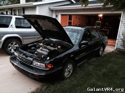

This car (A71 trim opt) has seen a few member's garages (including our very own blacksheep).
After 6 yrs of JSB it's now awaiting plates.
Upgrades are as follows:
ENGINE:
All new gaskets/seals
Nippon pistons (.20 over)
OEM Timing Belt
EVO valve springs/retainers
OEM Main & Rod bearings (std)
ARP Headstuds
Smooth balance shaft MOD (frt removed)
Prothane motor mounts (frt & rear rollers)
A/C removed (OEM A/C delete bushing)
blacktop CAS
TURBO/INTAKE/EXHAUST:
Ported 2G Exh Manifold
Rebuilt n/t throttle body (black iac)
EVO III O2 housing
Megan Racing 3" downpipe (modified)
3" muffler (no cat)
-10AN oil return line
Procharger FMIC (foxbody Mustang)
2.5" AL piping / T-bolt clamps
K&N
Lower Shores MBC
Sealed catchcan from valve cover to intake
FUEL:
Denso 260lph hi preassure
-3/8" fuel line from tank to filter
COOLING:
90 OFH w/-8AN Adapters
Earls cooler w/-8AN Russell ProClassis lines and fittings
Scirocco radiator (FAL fan setup wired in)
DSM coolant fill
New water pump
N/T water pipe
BATTERY/ELECTRICAL:
New BOSCH alternator
Braille 21 battery (relocated to trunk)
Kill switch hidden above plate (on trunk)
NGK plug wires
Single post battery/wiring junction block
VIPER keyless/alarm
DRIVETRAIN:
22 spline JDM trans (all AL t-case)
ACT 2600pp/street disc
OEM TOB
4 Bolt rear (4WS delete)
Stainless clutch flex line
1G "short" shifter (2G knob)
Solid shifter cable bushings
BNIB bellhousing shields
SUSPENSION/STEERING/BRAKES:
KYB AGXs
93 Galant LS "BBS" wheels
1G leather steering wheel
DSM manual rack
TechnaFit stainless brake lines
rebuilt rear calipers
ABS Deleted
Cusco front strut bar (ends powdercoated maroon)
New control arms (front)
COSMETIC/COMFORT/CONVENIENCE:
OEM roof rack & trim kit
"old school" BNIB Thule fairing
Eterna grille
BNIB 93 Headlights
amber turn signals & AMG side markers
JDM fuel door
JDM window visors
maroon pinstriping & JDM door decals
92 Galant GSR seats (cloth)
RED door light covers
LED interior entry lighting
leather shift boot
Dual A pillar pod (Greddy 60mm boost & egt )
Glovebox pod (Boost & Stewart warner oil temp)
Curtis VR4 pod (VDO oil pressure)
Pioneer (green light) cd player
RF Punch & Pioneer speakers
89 under dash
under-seat tray
Illuminated (green) DSM ignition ring
OEM floor mats
Replica datasheet
Custom covers made for the holes where the stock battery and ABS unit were
AFTER Engine break-in
Aeromotive AFPR and -6AN hose/fittings
Filter to rail feed line -6AN hose/fittings
EVO III 16G
OEM Valve cover (powdercoated maroon)
94 Galant GS cams
560cc injectors
2G MAS w/ K&N 2G FIPK
SAFC & Eprom ECU (chipped)
