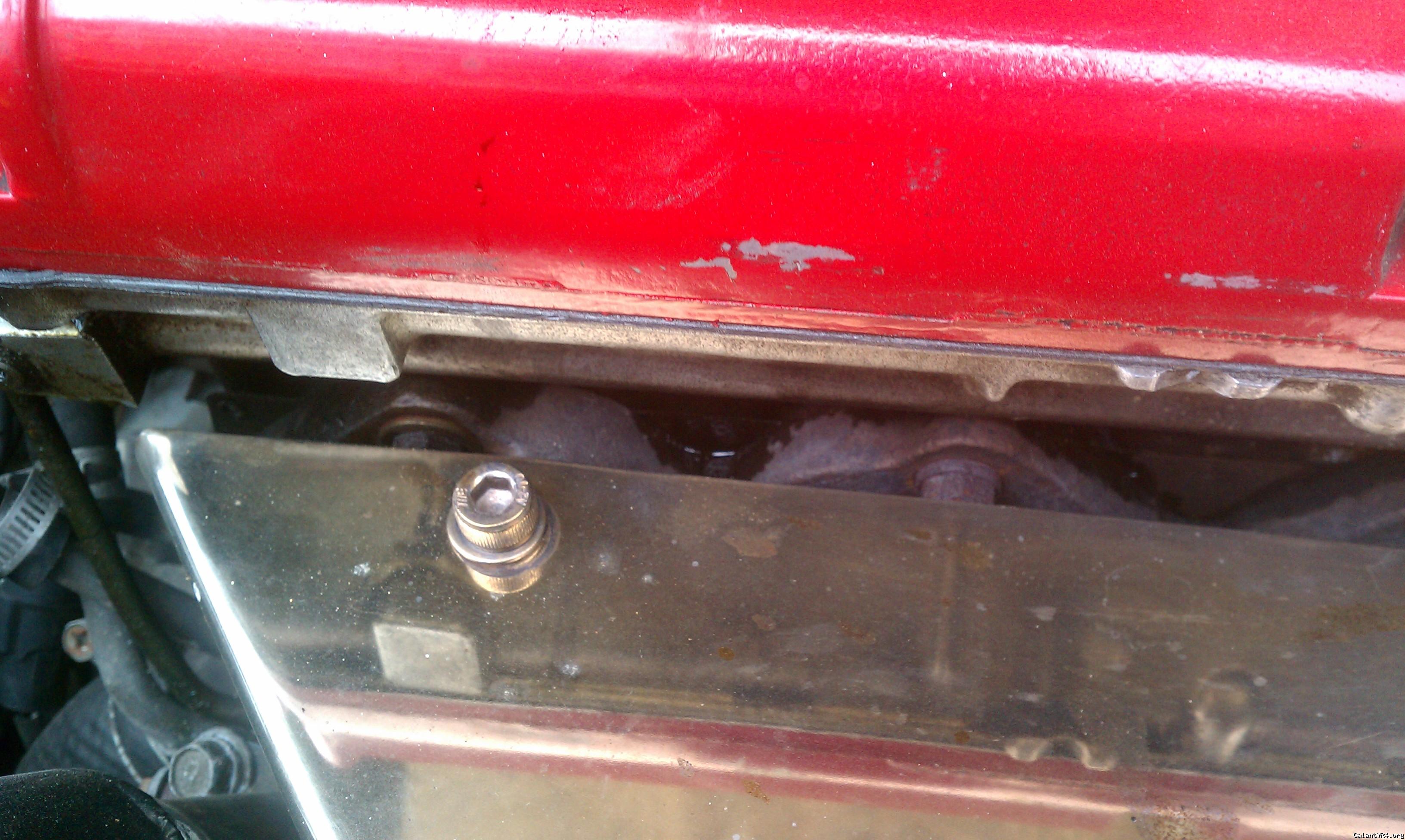

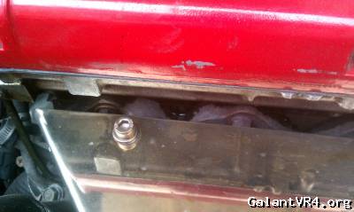

Additionally, I've been noticing oil saturation around my exhaust manifold gasket. Where would this be coming from? It doesn't appear to be coming from the valve cover gasket.

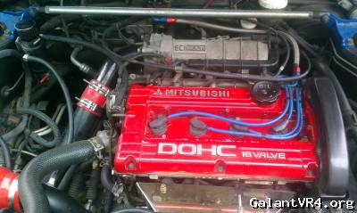

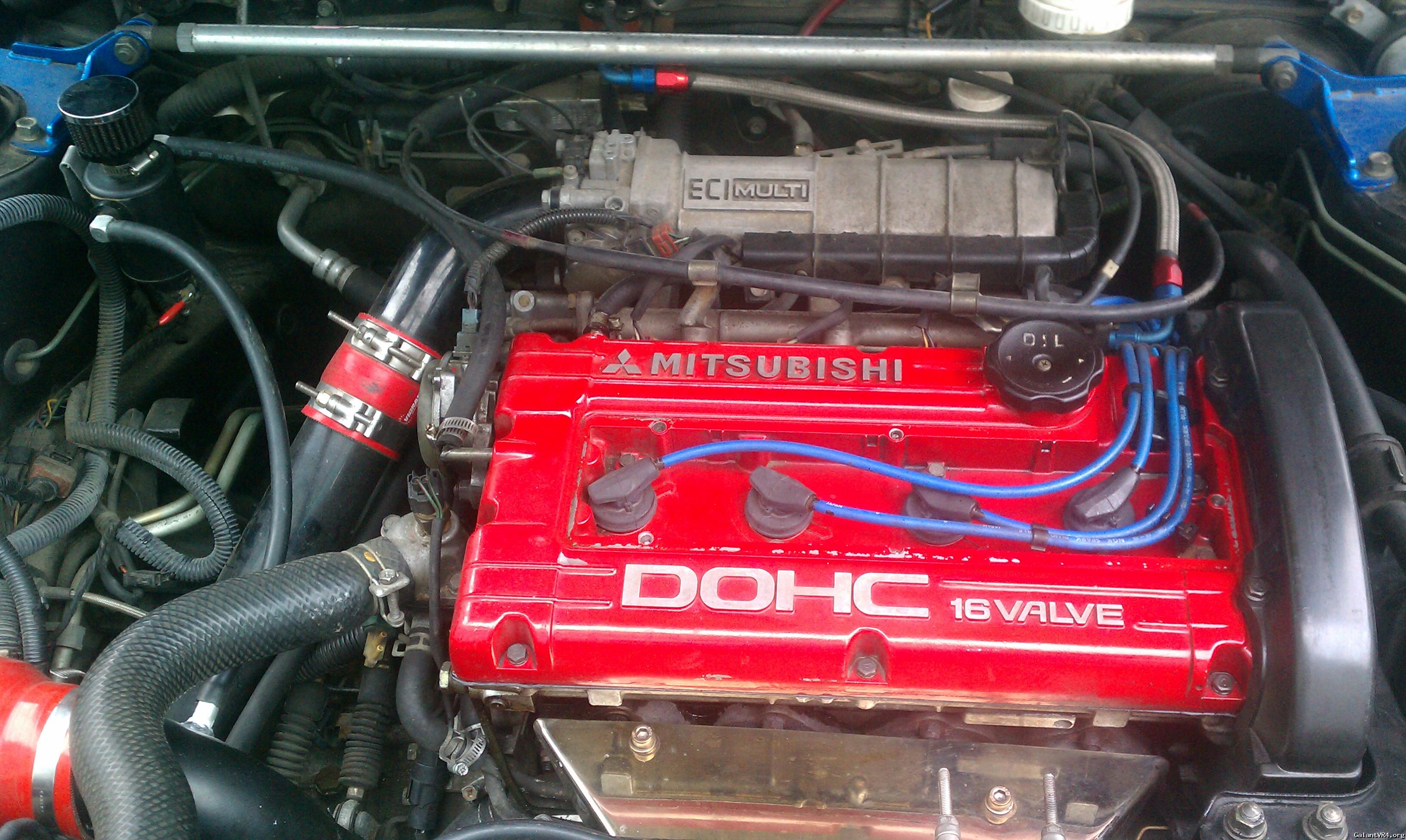

Here's how I have it setup.
Any ideas?

You created a vac leak after the maf when you unplugged the port on the turbo inlet boot. The catch can cannot be vented to atmosphere when using a Maf.

That's how it's supposed to be..... Straight from the VC to the intake pipe
