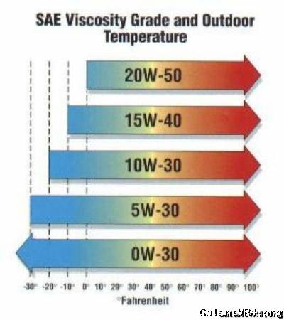

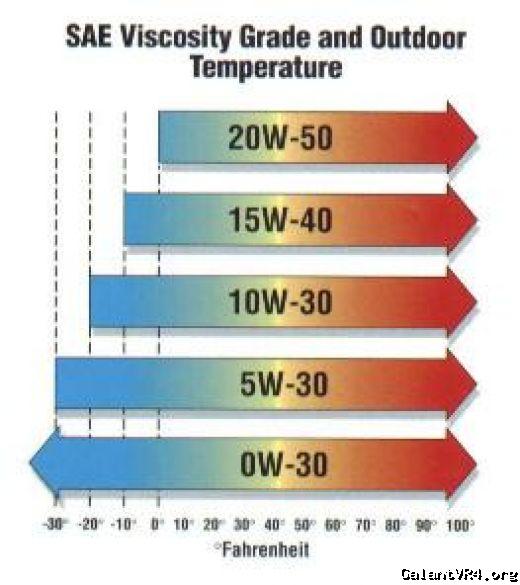

20-50 is to thick for below 0. I would go 10-30 or 10-40

You def need 5w 30 in there for winter.
