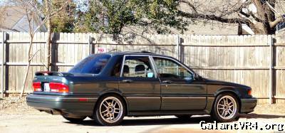

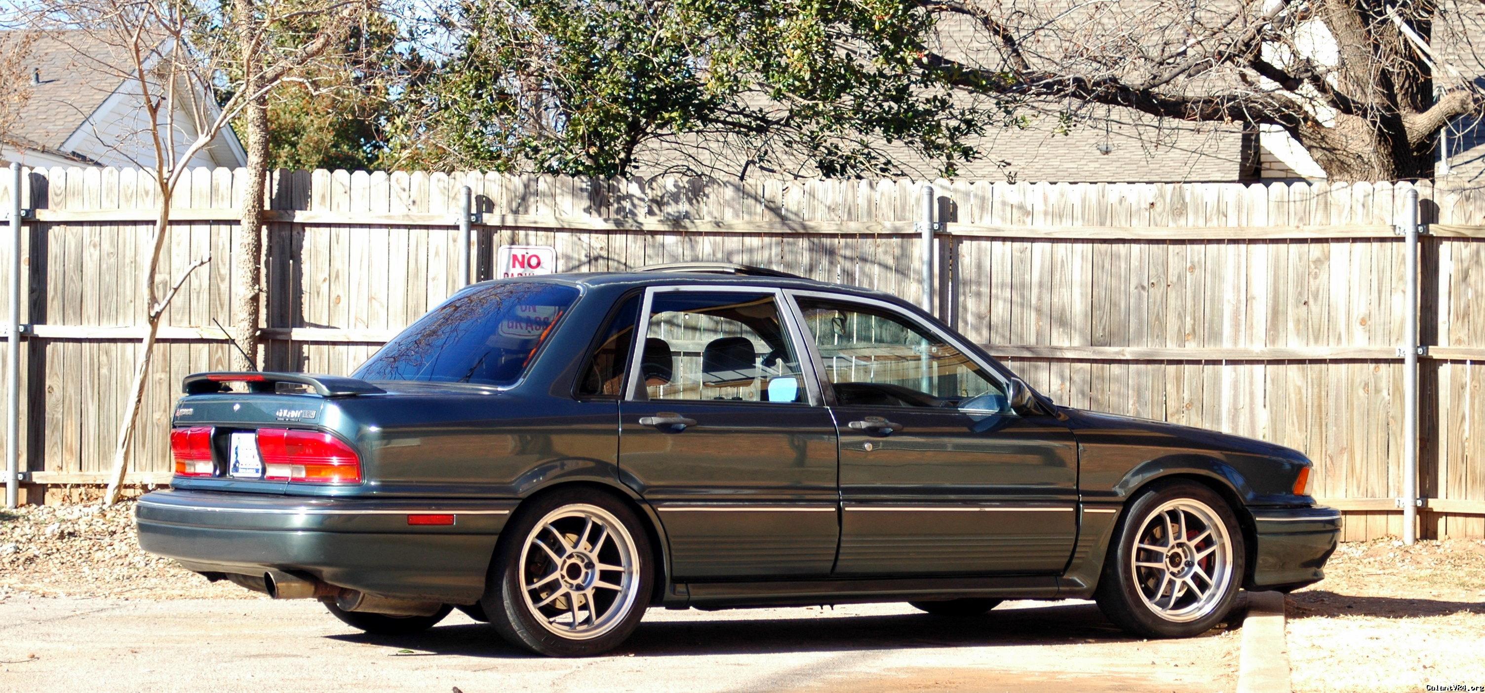

Mine sits low with no alignmnt kit. Drives straight and excellent tire wear with my eyeball alignment. /ubbthreads/images/graemlins/dunno.gif
