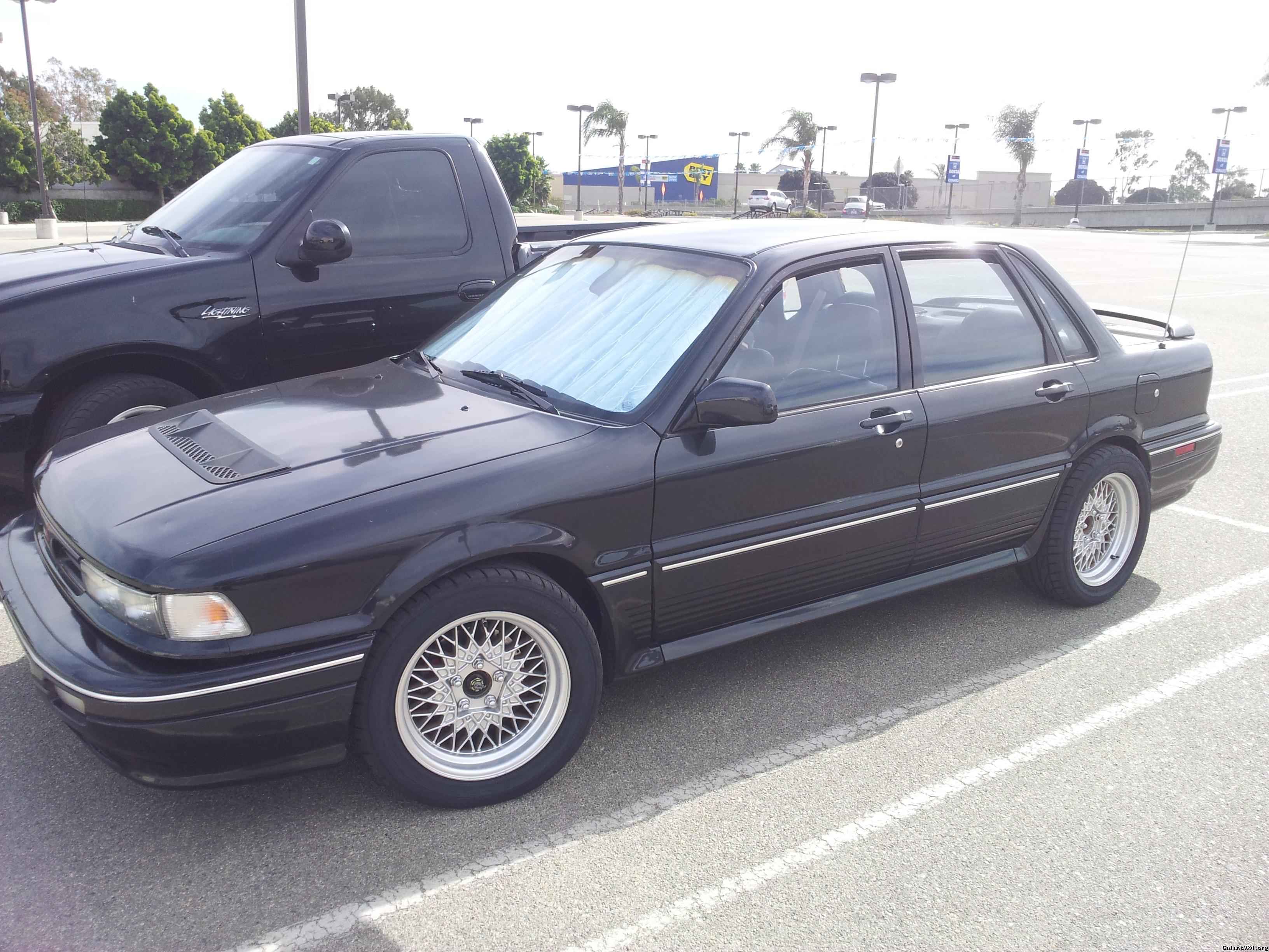

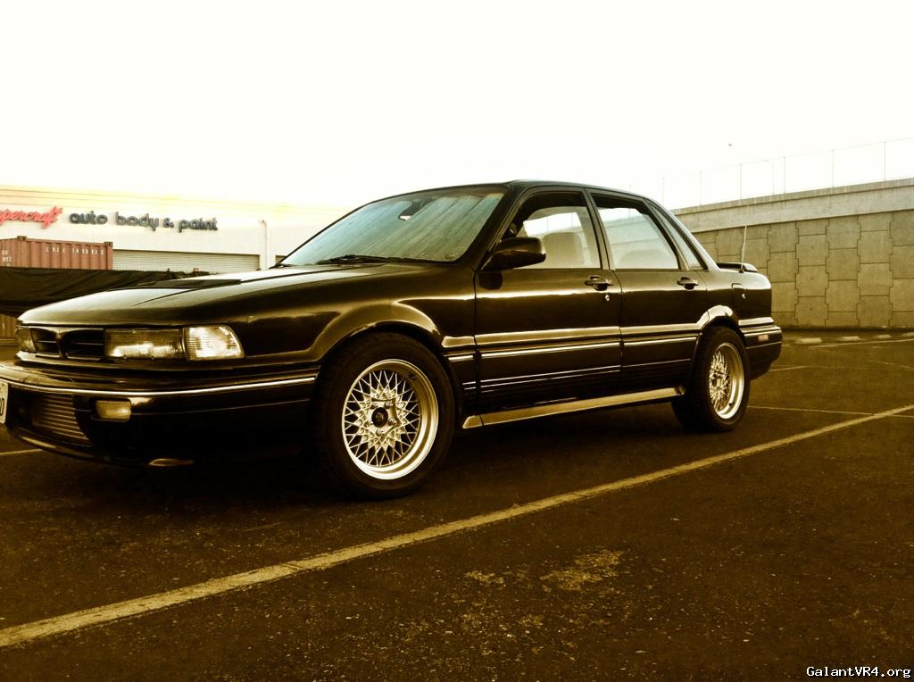

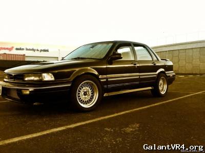

just a teaser pic

great now you just need to get rid of those balloons and run some negative camber. what's the width and offset of those suckers?

but sticking out of the guards a few inches like that?? it just looks all kind of wrong.
I always wondered how those wheels would look on a vr4.
They're off a Crown Vic/Grand Marquise from the early to late 90s. They are 16x7 +10-ish. There are two versions both available with a polished lip or fully painted. The difference between the two versions are in the lug area - there are the star ones like above and ones with some of the mesh design coming into the lug area a bit like old sir meshies.
Those tires appear to be 225/50R16.
(sorry, is my geek showing again?)

doesnt look too bad in my opinion... /ubbthreads/images/graemlins/dunno.gif
edit; the rear seem to be sticking out quite a bit.
f*** it, cut the fenders and throw a set of these flares on it
click
Yes it does stick out about an inch sad because it looks so good on the car. This set up will work if you coilovers and you use a smaller tire like 205/45/16

^^ my thoughts exactly! get some low profile tyres with a bit of stretch going on, some negative camber and it would really look good.

those rims dont look all that bad on a VR4, i like it

No flares.
205's + Camber + Lower = win.
