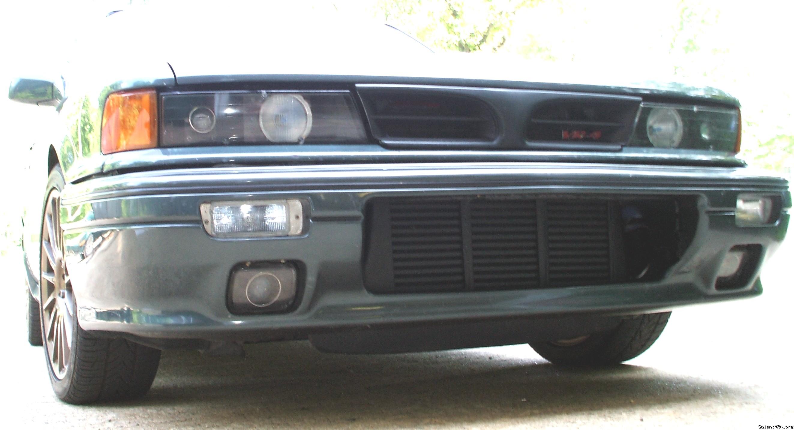

Do you guys think there is any benefit to having an intercooler bigger than the opening in the bumper cover, i.e. parts of the intercooler get no direct airflow?
Discuss...
belize1334
Nov 18, 2003
3,316
Bozeman, MT
On a sustained pull like the 200mph+ guys do then no. In that case you're limited to the heat that the intercooler can dissipate which will be governed by the exposed surface area. But for short bursts the big factor is the internal volume and the cross-sectional flow area. Daily driving, autocross and even drag-racing fit this bill to some degree. So in those cases then yes, bigger than the bumper opening will still offer improvement in performance -- albeit to less of a degree than increases within the opening.

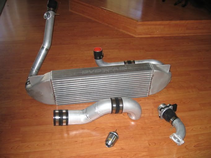

Some of these answers are a little askew. The air opening to a heat exchanger needs to only be about a 3rd the size of the core for 100% of the air to go through the core. Ducting here plays a HUGE part inthis. The above Corvette is a great example as well as any cutaway of radiators on an F1 or similar car. Another benefit would be less pressure drop across the core as the charge air has more passageways to travel through, assuming you are talking about a side flow intercooler and having it be taller than the opening. A third benefit which was also kind of mentioned is the ability for a larger mass to soak up more heat. This will only be a benefit in short bursts as it needs time to come back to ambient between runs. Another thing to think about is that depending on end tank design the extra core might only receive 1-5% of the air as it won't want to make the turns to get all the way up there.
An awesome intercooler for the Galant would be one that was similar to the ETS unit but a little taller, quite a bit thicker, and with a MUCH better end tank design. They really left a lot on the table with that. But for fab cost + complexity + available space they did the best they good and put out a quality piece.

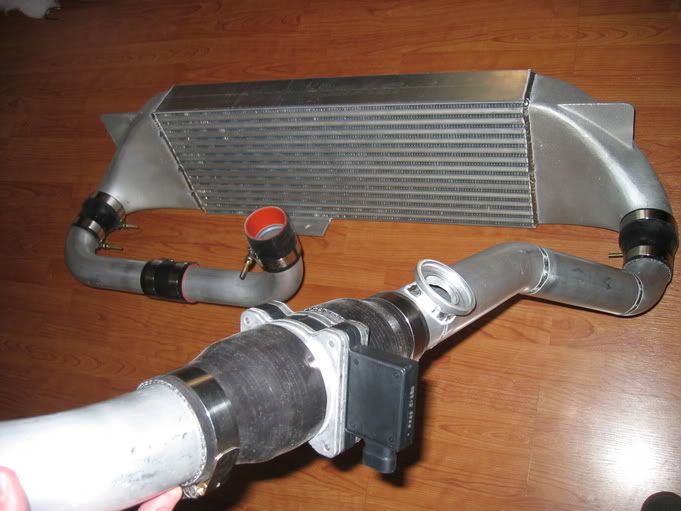

thedsmguy
Mar 20, 2009
1,785
Vancouver Washington
So, I have a idea. Lets throw one of the few manufacturers that actually make something for a vr4 under the bus. Then lets wonder why nobody else bothers. Then lets back it up with "they tried hard"... Get real, and stop talking sh*t just to talk sh*t. No need to mention any certain company by name especially when they make the best by far option that we have for our cars.
Jeesh.. end rant.
GVR-4
Apr 22, 2002
2,610
Asheville, NC USA
I'm not a fan of the ETS end tank design either (or any end tank with 90* corners for that matter). If speaking the truth is throwing someone under the bus, so be it. Truth is truth.

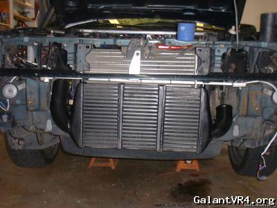

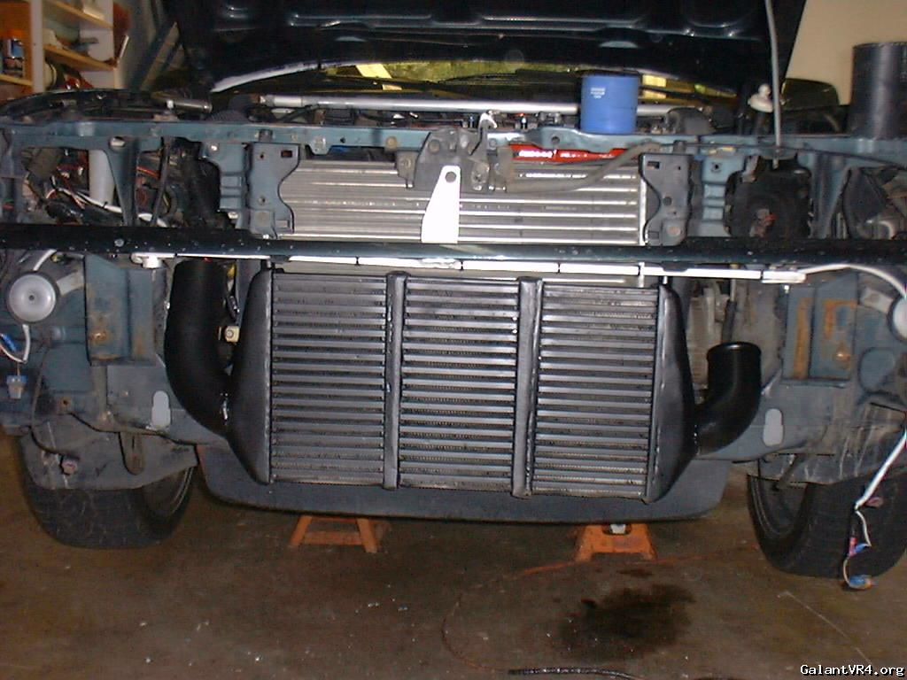

Not talking sh*t, just the truth. In fact I own two ETS kits so I can't hate them all that much. I'm just giving my opinion on what kind of intercooler would make me pitch a tent. Something similar to the DVDT Fab ones back in the day maybe just with some flow dividers to leave nothing unaccounted for. Like dis
Very nice! /Borat
Again nothing "wrong" with the ETS kit and I'm sure it's perfect for %90 of Galant owners including myself, maybe I'm just a little more of a discerning end user than the average person?

^^ +1
That's a good design with the nice cast end tanks, originally for 2g if I'm not mistaken.

So here is the interesting thing. What is the actual measured pressure drop difference between the ETS design, and the one posted. I've been an ETS end tank hater that has softened up a bit. All this talk is great, but is really useless without empirical data.
CutlassJim
Jul 17, 2006
1,699
Manchester, NH
Core area, the one for the charge air, will have a much greater impact on pressure drop then endtank design. That's why I like fatter cores even though cooling goes down exponentially with greater thickness. A really nice end tank on too small of a core for a given mass flow will get the air there then it will get all jammed up and cause a large pressure differential. You wqnt a balance of both. I think the ETS core is fine for my airflow level so it would benefit from a smoother end tank design.
A kid I went to school with works at a place where he can measure drop and flow across a large range. If I evr get off my duff and modify one of my cores I will have to have him do a comparo.
turbowop
Apr 29, 2001
11,972
Yakima, WA
In theory the smoother endtank design is mo bettah. In practice, for the majority of us on this forum, it wouldn't make a noticeable difference. I bet you wouldn't even see a difference in the quarter mile.
