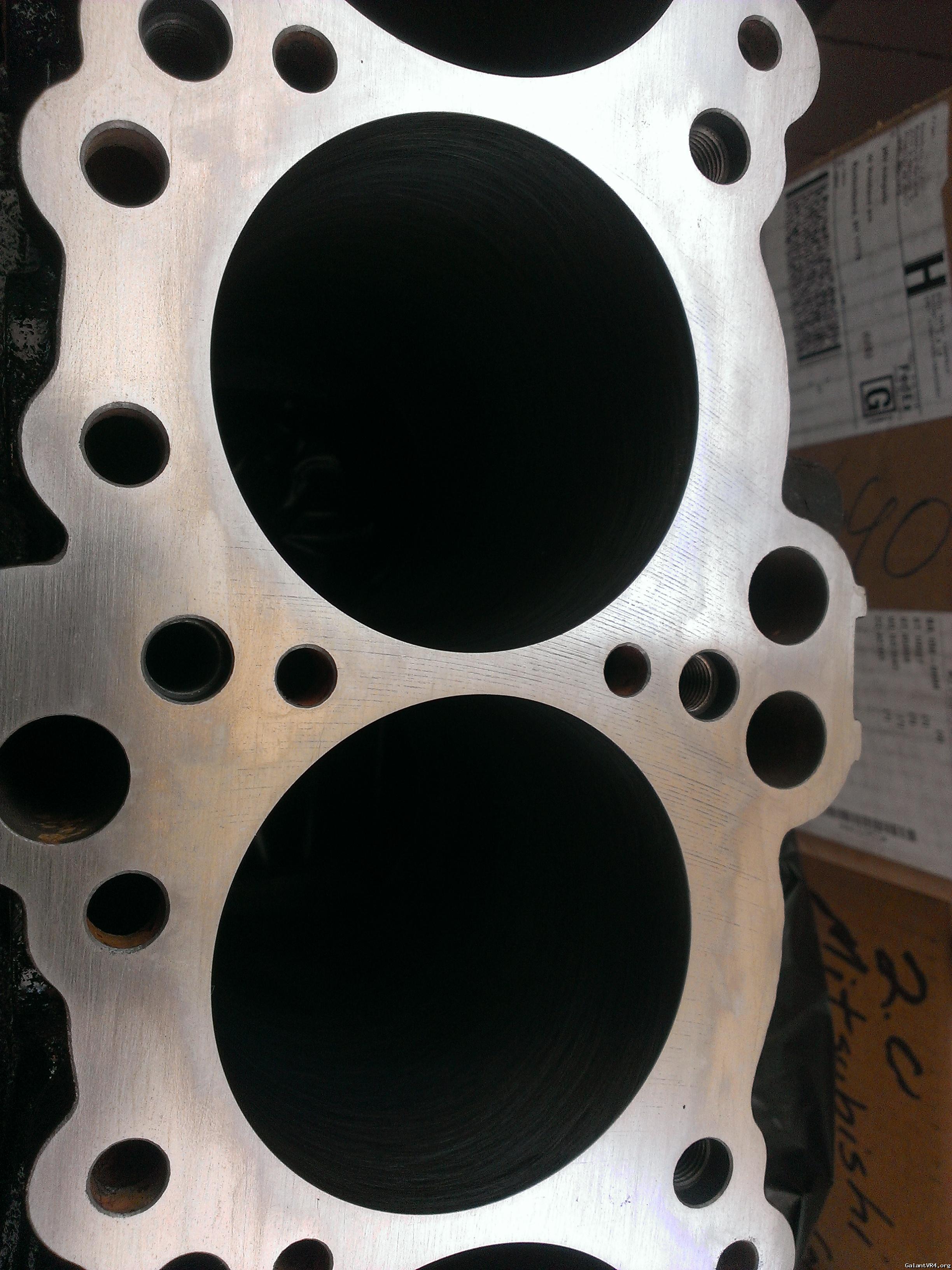

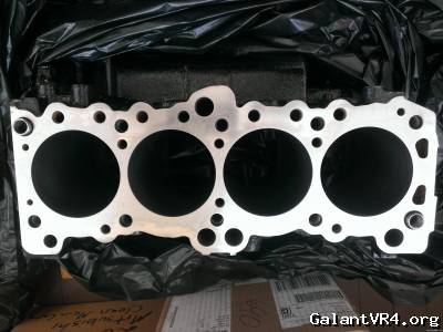

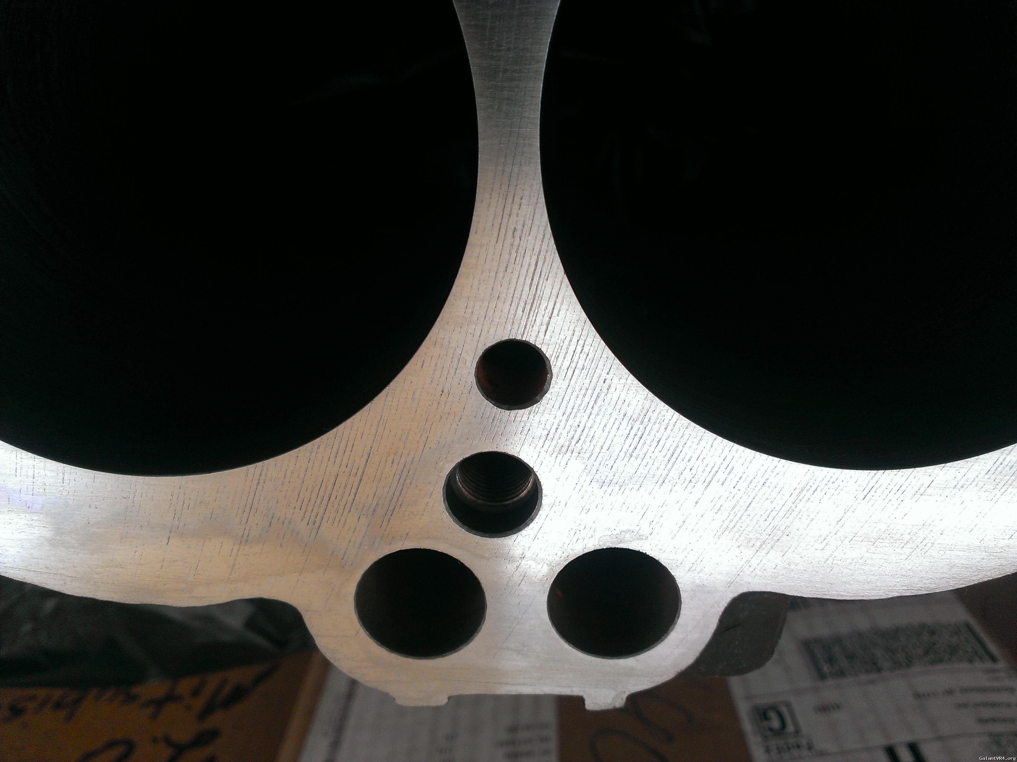

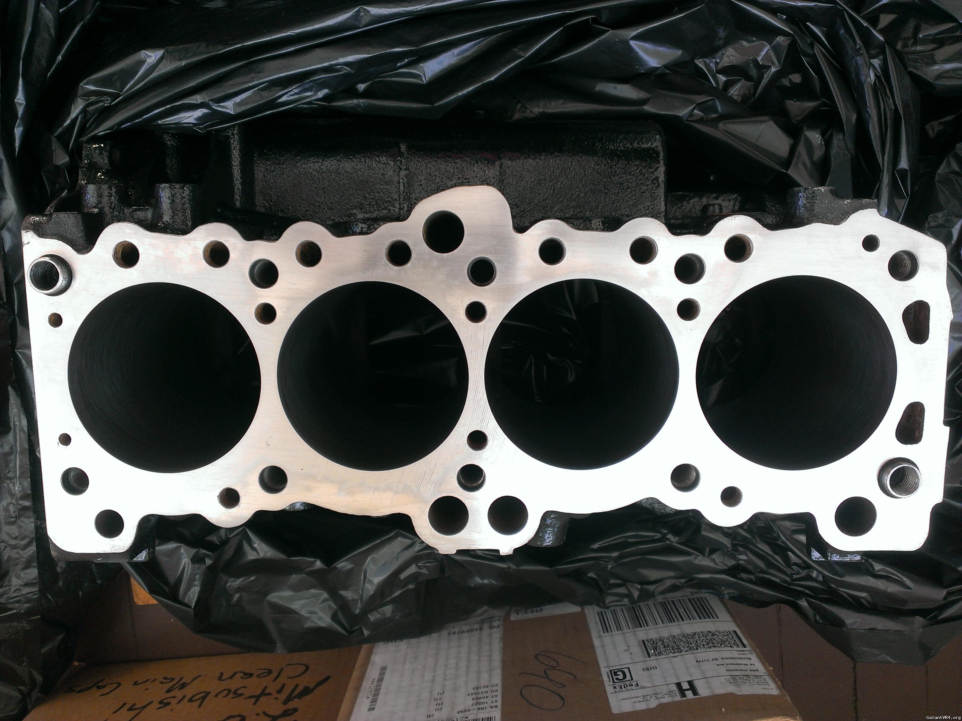

My block surface was just resurfaced very smooth but there are still some slight scratches from previous decking. I'd like to use a Nippon mls and think this Hylomar product may be a better choice over the commonly used copper spray.

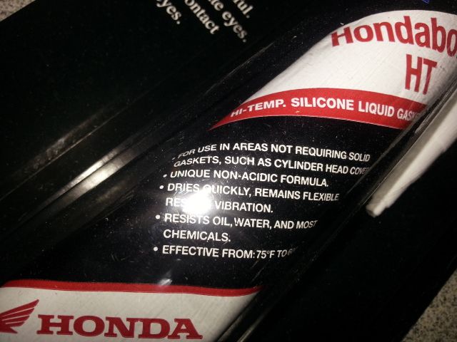

There are two kinds, be sure it's the HT as shown the pics. The other stuff will run like goo at engine temp. I don't even know why they make it.
Also Honda Ultra Flange II is similiar but has better sealing capabilities, if used just right. Comes in a cheese can so it's easier to handle.
Like mentioned, use only a minimal layer on HGs due to squishing out into ports and drains. I personally don't like it and it makes me nervous, but I've heard and seen it done lots of times.
I've used this a lot and it works damn good. Smells like wet cardboard when used. Good example is a buddy of mine blew his HG on his 420A Turbo neon at the track. Coolant was a stream out the gasket. He had a can of this, so we pulled the head at the track, wiped it all down, sprayed this on and put it back together. Damn thing stopped leaking and drove 40 miles back the shop with no leak. (we still fixed it right after that)

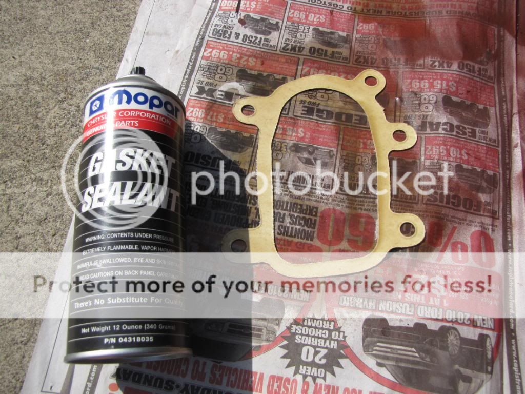

Can you really put the word Mopar on a can that also contains the phrase "There's no substitute for quality"? /ubbthreads/images/graemlins/rofl.gif

So what do you guys think of the updated pics in the first post?
I just moved the block into my basement and by handling it and a bunch of black crumbs started falling out. Spent the last three hours grinding and sanding flashing out of the block. What a mess. I sprayed with brake cleaner and ran some brushes through it but I think I'm going to have it jet washed again tomorrow.

was thinking about the Mopar sealer but forgot what they called it. had people swear by that stuff.

Quoting GSTwithPSI:
That's cause Mopar has someone make the sealant. The stuff is awesome. I haven't used it in a couple years and I think they have a new can design, so not sure if it's the same formula or not.

I did however ask for opinions on the surface finish of my block. The guy who did it says the MLS will seal fine clean and dry but I'd like a second opinion before I bolt down a new gasket dry again.
I have yet to see a comment on the surface finish.

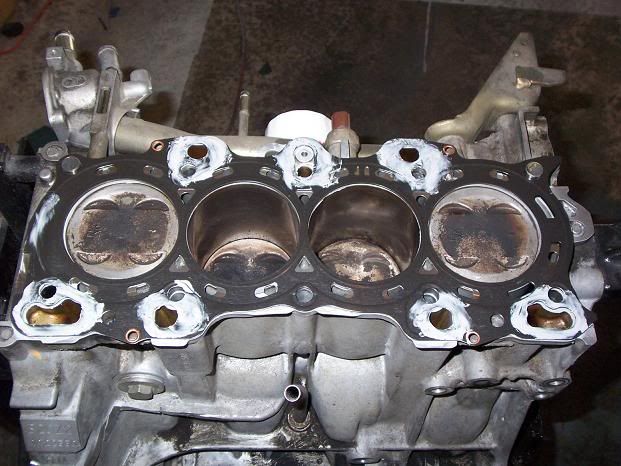

I use Permatex copper spray (readily available from your favorite local auto-parts store) on MLS HGs and have done so for years in cars that see 40psi+ boost levels with excellent results.
