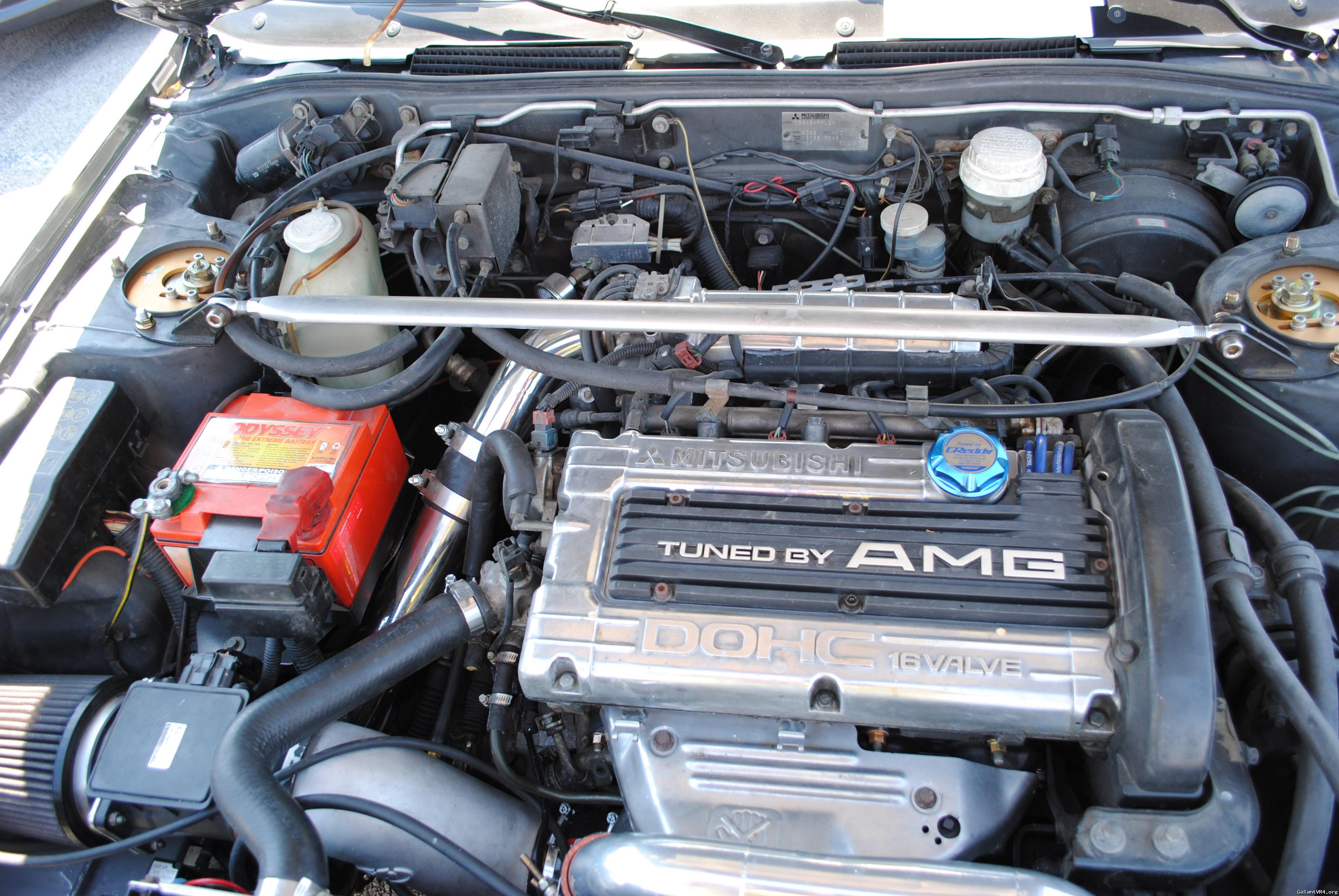

Here's a picture of mine with modified ETS piping. The FP 4 in Intake is a perfect fit with the right size air filter and a relocated battery.

Well my battery is in the trunk so im not worried there. You said your piping is modified? I was planning on just running the 4" pipe with the 4x9" K&N that most people run.

Yeah I had a 68HTA on there for awhile, but recently went with a FP3052. Had to weld an elbow on the compressor outlet and mod the outlet pipe to fit. It still follows the same routing as the 16G style pipe.
