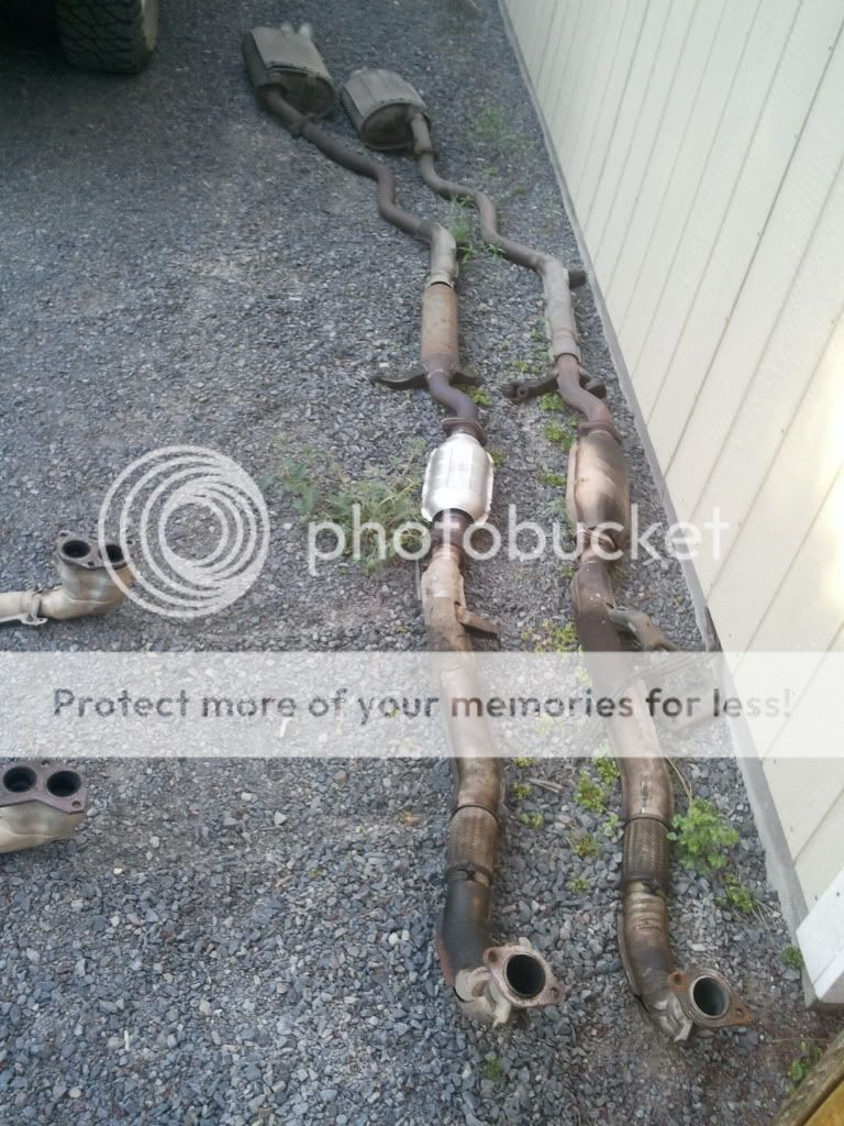

just did 2g downpipe (ebay obx) and made an exhaust. here is a gvr4/1g awd exhaust difference pic i just took
vr4 on right

Nice comparison. The DPs look interchangable /ubbthreads/images/graemlins/dunno.gif

Looks like the cat itself is just longer on the VR4. Interesting. As for Emissions, I can care less. The cat that was on the car was just a shell.
