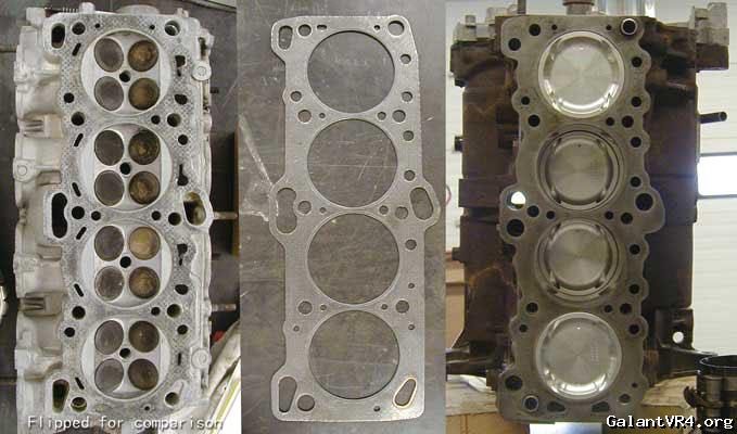

I'm getting ready to do an engine build off of the profits from my 90 TSI partout (see upcoming FS thread). I've got a nice 1G head that I'm gonna use but I'm gonna have to source a crank one way or another (spun rod bearing = nasty rod journals). This started me thinking about strokers again. After some poking I found that I can get a low-mileage 4g64 short-block for pretty damn cheep (like same price as reusable 2.0 crank). That'd mean that all I'd need is a set of pistons since I've already got a spare set of 1G rods.
Here's the hair-brained part. I'm thinking since the 2.4 deck is 6mm taller, I could just use 1G or 2G pistons in there. The only problem that I can see is that I'd need to get 0.6" overbore since it's a 86.5mm bore instead of 85mm like the 4g63. So I'd have to assume that the block doesn't need a rebore.
Now, I know that most people who do a stroker go w/ aftermarket rods and pistons but I'm not building to make a power monster. I just want my easy living 300whp but w/ super fast spool up and a really low boost threshold. Something like Evo3 16g on 2.4L would hit full boost at like 2300rpm and have instant spool. And 1G rods w/ 1G or 2G pistons have made 400+whp time and time again so they should stand up.
So what are your guys thoughts on this? 2.4L block w/ 4g63 head. 1G rods and 1G or 2G pistons 0.6" over. Good for up to about 400whp w/ amazing turbo response. It'd be the autocross hawtness but buildable for the same price as an OE rebuild.
