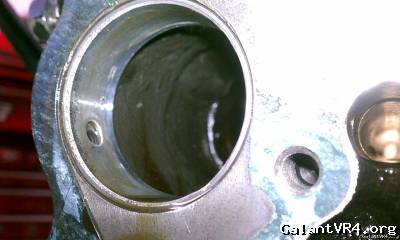

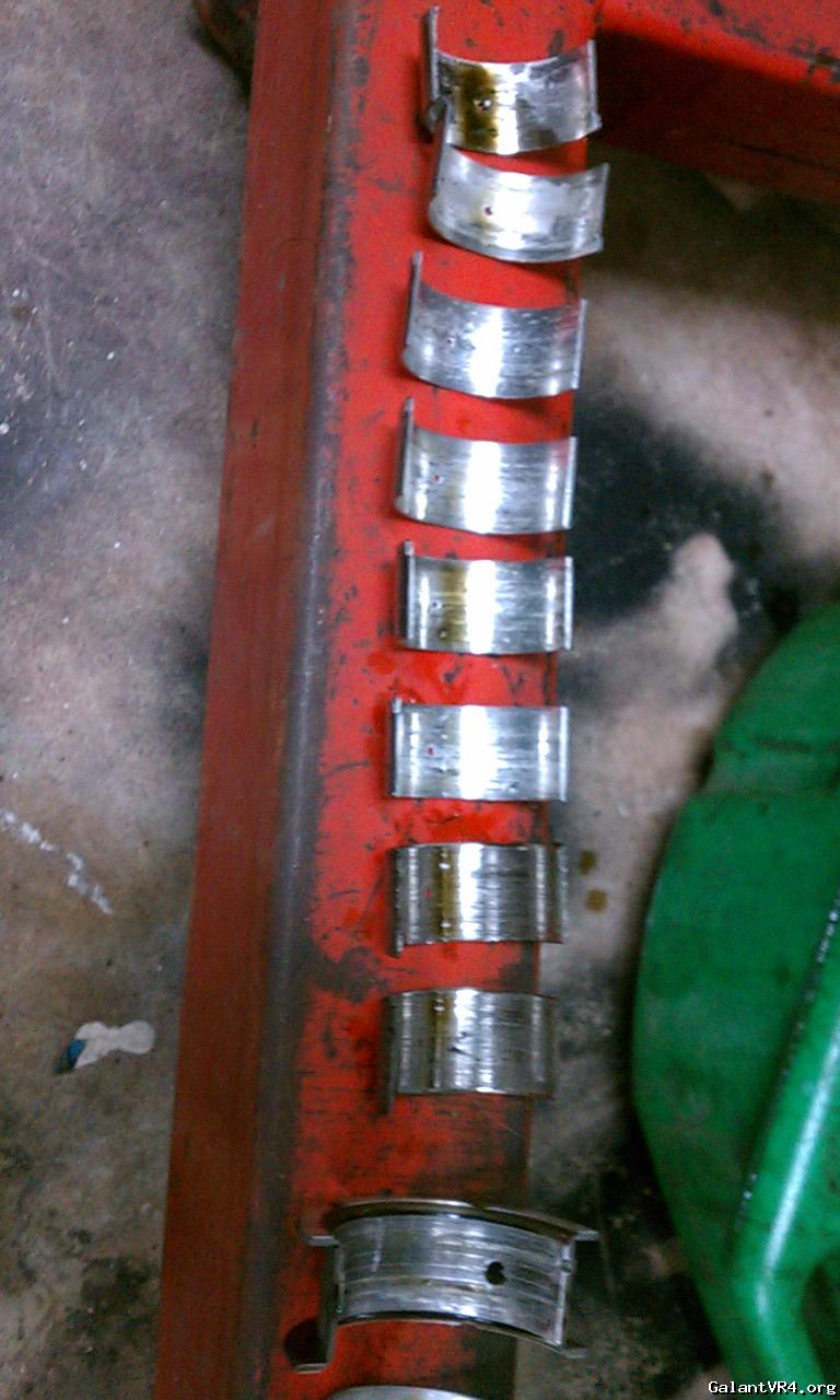

Hi everyone, I tore down my engine this weekend and found a spun rod bearing. I also noted damage to the front BS delete bearing. Has anyone seen these get damaged before? It does not have a BS in it and it was new when installed. The engine was running when I pulled it. It wasn't in good shape, but I've pulled many more that sounded a lot worse that didn't have this much carnage inside. What is the main cause from oil starvation? I had a new pump. Everything was new. Hate to put all new stuff back in and have the same problem. Do you think I should replace the entire front case? This one only has 3000 miles on it. Thanks, Matt

Initially I suspected that the spun rod bearing was a result of the shady DSM Graveyard 2g piston 1g rod combo that wasn't machined properly. Now I'm not sure if that was the problem or just a symptom.

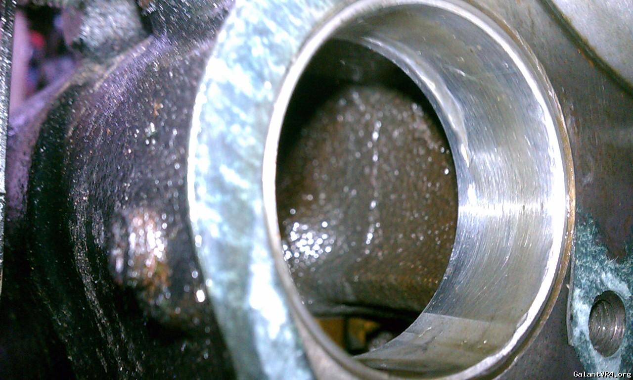

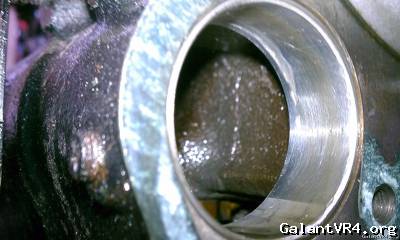

I just found it odd that there was any markings on the BS bearing. Nothing touches that? What could have caused those marks?

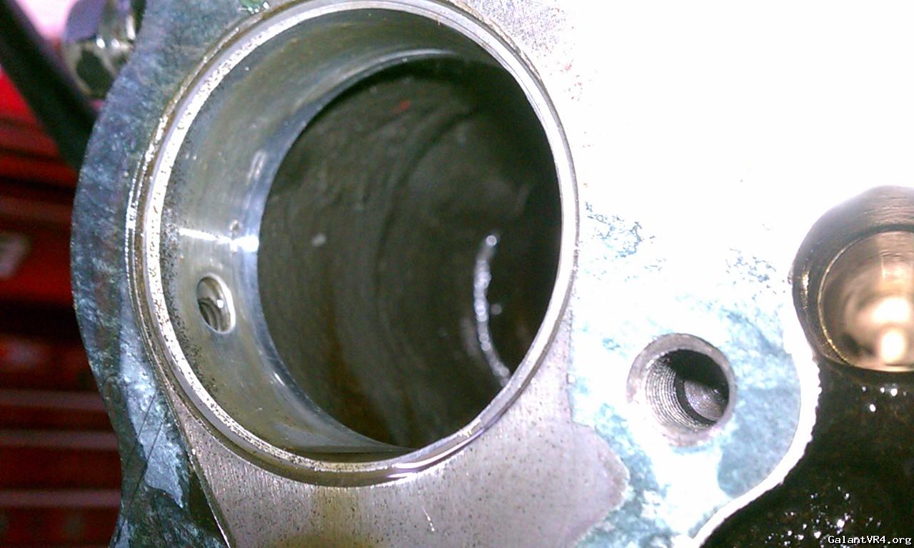

Stupid question, but the BS bearings were removed and reinstalled to block off the oil feed holes in the block, correct?
I only ask because in one of the pics, it looks like the bearing feed hole is aligned with the feed hole in the block.
matt92vr4
Oct 3, 2010
676
Venice, FL
Yes they were but it does in fact look like it's lined up now. That's weird. That would have caused oil starvation. Those bearings can't possibly rotate once they are installed can they?

Isn't that hole for sliding a screw driver or something into to align the balance shaft?
Edit: never mind, I'm thinking of the rear BS
EHmotorsports
Sep 25, 2012
1,278
Beaverton
It's ok to have it lined up with the outside hole. The other side is plugged. The outside plug/hole is for when they drilled the oil passages at the factory.
matt92vr4
Oct 3, 2010
676
Venice, FL
Thanks for the info. I double checked and it is lined up with the outside hole.
