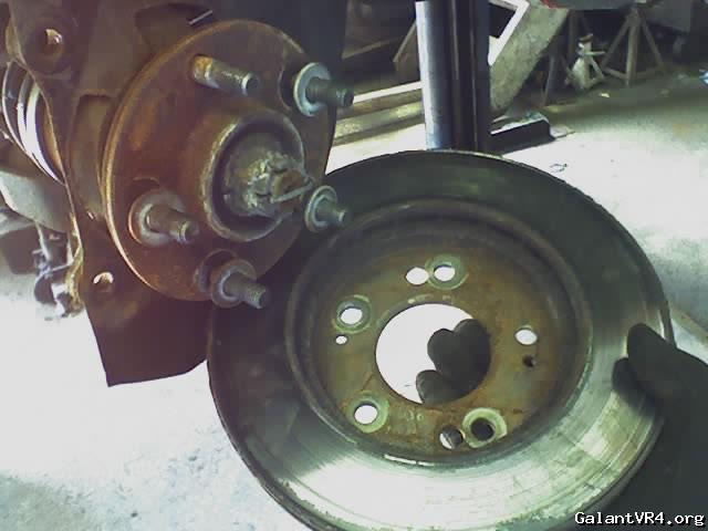

So i'm the new owner of 935/1000, but my left front brake keeps having sticking issues, after replacing the caliper, caliper bracket, brakes, checking the slide pins, i'm running out of ideas. When looking at it, it looks like the brake pads are misaligned from the rotor, as one is against the rotor while the other has a gap between it and the rotor. If anyone has any opinions, it would be greatly appreciated. /ubbthreads/images/graemlins/smile.gif
Picture of said phenomenon!
Also, was the rubber flex line replaced?
this^, id like to know, are you holding the rotor flat against the hub when you pull the wheel off, because when you pull the wheel off the rotor usually shifts a bit and does look like one has a gap and one is touching.
a good way to check for block/clog or collapse is to pull the caliper, leave the bleeder closed and try pushing in both caliper pistons at the same time. if you feel a stiffness or resistance then the line is probably collapsing or there is a block/clog somewhere.
