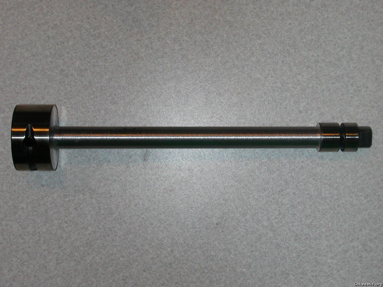

Why can't you just cut the rear shaft off, and fill the oil passages with jb weld or silicone? what am I missing? I saw a page that has you cut it, tap it and put a longer bolt in to plug the holes, but why not a more simple approach?

That sounds horribly unreliable. Just buy the $8 or whatever OEM stubby shaft and live happily ever after.

Why not just turn the bearing to block off the hole? JB weld and silicone could potentially free itself from the hole and get into your oil pan/pick up and end up somewhere where you don't want it. Tapping and inserting a bolt does seem a bit much though.

didn't say I was gonna do it, just curious. What about filling it with a weld?
Where do you get the stubby that cheap? JNZ want's $60 for the kit, all I need is that piece.

I have one in the parts for sale section
click
or you can buy it at autozone. its a factory mirage part or something
*I would sell it for like 13$ to cover shipping and its yours no problem
in the mail in the am

MD098626 from JNZ = $13.23.
The kit includes the front shaft plug, stub shaft, spacer (replaces the sprocket that drives the front b-shaft), and two b-shaft bearings to block off the oil ports if you remove the front shaft. If you leave the front shaft in, all you need is the stub shaft, and the spacer is optional.
Also, cutting the shaft and welding it could either A)Dimensionally warp it or B)Remove heat treatment. I don't know if the factory shaft is heat treated or not. Either way a potential disaster.
So basically for $13+shipping it isn't worth the risk or hassle.

Or you can turn your rear shaft for free.

Quick and easy method is to replace the rear shaft with the OEM stubby and leave the front shaft in without a belt. Cheap and effective. Both my cars are done like this and have been fine for tens of thousands of miles. All you need to purchase is the stubby shaft and a couple of new gaskets.
