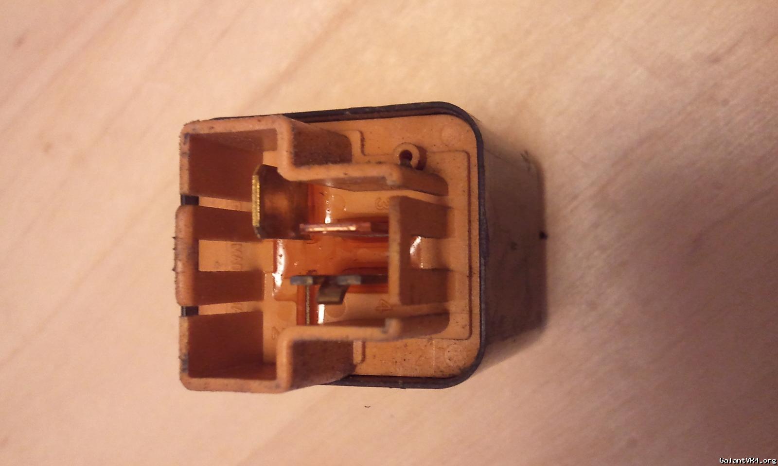

forgot about the alternator fuse/relay, pulled it and this is what it looks like- is that gel like substance or whatever between the prongs normal? Also when I shake it, i hear something tiny moving around. trying to cover my bases here

Relay looks fine. More than likely your alternator is on it's way out. Sometimes they will intermittently not work when they are on the way out.
