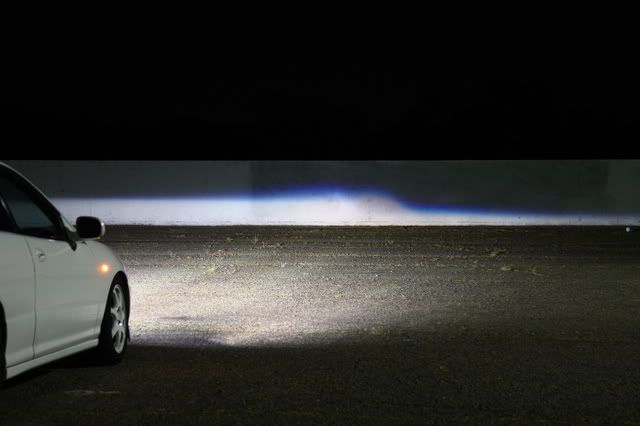

What kind of cars are in those pics? Those cutoffs look sharp like HID projectors. My Audi HIDs didn't even have that spray of light off to the right up high like that.
Are the JDM or USDM Galant lights actually like that? I've never really noticed either having such a nice, focused cutoff. They are much more washed out. It's just a reflector behind glass.
jogalant
Jul 28, 2005
1,180
Central FL
LHD projector beam pattern:
RHD projector beam pattern:
The illustrations below show the new projector (LHD) and then the old Euro and JDM lights as we call it. Except for the US, Galants either came with euro or jdm lenses depending on where you lived. In my case i was able to buy a pair or LHD "euro" lenses from a guy here in Virginia who said he bought it from a guy who came from the Philippines, where they drive on the right side of the road like we do. USDM light patterns were for the most part a flat line from left to right. if there was a cutoff (the part where the beam starts to rise like the euro or jdm lights, it was hardly noticeable)

Your not even showing or discussing Galant headlights. Your talking about projector lamps, the difference WILL be evident with that style. Glass prism lenses are completely different and not even a fair comparison.

I think the point is that the different requirements for the headlights depending on the drive side will yield similar results. Even if not that evident or dramatic as with the newer headlight styles, the aiming will be biased the other direction and likely not able to be adjusted completely to be correct for rhd roads.
