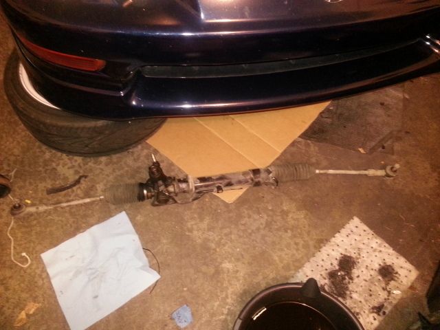

scored a 92-93 AWD DSM rack since mine is leaking...

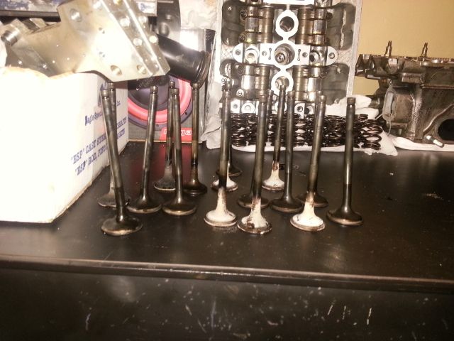

dont mind the Integra, she is on some serious JSB after trying to make some music with the valves (bent every one lol)

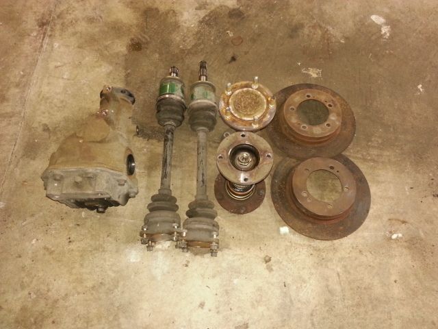

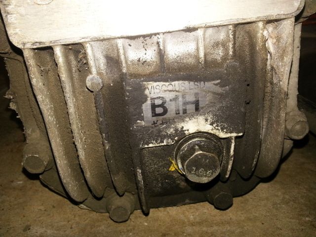

"4bolt" rear axles = stronger that the 3bolts in my car
4bolt LSD rear end axles
5 lug rear hubs/stubs/rotors (gonna turn the rotors at work)

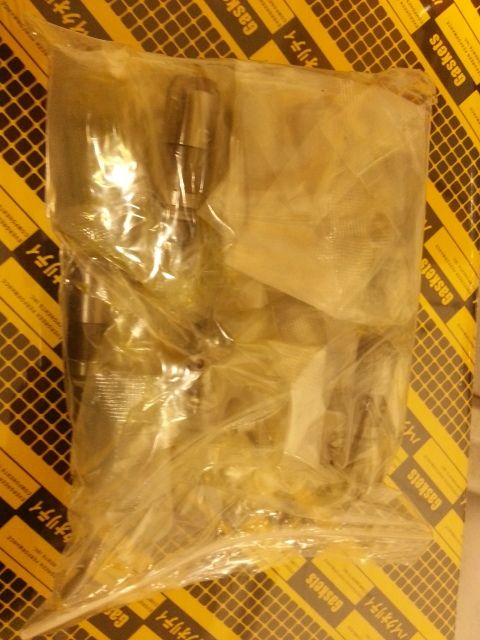

oh, didnt mention this above. think i have a couple junk lifters. seem to not pump up when cold/low RPMs. and randomly get 1-2ticks when running. so i picked up some fresh ones. also have a valve cover gasket set around somewhere.

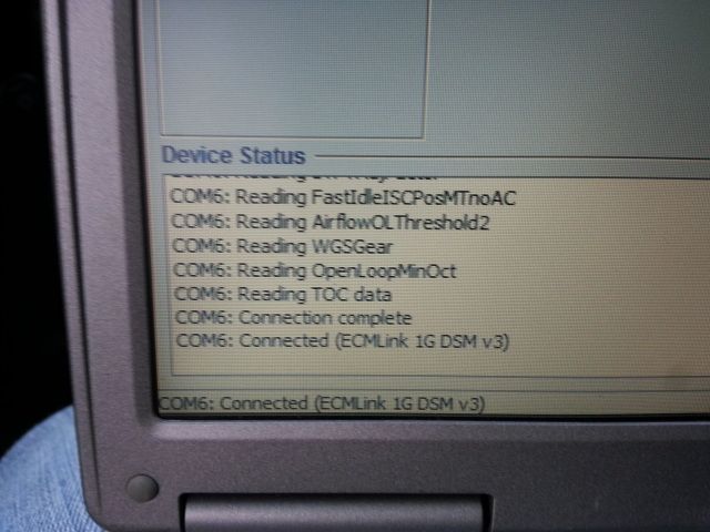

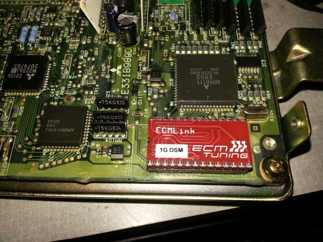

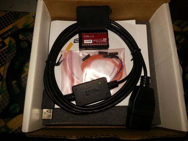

ECMLink v3... /ubbthreads/images/graemlins/dunno.gif 3rd time? i would prefer to tune her on AEM, but my box is broken... someone come tune my car.

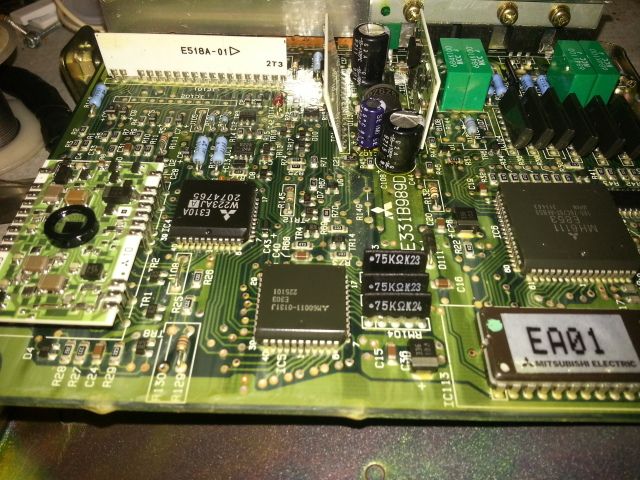

eprom ecu... still need to finish socketing it.

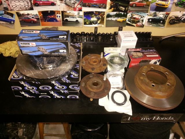

MORE PARTS!
thats my buddies work bench btw. mine is covered in misc H22/Honda parts at the moment.
Centric 5lug front rotors
Hawk HPS front pads
5lug front hubs (thanks coyotes)
new bearings and inner/outer seals
freshly turned 5lug rear rotors
Posi-Quiet rear pads
couple of oil filters from Mitsu cuz i had them on the phone.
i also tried cleaning up the rear diff...isnt show quality shiny, just less dirty.
so i need to order some fresh oils for tcase/diff/trans... (engine only has 1000miles on its oil) i got some washers at work to seal those up. and waiting on my coilovers, and buddy to get some tires for his EVO so i can steal his wheels...

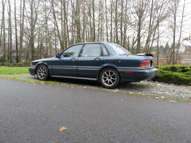

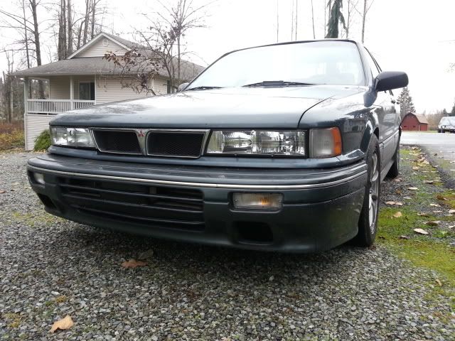

so i was thinking. i know what my Galant looks like, you guys might not.
this is most recent
took these right after i got my 93 headlights and fresh bumper markers.
there is a Spearco 2-216 (Indyracecore) hiding in there believe it or not.
engine bay is looking pretty shitty. still plan on doing some cleaning up under there. not in my parts pile, but i do have a nicer valve cover that i have plans for. the MAFT is going away, and might end up redoing the charge pipes, might just modify as needed, we will see how my plans of bigger power go.

I don't know what it is, but the USDM front bumpers look a million times better when they are uncut, IMO. Good job not hacking it all up.
I need to find a nice set of 93 headlights too, yours look great.

I agree that the US bumpers look good uncut, but damn is it an airflow block.

yeah. I was super happy to find those 93 headlight. feel they help the look of the car.
I don't like the look of the cut US bumper either. but I would like to get some more air to that 2-216. I would like to try to cut out just the black horizontal areas. but not sure how it would look when done, or if I have a steady enough hand for it.

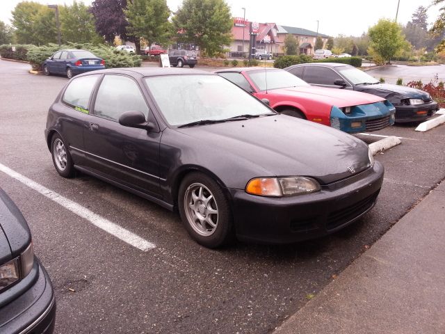

I did the same on the Integra.
I don't really care to hack up the bumper. maybe its cuz I feel its hacked? or I don't care about the going factor anymore? first couple projects back when I was 18-20yo I cut some bumpers. thinking I'm at cut 2, uncut 6, plus one just didn't have an intercooler lol.

I've seen this tried, and it never seems to turn out well. The problem is, those small horizontal areas provide structural support for the slats in the bumper. If you cut them out, the slats sag and look like sh*t. At that point, you should probably just cut them out completely.
I'd bet even with the bumper completely uncut, it flows pretty well. Of course, not as well as a completely cut bumper, but there is a good amount of air moving through there.

I don't mind the cut bumper, but the edges need further modificaiton in order to look right. I am going to take mine off and clean it up later this season.

ok, so i finished socketing my EPROM ECU... what a bitch. ECU was covered in this coating sh*t. and i HATE removing factory eproms from boards. my baller Weller soldering station is doing odd things? tip is getting hot, but not really melting solder. had to finish with junk/spare radioshack special.
installed
then i zero'ed out the MAFT (important step lol)
success!!! /ubbthreads/images/graemlins/grin.gif

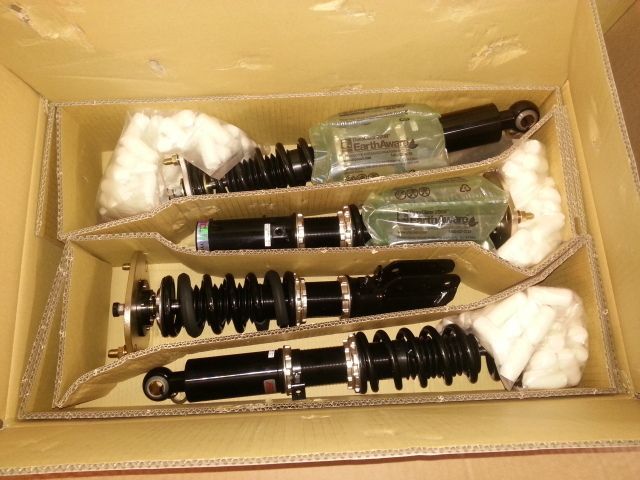

I was so excited did a little unboxing on my desk at work. boss was blabbing about some sh*t, wasn't paying attention, i was on lunch :p
fresh new set of BC Racing coilovers thanks to our very own bobdole. also got my Hawk brakes from him.
I'll have some more pics and a review of some kind once I get them installed.

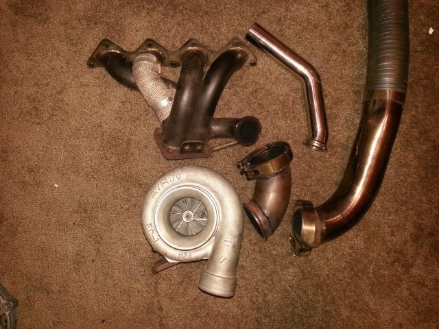

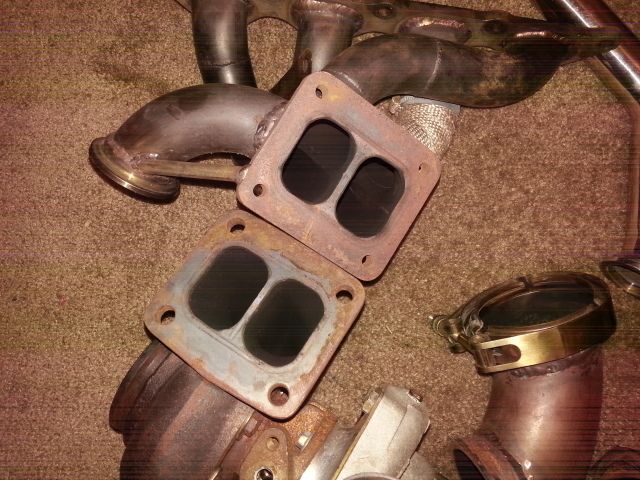

Magnus divided T4 manifold w/44 v-band
T67 T4 .84 P-trim divided turbine
V-band O2
V-band downpipe (probably gonna cut this up)
dump tune for v-band 44mm wastegate
yup, just keep dumping money into this car... see whats up with the evo8 wheels again this week, if i get those any time soon, i wont be touching the turbo stuff for a while. still want evo9 wheels though... /ubbthreads/images/graemlins/banghead.gif
