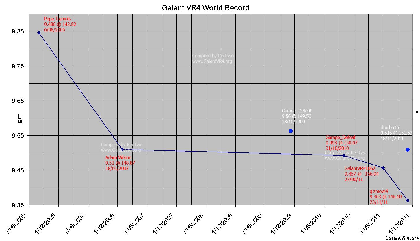

Quoting RedTwo:
I think things are getting a little out of hand. I doubt it's comprehensive, but there seems to be the beginnings of a pattern. A VR4 arms race if you will /ubbthreads/images/graemlins/devil.gif
AWESOME GRAPH. /ubbthreads/images/graemlins/worthy.gif
I hope the other guys all put some time and effort in this winter to catch up and we have a great 2012 season of the record changing hands over and over. There are like 4-5 cars all within a few tenths, this could be super fun and motivating if everyone stays interested. The record doesn't really mean much when none else is trying for it.
