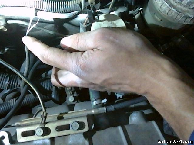

i got 2 open wires that look like they end near the iac right under intake mani, looks like sauder and both look black in coler with a heat fabric around them. i have noi idea whedre these go( maybe knock sensor??? any help is apprecitad?

found that the wires lead to the connecter on metal bracket that is right next to the knock sensor connector. annyone know what that connector goes to?

A similar post was made recently, they're for the EGR temp probe.

I think you mean EGR, but unless I am wrong, 91s don't have that connector.

Doh you are correct, EGR temp probe.
FWIW 86/2000 had the wire/connector as it was a CA smog model.
