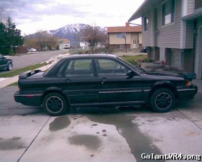

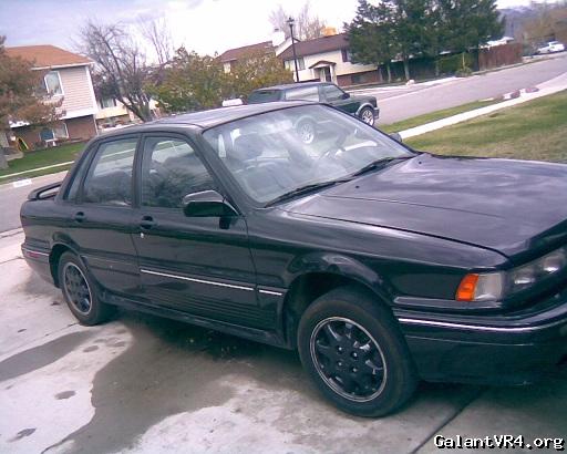

I picked this car up last month, It is mint with the exception of missing the passenger door moulding, and small ding on the fender, the previous owner had parked it 6 months prior due to a bad water pump? It has no rust and it looks like brand new, pefect seats, headliner, everything. This will be my second vr4, I sold 1807/2000 last oct when I lost my job and have wanted to get back in the game since.
This is what I started with

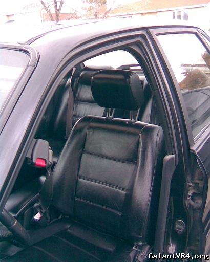

interior is perfect
the wheels are terrible

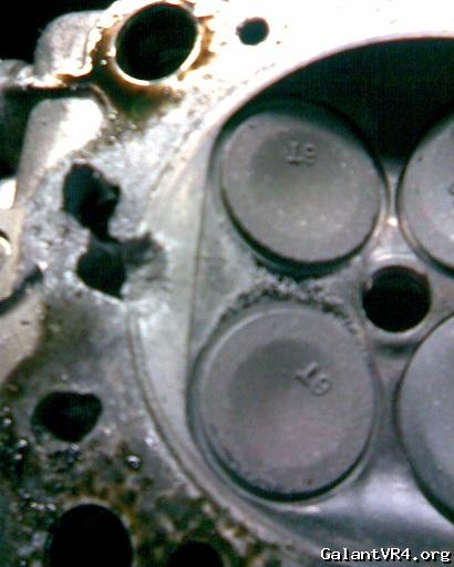

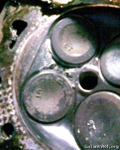

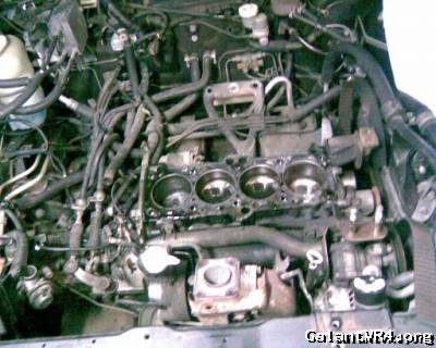

The third owner/previous owner fried the motor,someone installed a mbc, left a few open vacuum lines, curbed the hell out of one of the rims, and completely melted the engine down. He thought it needed a water pump and parked it. This is what the head looked like.

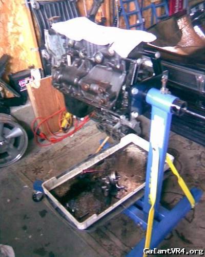

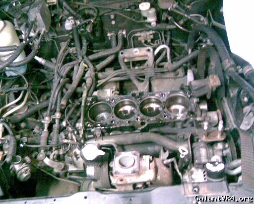

I was hoping to do a water pump, t-belt and have a driver, nope the idiot tryed to fix this with stop leak!. The piston walls have a few deep scratches, so out comes the motor.

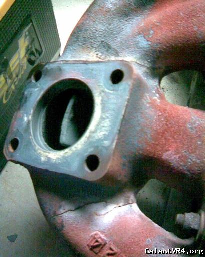

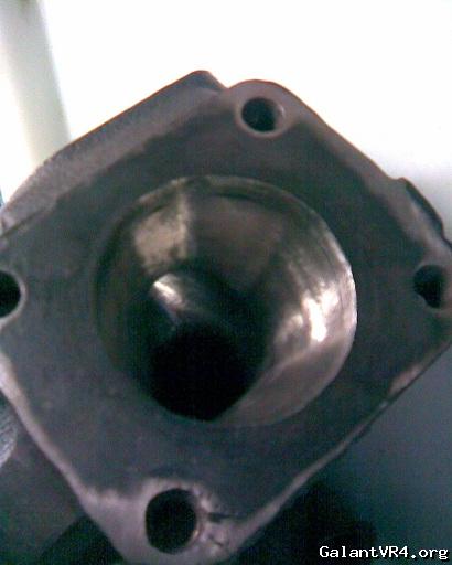

Look at the manifold it has four large cracks, he must have drove till it stopped.
asmo
Jun 28, 2009
87
SLC, Ut

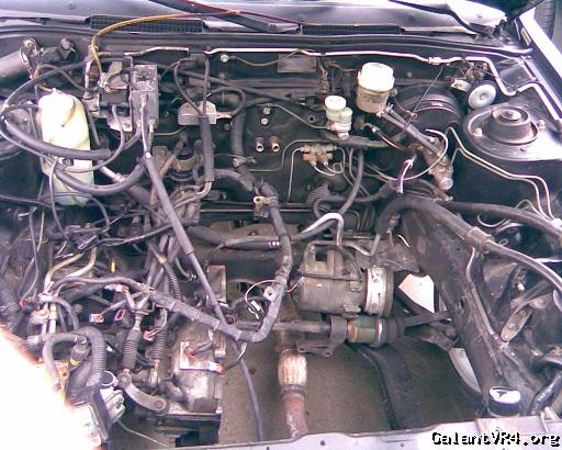

Pulled the motor out last weekend.
Cleaning and degreasing. The cas was leaking some, but engine was fairly clean.

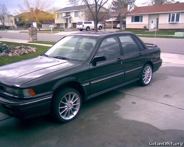

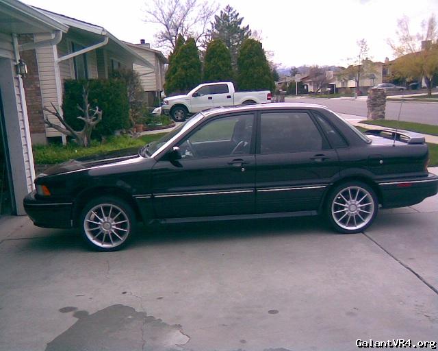

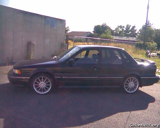

Last month I Bought theese 17" wheels off the local e-classifieds, great summer wheels.
I will refinish the stock wheels before winter.
And Tinted the back windows. Ill do the fronts after inspections /ubbthreads/images/graemlins/wink.gif

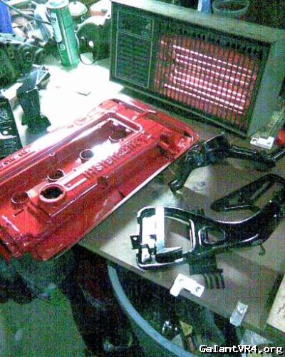

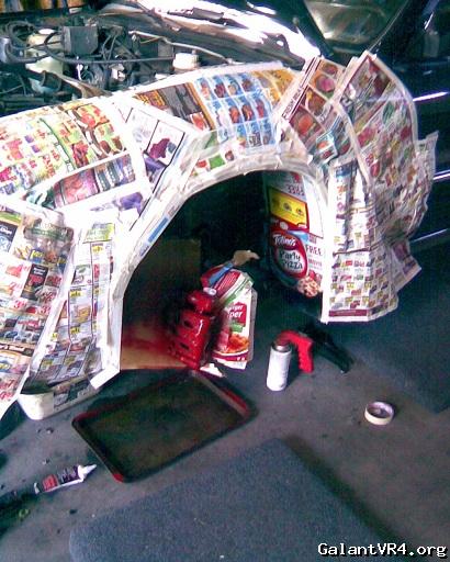

Painted the front calipers red,

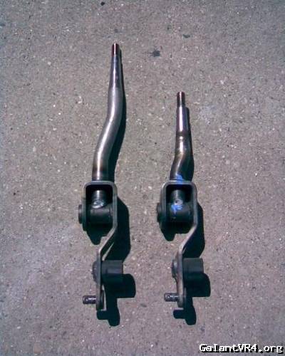

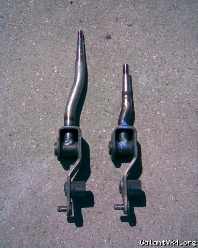

Got a dsm shifter from the junk yard.

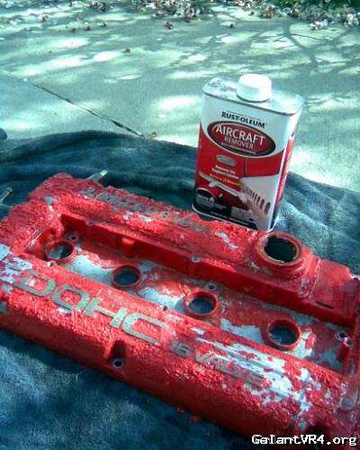

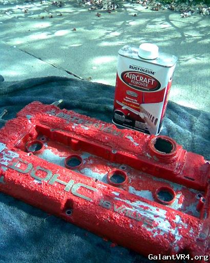

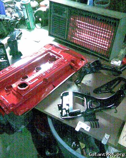

striped the paint off the valve cover.
waiting for the parts to dry.

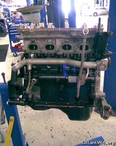

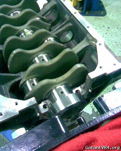

And got all the parts to put the engine back together, its now Bored 20 over, polished crank and standard bearings, etc.

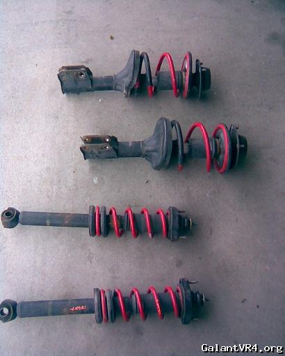

Got evo struts with sprint lowering springs from local part out.

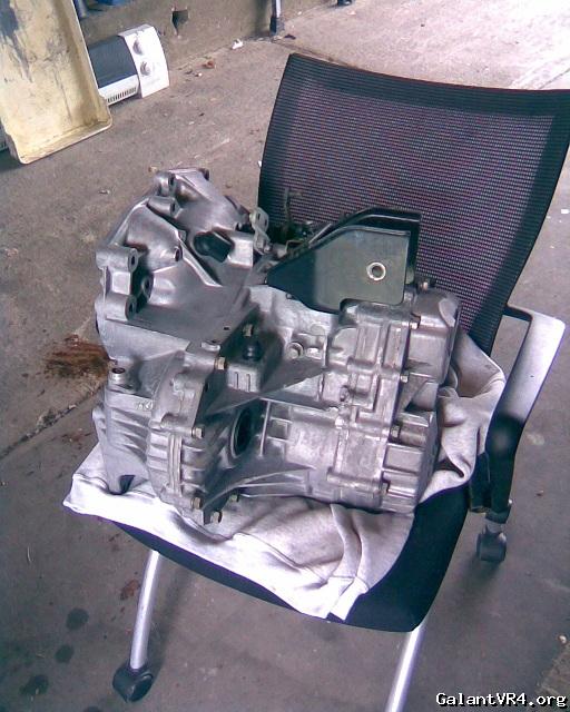

Degreased/cleaned the trans.
Painted the block and bolted on the head.
Its all starting to come together now.

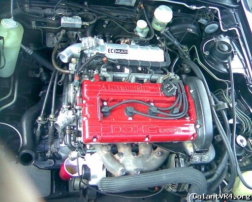

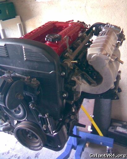

few updates got the engine together,

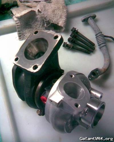

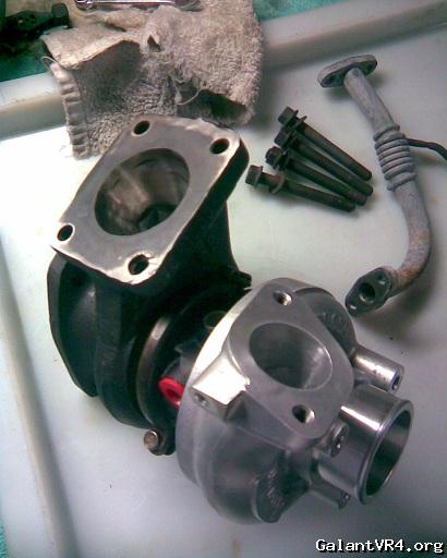

Ported the 14b turbine,
Rebuilt the turbo,
got it all bolted back together.

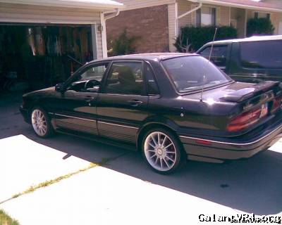

Finally got it all back together, The ride is great with the evo struts and swift lowering springs.

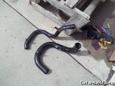

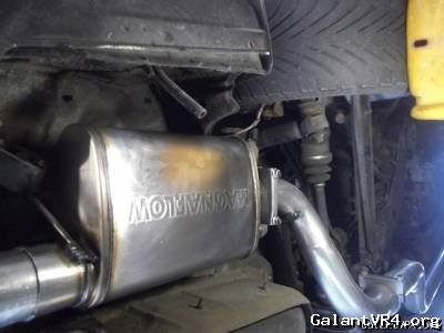

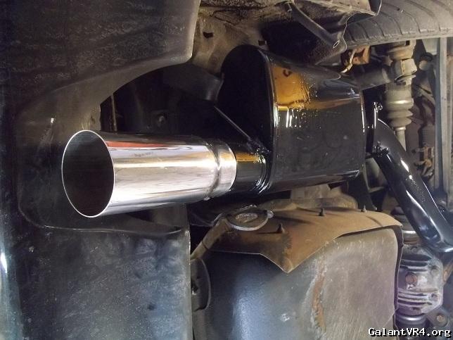

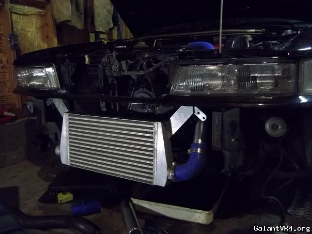

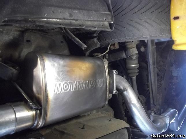

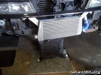

over the last year I added- downpipe, 3"exhaust, bigger fmic, redid hot side piping to 2" but still bottle necks after cooler. fmic is a smaller one only 2.5 thick and barely fits behind the bumper.I didnt want to cut the bumper support.
Have the car down for upgrades so thought Id update this post
Going for 260-280hp
I want a fun daily and plan to try to do a little autocrossing
Ill be adding
2g Exhaust manifold, 2g maf, 560cc evo injectors, keydiver chip, evo9 fuel pump,
bigger intercooler cooler piping.

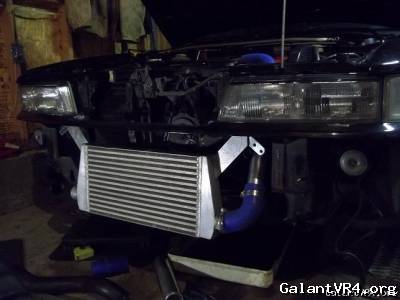

here are a few pics of exhaust and fmic.
asmo
Jun 28, 2009
87
SLC, Ut

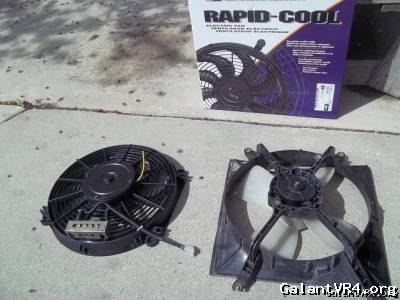

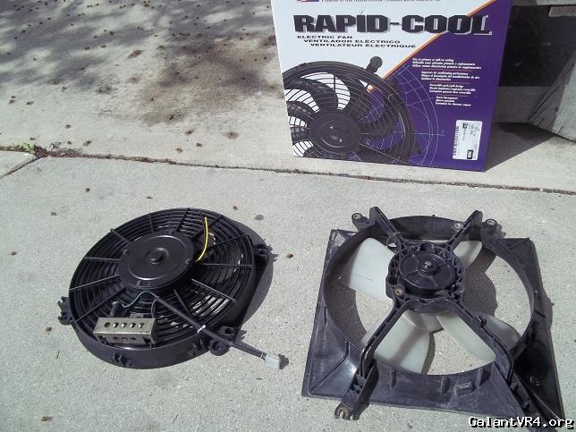

Had to get a 14" hayden fan to fit the 2g intake pipe

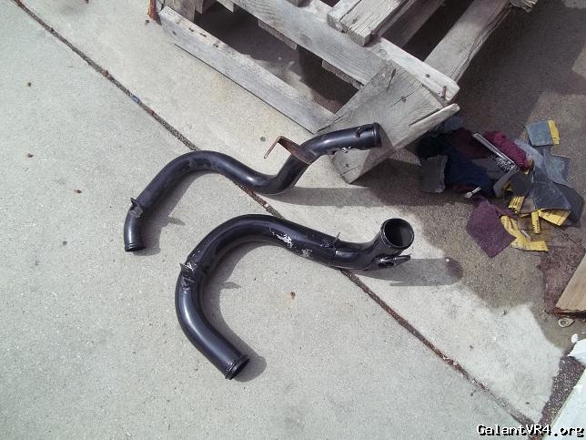

Intercooler piping my friend welded up for me

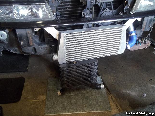

The stock cooler next to mine
not as big as some here have, but should be enough to support my build.
