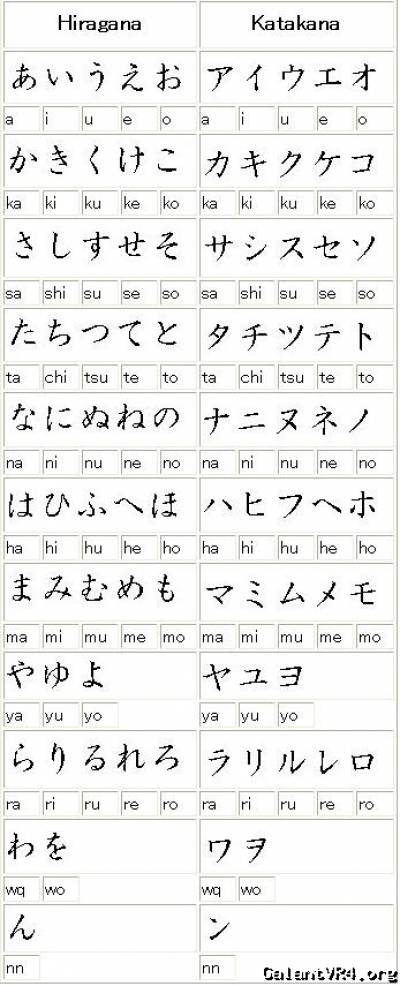

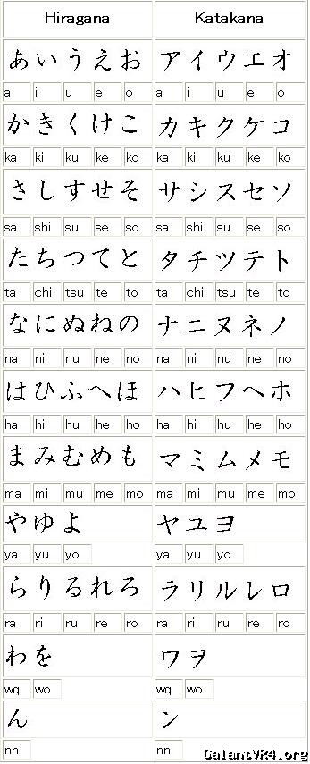

Generally, if the character is fairly complex it's kanji, if its a simpler beast it'll be katakana (the 42 character alphabet adopted for foreigh sounds and words)
Translating the katakana from my Honda Bros wiring diagram character by character gives a literal translation of "hetsudorito" for headlight.. hehe
here's the katakana and hiragana:
hiragana is used for simple expression of japanese words and doesn't so much appear in formal technical writing.
