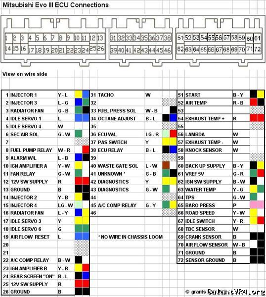

I found a pdf file earlier but couldn't get it to post.
I eventually found this image, and figured out how to post it.
What I really need is the actual engine wiring diagram, including the mfi relay.
Please. /ubbthreads/images/graemlins/smile.gif

Yup that is pretty much it, Jeez thanks for all the help toy breaker, last time i remember you helped me figure out my starter problems, and now your helping me with the ecu wiring. Whether we crack down this problem or not, i really appreciate your help!
We'll get you spoolin' soon enough. /ubbthreads/images/graemlins/smile.gif
Thing is, I don't want to give you bad advice, so I really need that full diagram so we can figure out some valid test points and a logical strategy.
I hate "guessing" /ubbthreads/images/graemlins/frown.gif

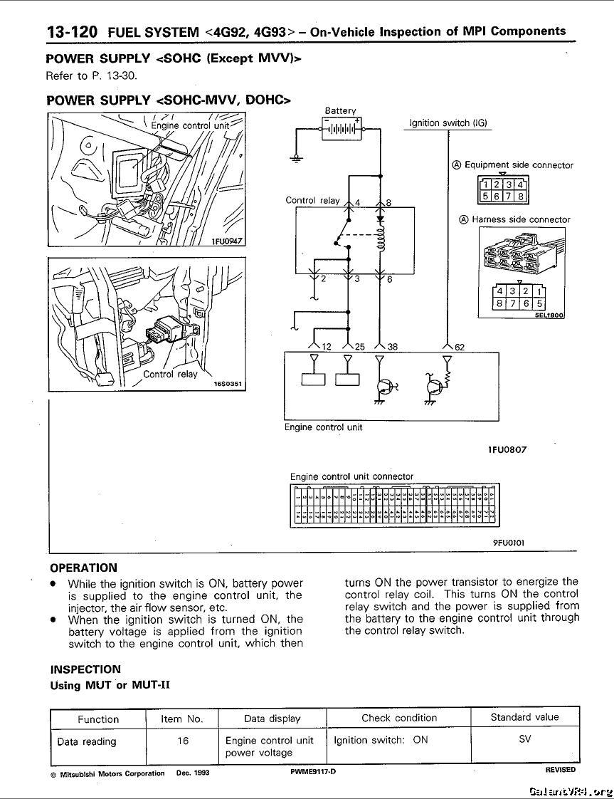

Fair enough. Can you post a diagram of the 8-pin mpi relay? As far as i know 1g had the same i think? If we could see the details of the relay, i could check my cars wiring and see how much actually matches. That way we would know at least what is done right and what needs to be corrected. Till then hopefully we would get the evo wiring diagram and see how is it supposed to be done.
And well my cars wiring has been done on guesses, but those were bad ones, at least we know that 12v for pin62 and 12volt for pin#4 and pin#8 on mpi relay is sufficient to run the car. Oh well its morning here, and i am off to work now, i will read some evo forums at work and if i get some details, will post it up here.

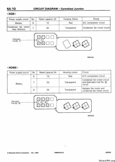

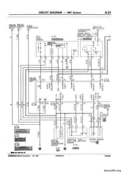

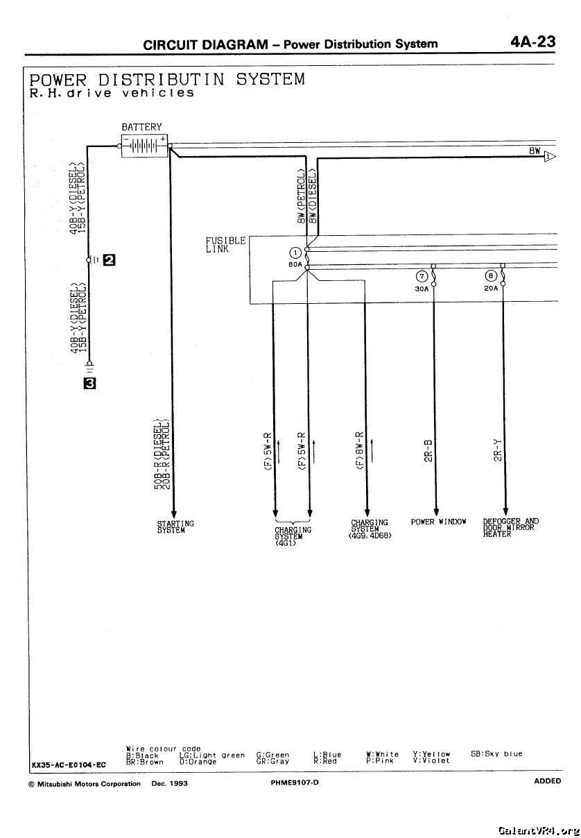

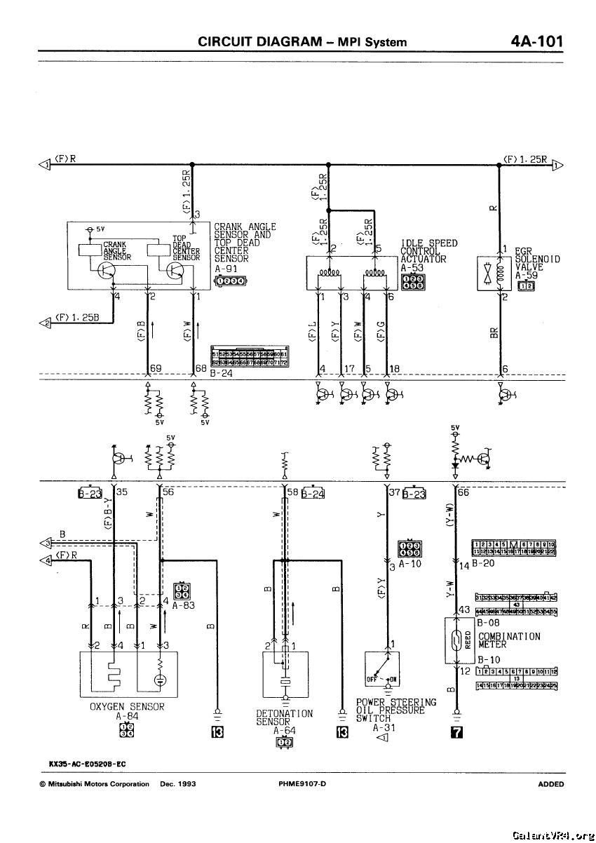

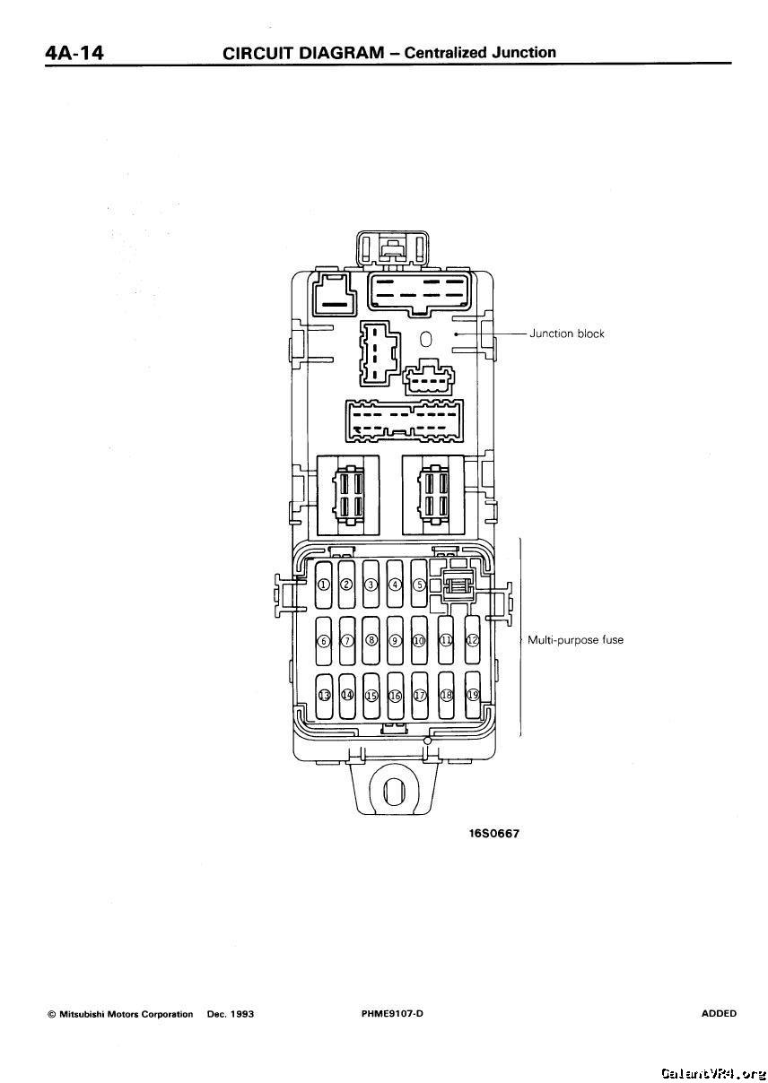

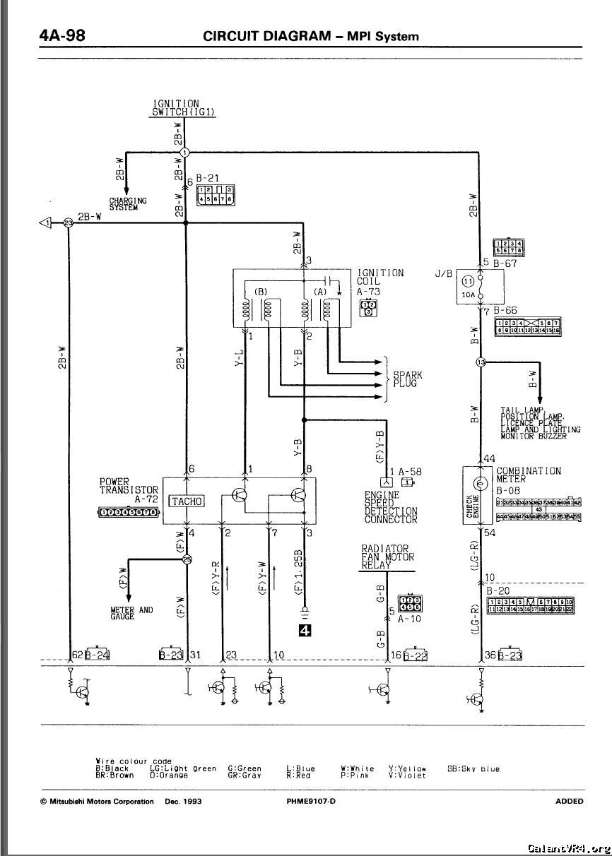

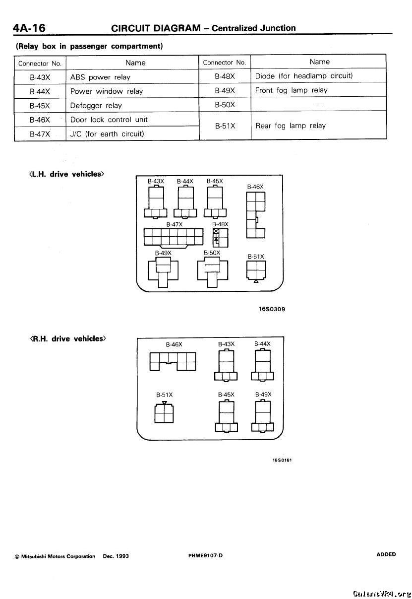

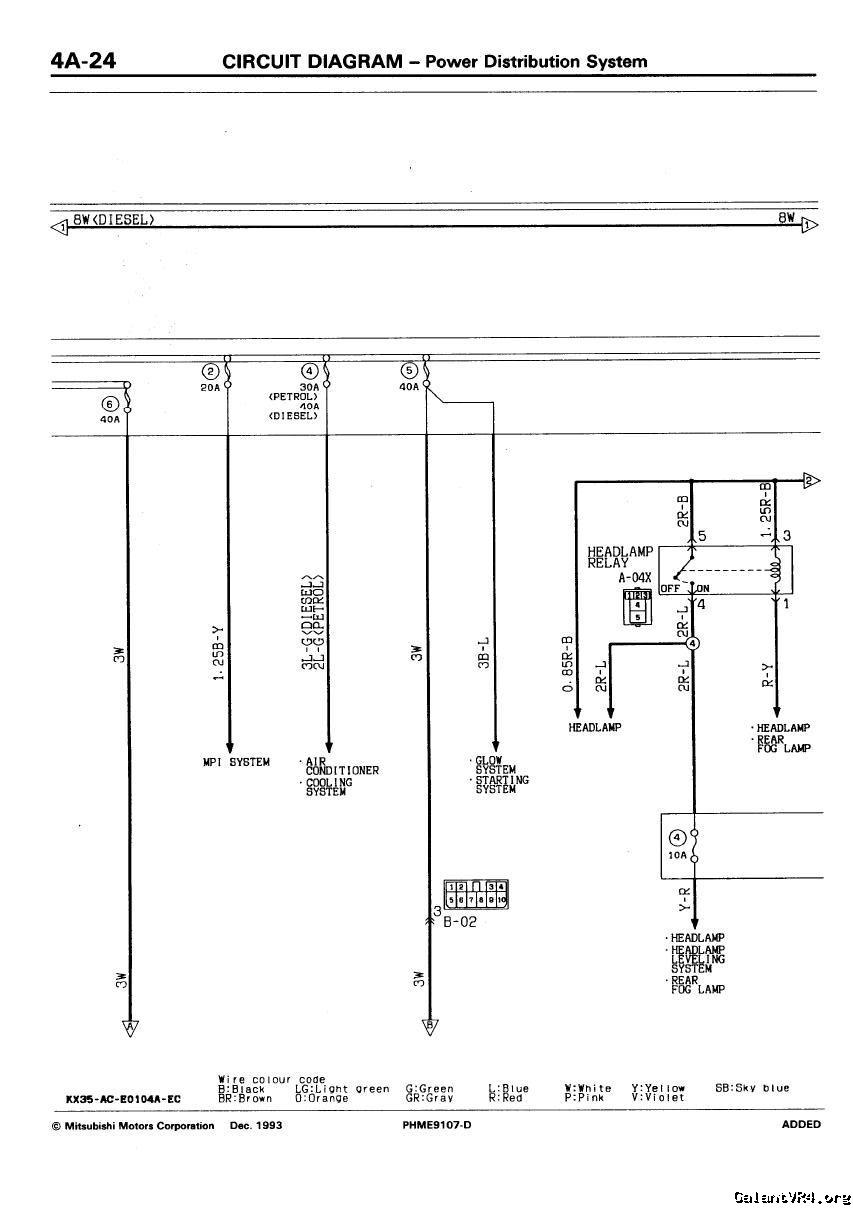

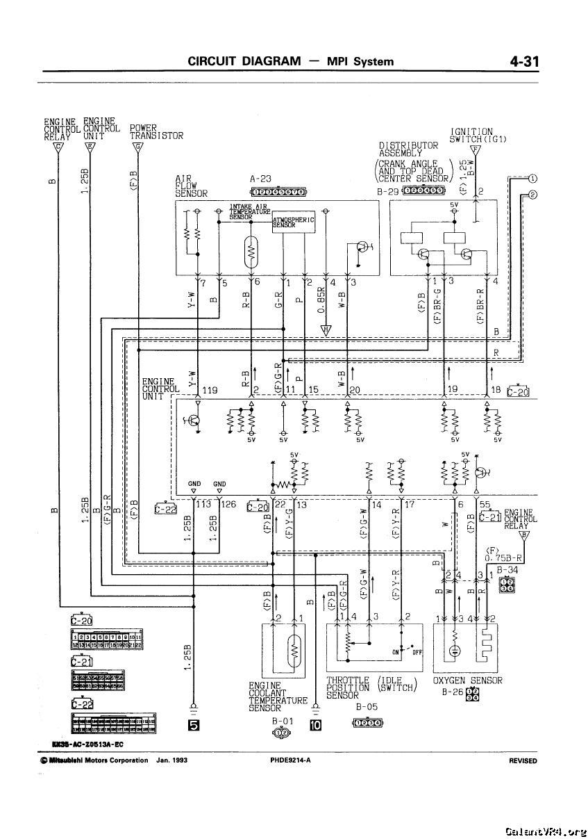

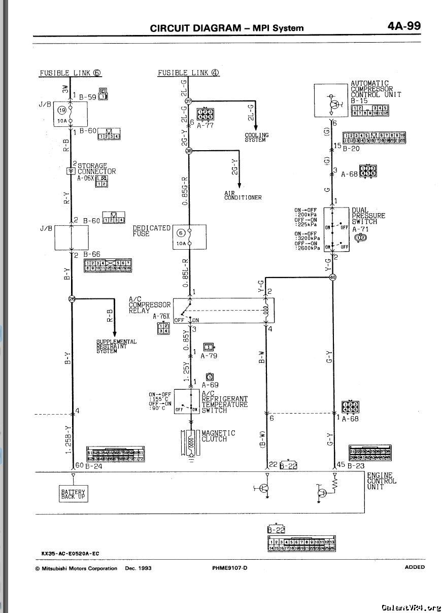

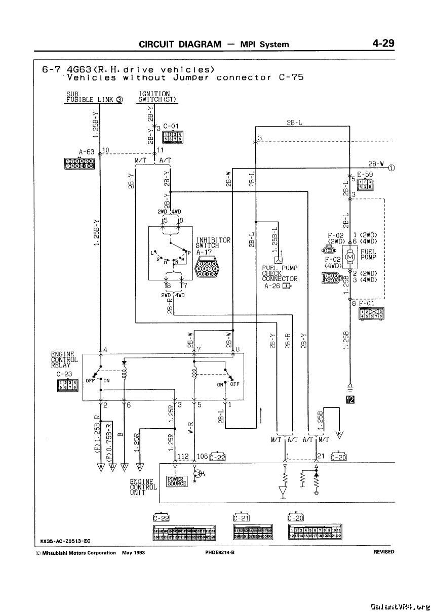

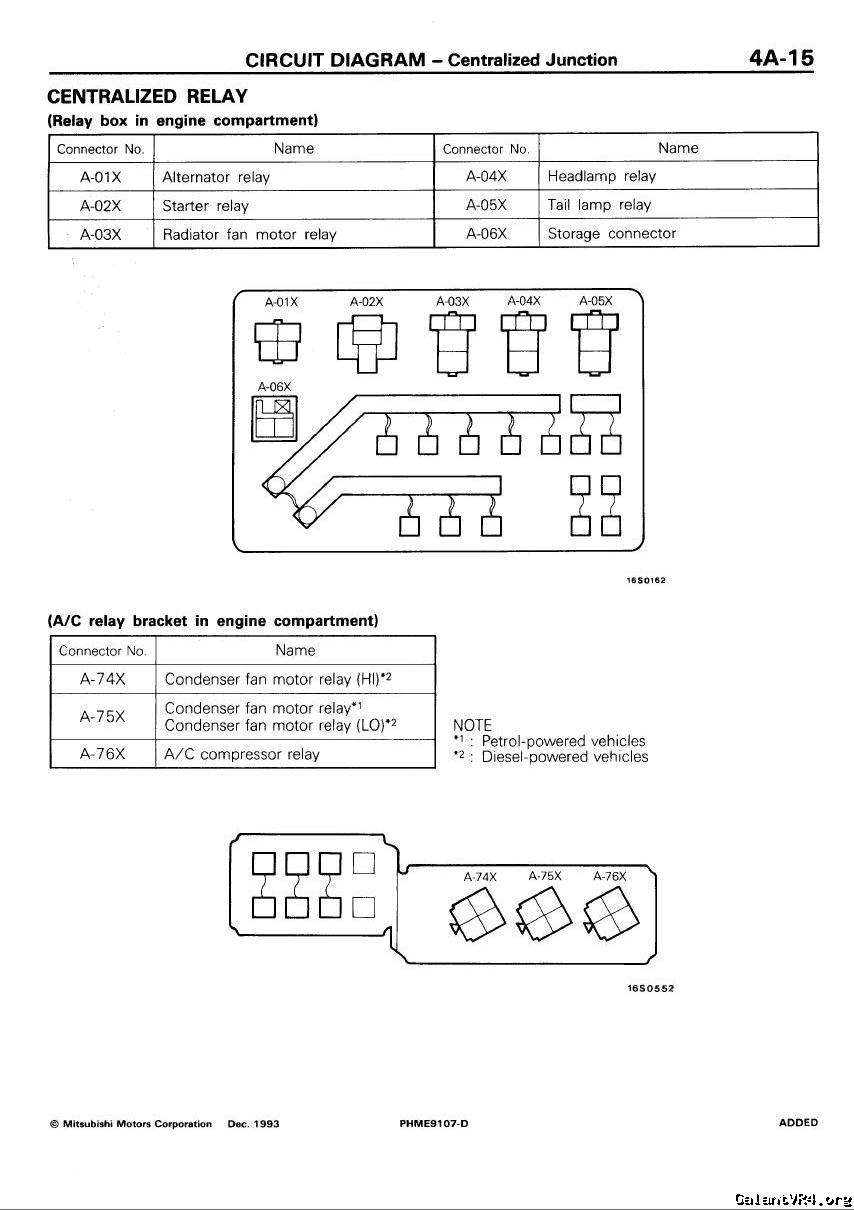

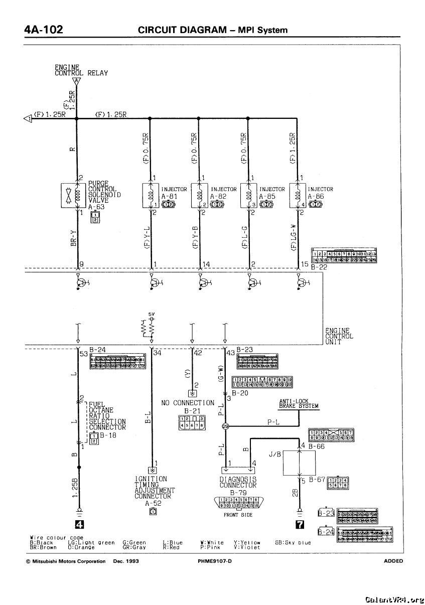

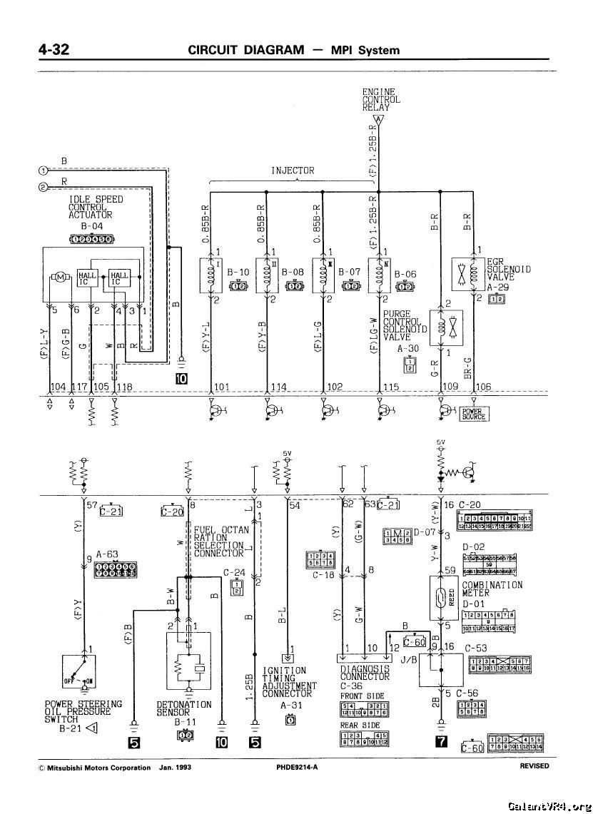

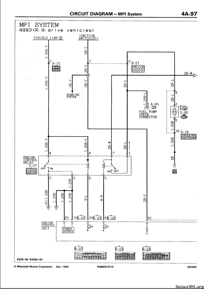

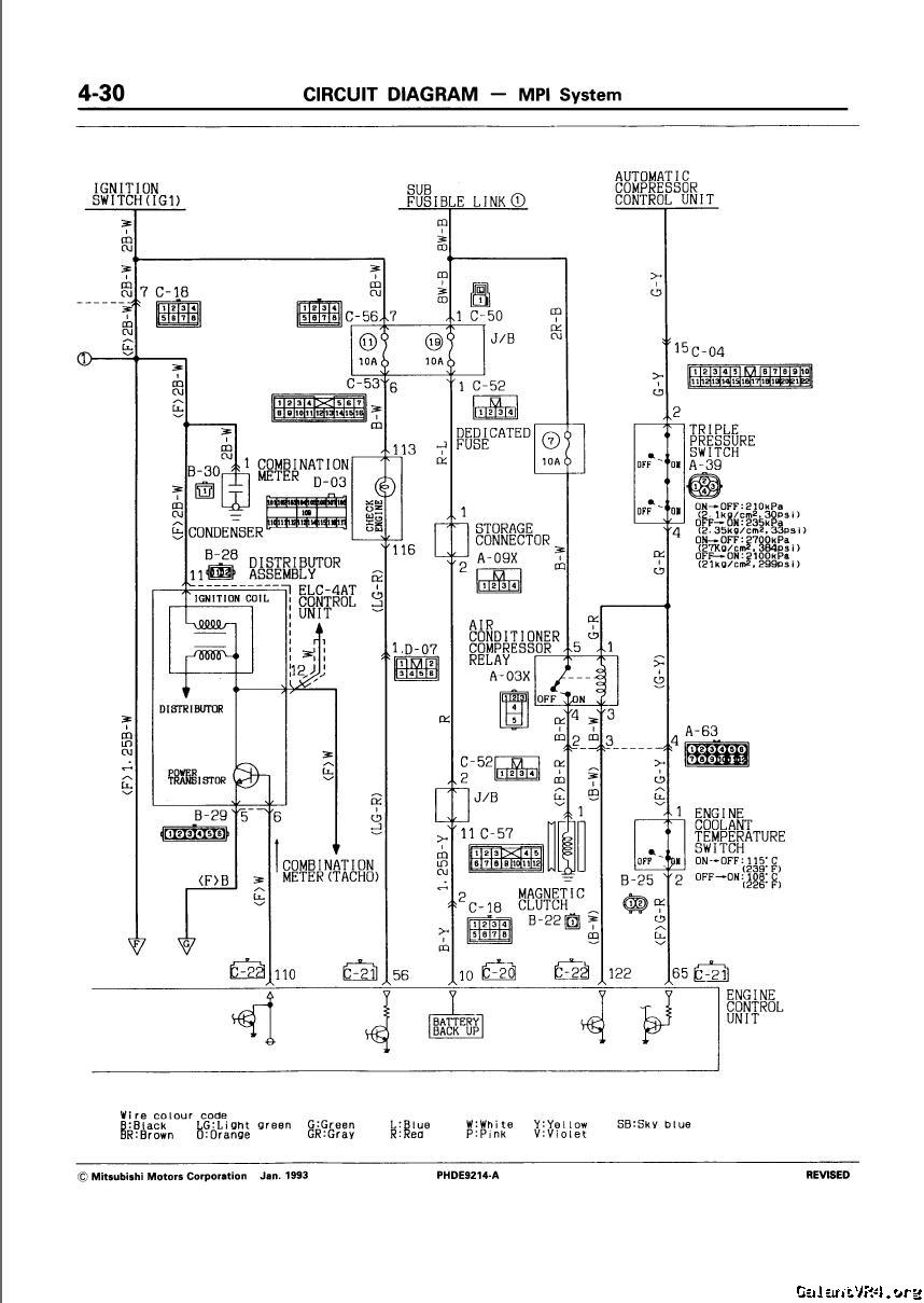

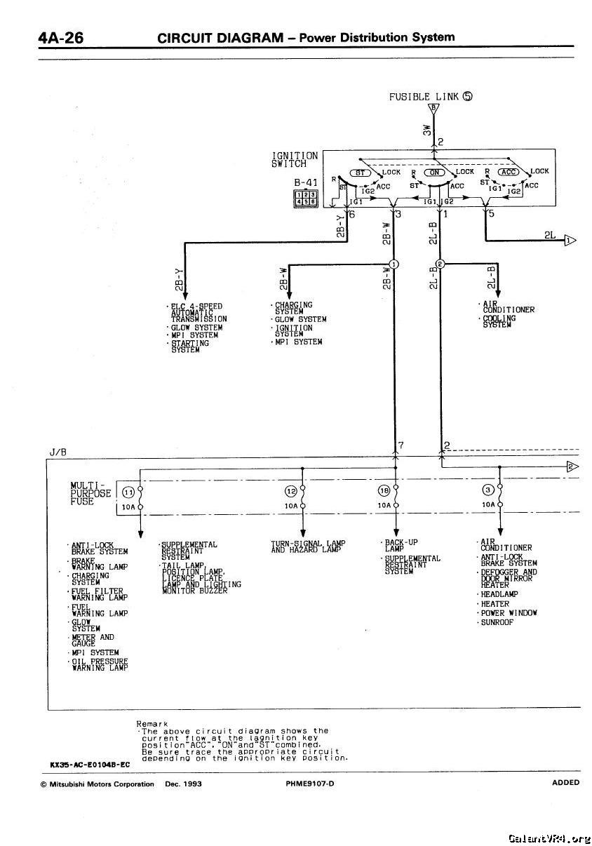

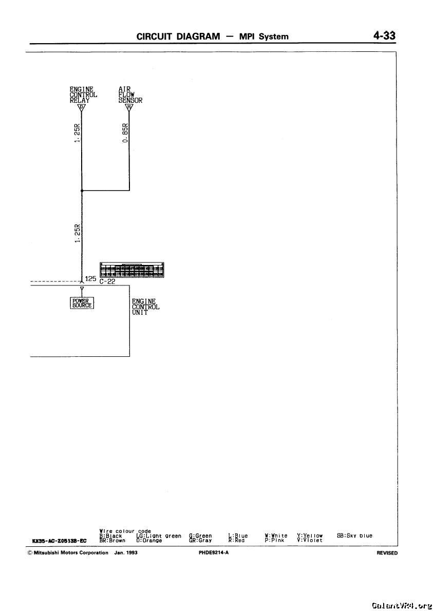

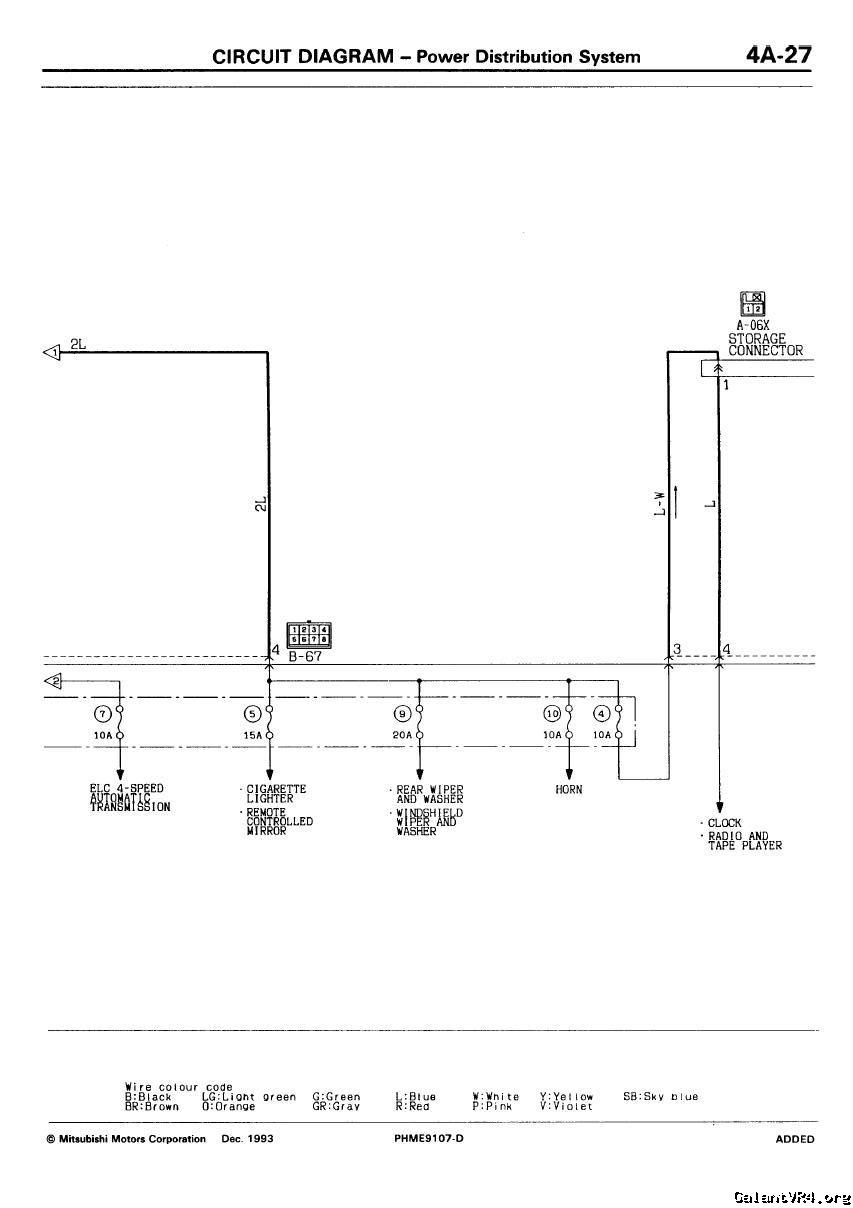

1,610

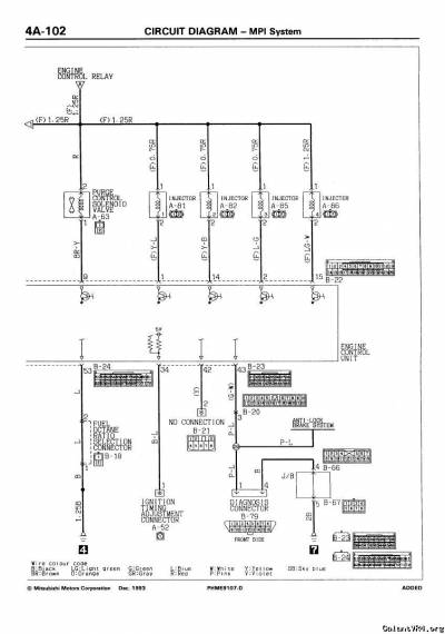

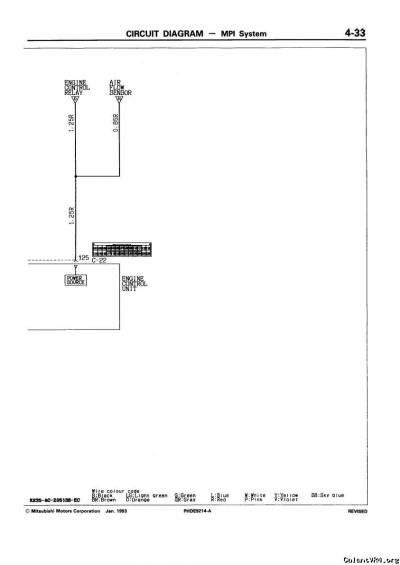

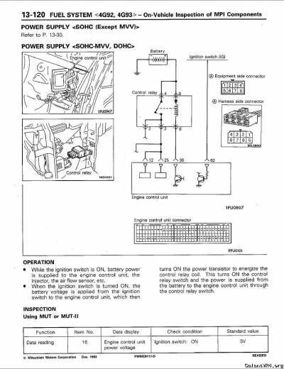

**added CD4a wiring diagram for 4g92.** (missing page 100 though)

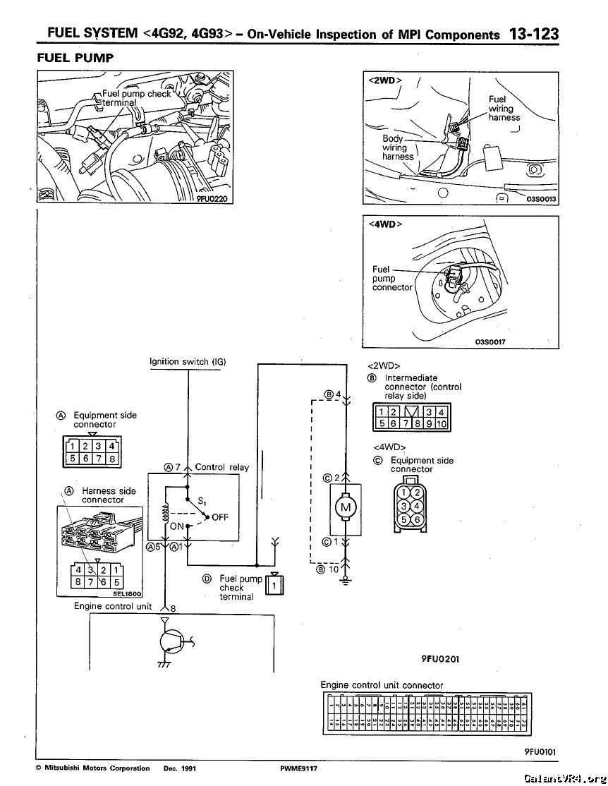

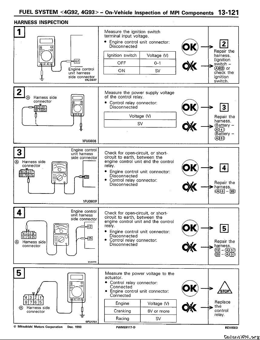

Specter, Toybreaker pmed me at the same time as me perusing this thread. I have many manuals, but the evo III is one i do not have complete coverage of. I do however have the chassis manuals for that generation lancer. in europe we got 4g13 and 4g92/4g93. Mitsubishi do tend to keep families of injection systems together. So here are the pages of the fuel section to cover the mpi relay and ecu supply/fuelpump supply (they do NOT have wire colours associated). I'll also post up the wiring from a 4g63 space runner (its sohc but the same ecu board as the lancer. I had to source one for a replacement for my sister in law's car in the philippines after the flooding). this has wire colours.
CD lancer (dohc 4g93 manual)
4g63 sohc spacewagon wiring manual
cd4a lancer
I hope this helps.

Thanks a lot Rich. Those diagrams helped me a lot!
@ Telecaster : We were trying to figure out what are the connections on the MPI relay. Now what i am trying to figure out, from where do Pin #62 and Pin #60 gets it connection from, as well as the Pin #4 and Pin #8 on the relay.

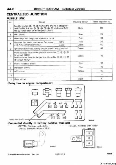

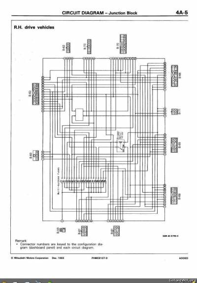

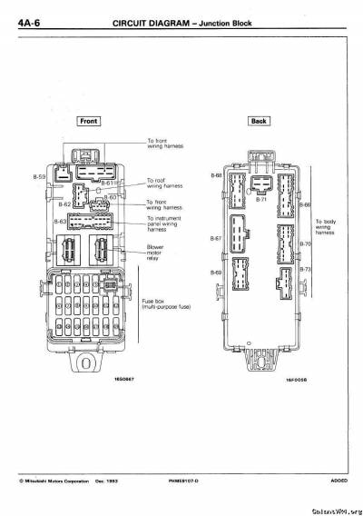

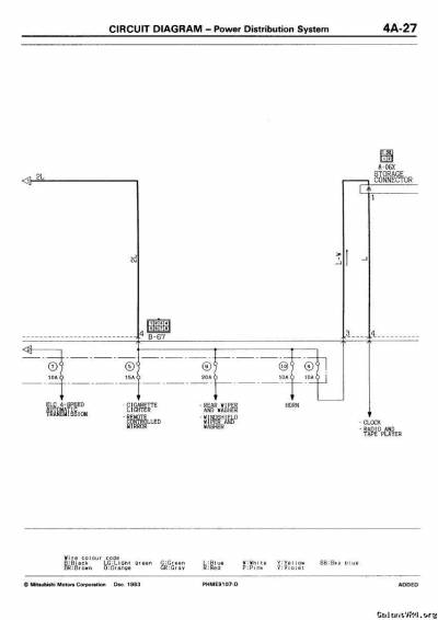

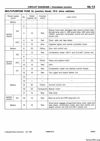

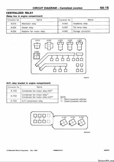

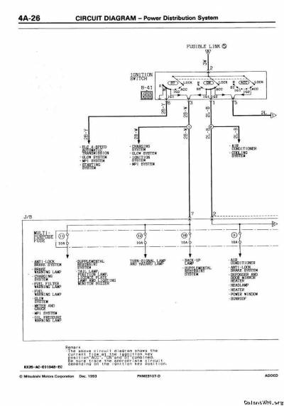

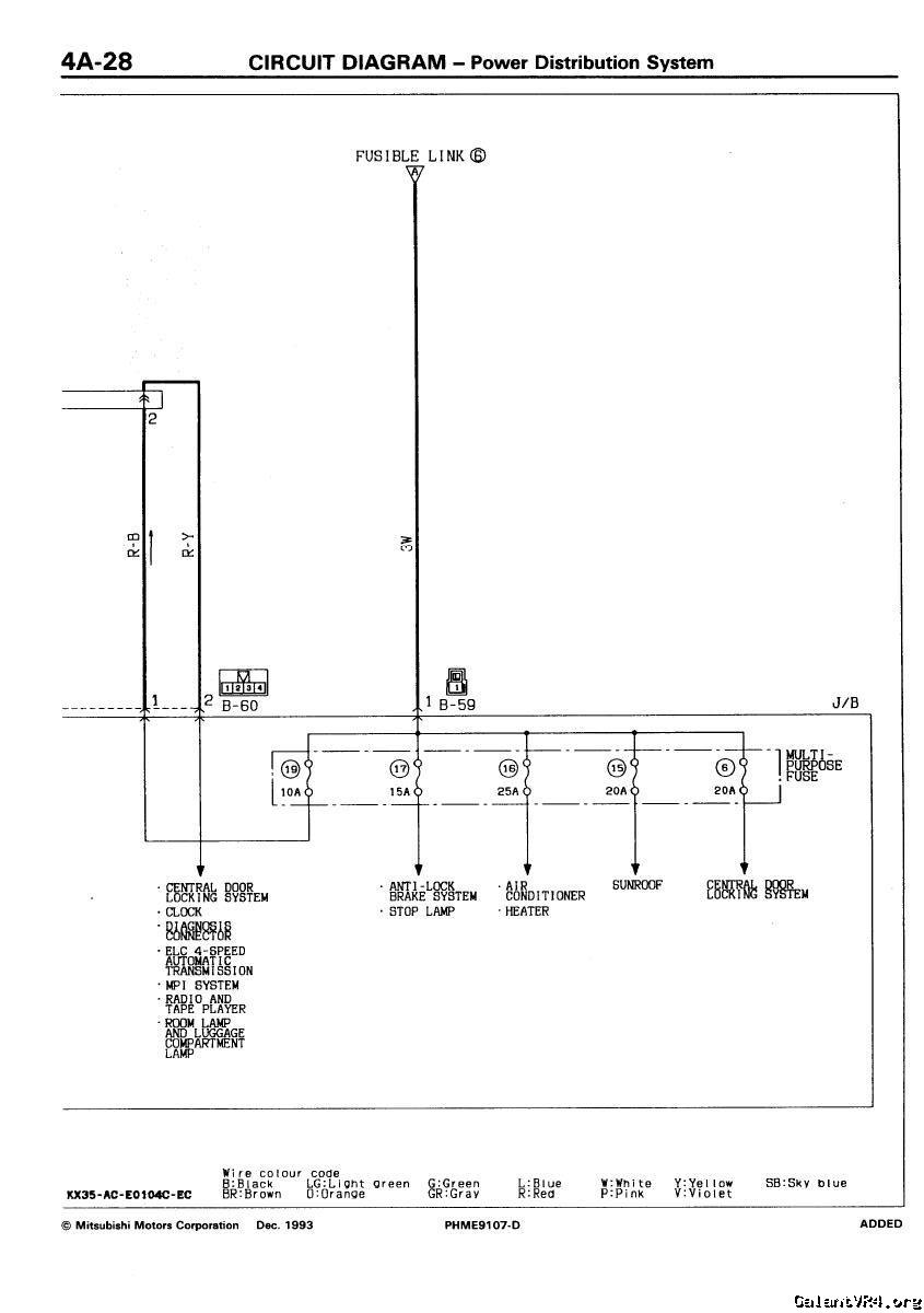

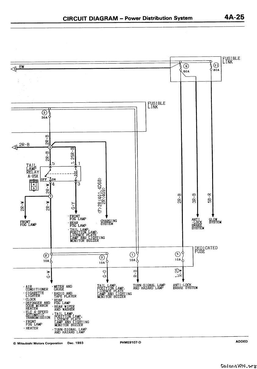

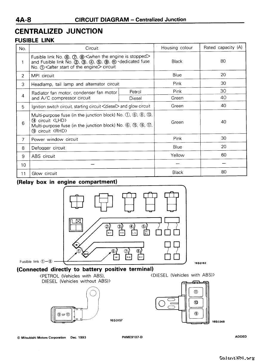

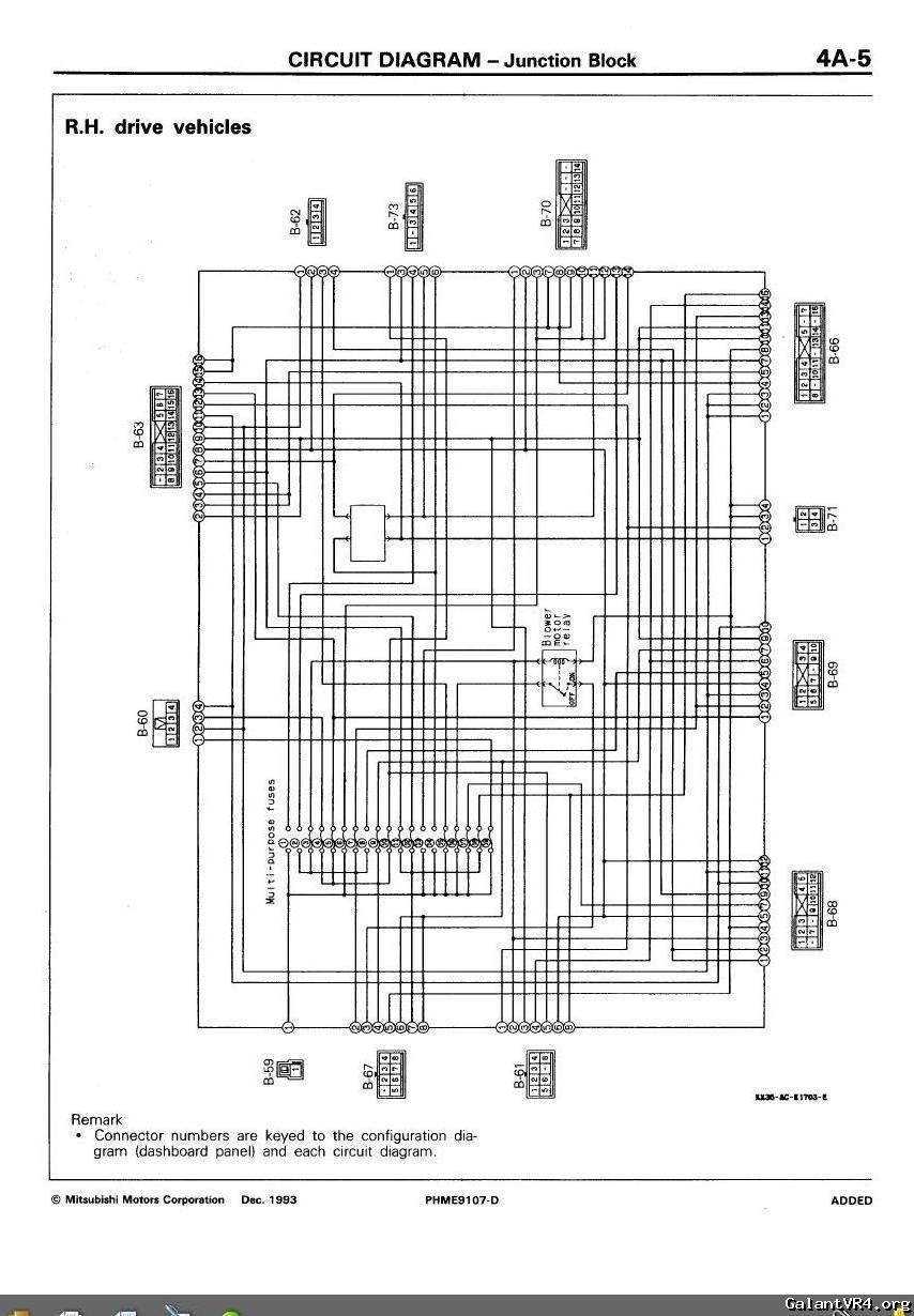

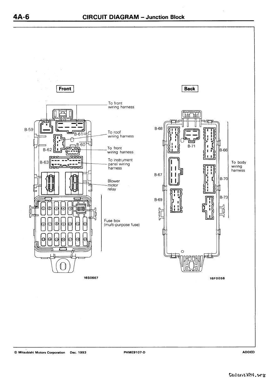

1,610
do you want the power supply routing diagram then? that'll show the feeds to pin 4 and 8 in the engine bay fuseboard, is the 60 is from the engine bay and 62 from the ignition switch block. If you need the power supply routing shout and i'll post it up.

Quoting misterfixit:
Yes Yes please kindly post those diagrams too, they will enable me lay new wires and make the connections factory spec.
Specter
Apr 20, 2008
367
Karachi, Pakistan
Thanks Rich! My car has started, thanks to your diagrams. /ubbthreads/images/graemlins/worthy.gif /ubbthreads/images/graemlins/worthy.gif /ubbthreads/images/graemlins/worthy.gif
