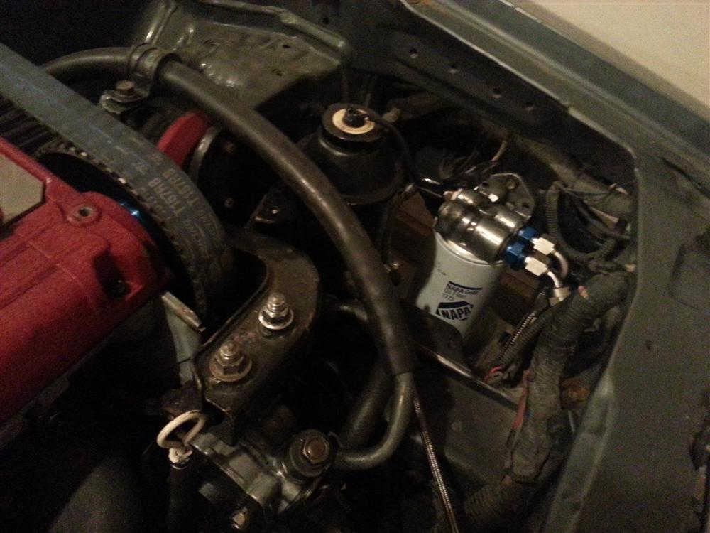

The final piece to the puzzle before the engine is good to go. Here is where I'm at
Last time I ran this engine, it was in my dsm, with a side exit and alt in the rear. Once I pinned the sandwich cooler bolt it worked great. Before that when it had exhaust to the rear, I had a mighty max forward facing OFH, which did not have a cooler. I did not like no cooler, and low oil pressures when hot. I also dont like sacrificing oil pressure all the time to run through a cooler on a bypass style, so if an external cooler is used Id like to use a thermostat. This is my first GVR4 build and with AC/FMIC I dont expect a lot of room to play with. Im wanting the most cost efficient way of making this work without adding a lot of stuff in the way. The options Ive played out in my head are-

I had a little clearance issue on my old 1G and ended up running a '90 OFH w/cooler but simply relocated the oil filter itself with this adapter, some lines, and this filter mount. That specific mount let me run a Ford Mustang (large 3001 style) filter though you could get one to suit the M20x1.5mm threads a mitsu filter uses. Alternatively, on my current build I'm running the forward facing oil filter housing with a Greddy thermostatic oil filter/adapter block p/n 12401126 so that it gets the filter out of the way, but still runs the lines to an air/air oil cooler. Note that this particular housing also has a built in thermostat etc.

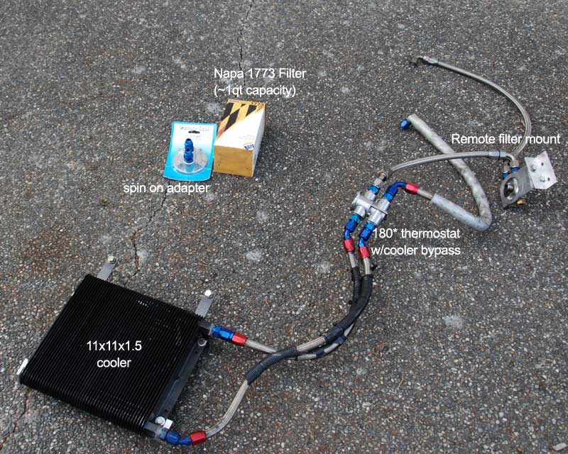

I'm running a FFOFH because of fitment, and I will never, ever run a sandwich cooler on a car ever again, even pinned/etc. Too risky to me.
Add on top of that that the water/oil cooler from the factory was to address oil temps not getting hot fast enough in the 90 cars, and our issues are more around thermal load/capacity (let's add more load to an already overtaxed cooling system, hooray!) oil to air is the only thing worth considering. I will run NO oil cooler before I waste my time with a sandwich again, but then I don't see any reason to have a heat exchanger medium that cannot cool below 200*f when I want my oil to run ~180*F
I will admit that my oil cooler size has caused me some issues so I'm going to switch out for a smaller setrab and move it into the area behind what would be a front brake duct in the jdm bumper.
I will say that I love this setup because with the FFOFH you can't feed from the housing (typically) and I wanted to avoid using the head feed. My adapter runs the send to the remote filter which sends clean output to the turbo & thermostat, the thermostat loops to the cooler, and under 180* will bypass 90% of flow back to the housing.
I like having the remote filter partly because it gets it away from the heat, and adds capacity (the filter I'm running holds nearly a quart) which can't hurt. the external thermostat isn't perfect, but i had issues fitting my downpipe even with the spin on adapater & AN lines (originally mocked up with an NT filter housing).
Anyway, YMMV.
