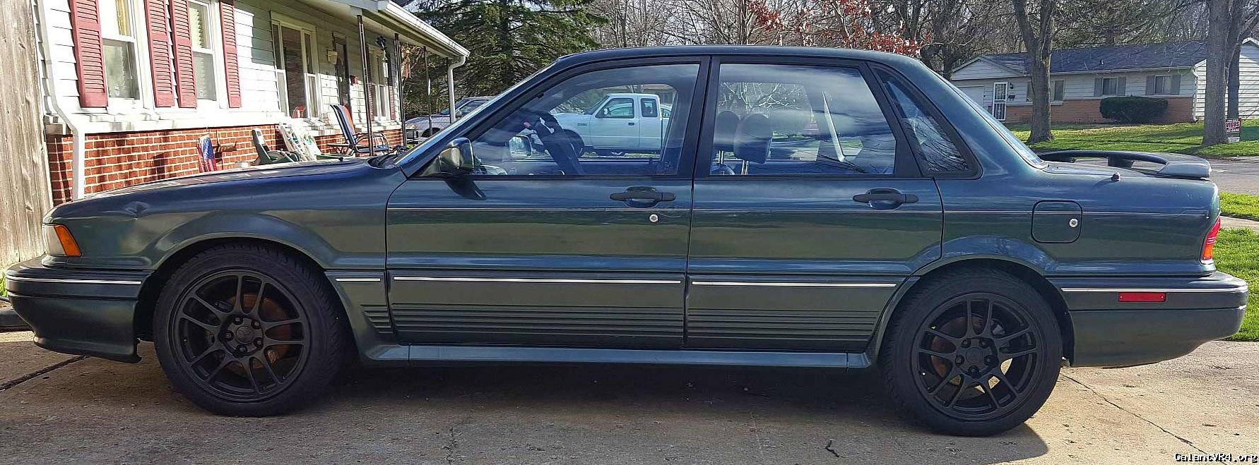

Even that is low depending on how much you want to deal with for stick out. I have +42 8" wheels, but I wanted to keep them fairly tucked (which means watch control arm clearance).

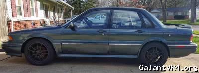

17x8 +35 with 17 235 45 tires.

That picture shows me how far I pulled my fenders. The 17x9 35mm (minus a 5mm spacer in the rear) wheels I just picked up fit about the same in the fenders with the same size tire.

I run 17x8 35 offset EVO IX wheels with 225/45r17 tires with no rubbing issues with about a 1.5: drop up front. With the 5mm spacers in the rear, the tires are pushed right out to the edges and fill nicely without having to roll the fenders.

There is a lip/ridge in the rear right arch on my car that is not on the left left hand side. Kind of annoying its preventing me from making rear wheels flush.
