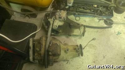

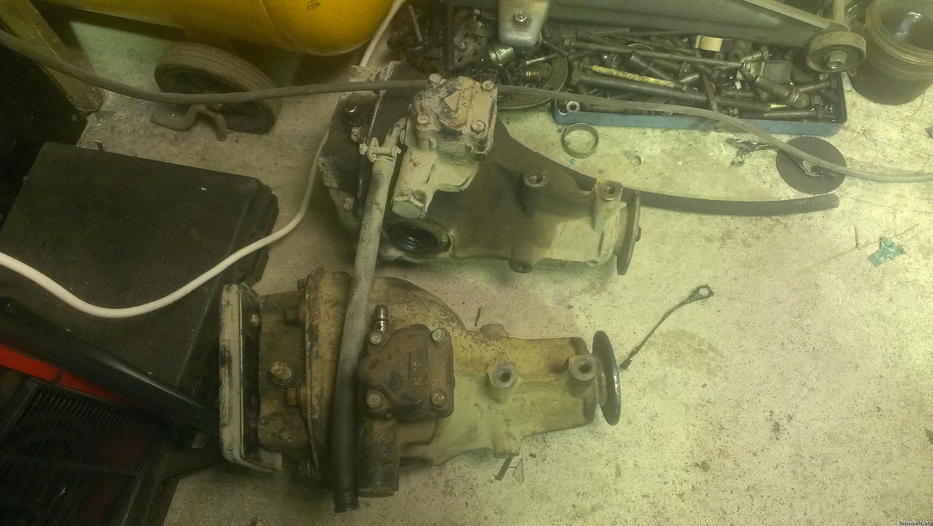

I'm looking for 2 years for LSD rear drive gear. Now I have a set of drives and 2 rear LSD gearbox.
That's why decided to try to find the front LSD differential.
I know that on the MMC Galant E38A (2000DOHC-MPI/4WD,[SNPF4] VR-4 RS,5FM/T) was LSD front diff, but it only puts on cars with manual transmission. Partnamber LSD lock MD 738 900

FlyingEagle is correct with the FWD, but all AWD differentials all had the same spline, only difference like your picture shows, is the factory viscous style has the extra nub to engage the Viscous. I'm not sure if any Evolution's had the viscous, but their diff is the same fit as long as you match up final drive ratio. You could look for a mechanical front LSD from an early Evo, and they work much better.
