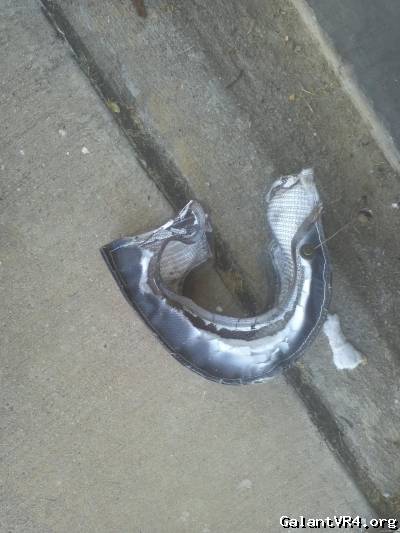

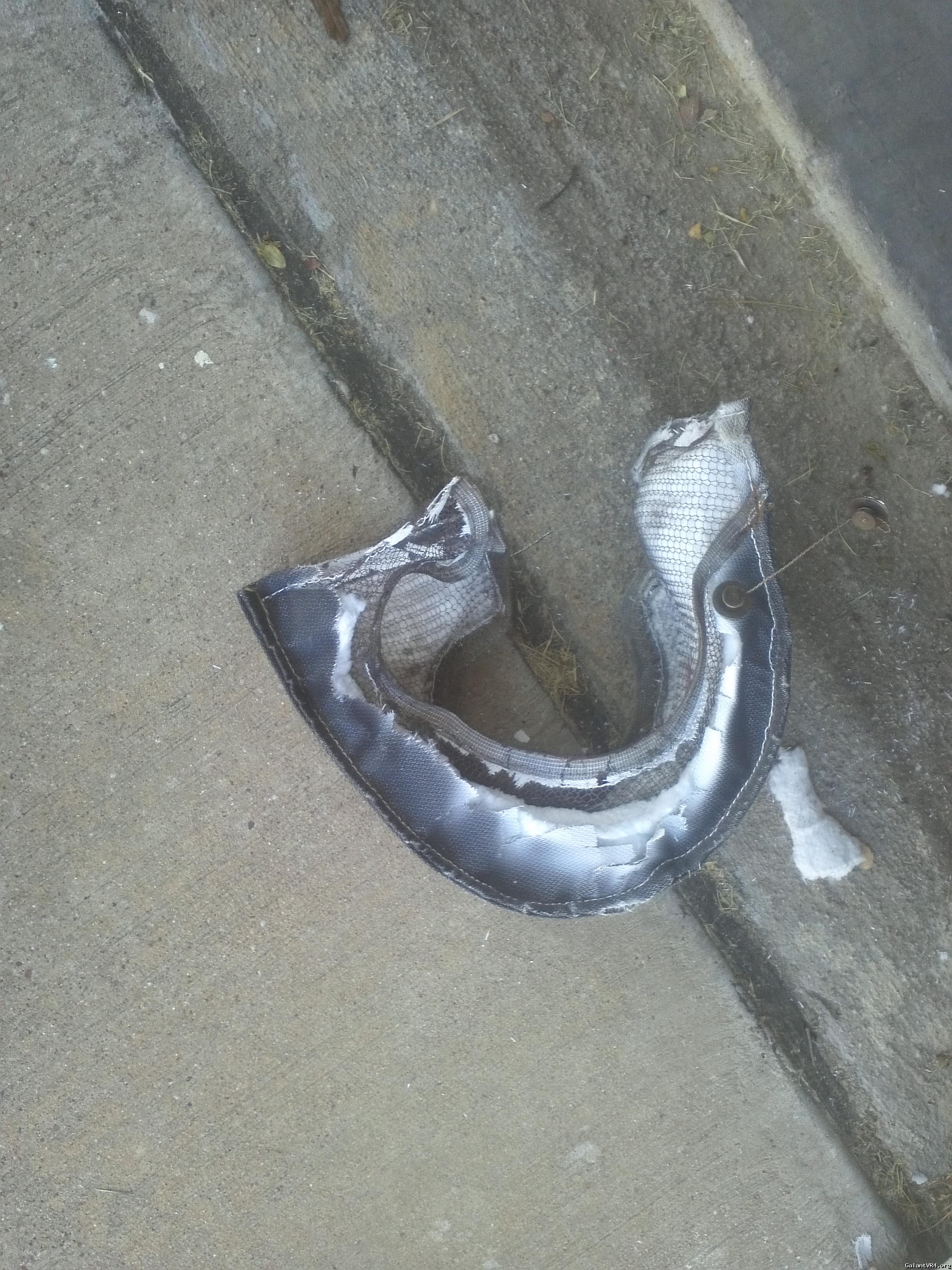

I had a PTP blanket on my 3052 for about 6 months or so. The car was driven occasionally, probably not more than 2K miles, when I discovered the Tial Wastegate was leaking and pulled it off to repair it. In the course of pulling the wastegate off, I noticed that the turbo blanket had burned through in several spots, and a few of the lugs used as anchor points for the safety wire to secure the blanket on the housing, had completely come apart from the blanket.
I ended up pulling the remnants of the blanket off, and chucked it into a corner of the garage. It's still there, I can take pics of what's left. The car wasn't driven hard at all, and the blanket was pretty much rendered useless after a few months. Are these blankets designed mostly for a single use and need to be replaced anytime you pull the turbo?

It was a PTP blanket designed specifically for the FP30 turbine housing. Not sure if it was a Lava blanket or if they offered upgraded materials.
While it was on the car, I had no complaints. It worked as advertised, and I'm sure the alternator liked not having a huge ass heat sink radiating next to it. My only bitch about the whole thing is the durability of the product.
I forgot I snapped a picture when I pulled the wastegate a few months ago:
At this point, the blanket is pretty much useless. The T/H was ceramic coated, so I just yanked the blanket off, and it seems to be fine so far. I might pick another one up if the heat becomes an issue again, or if they offer the blanket with upgraded material.

Thanks for sharing your experience on that one. I would be curious to know how effective your ceramic coating works on the housing by itself? I had thought about going that route instead initially but imagine using both would be even better. At this point, was thinking about just using the blanket though.
