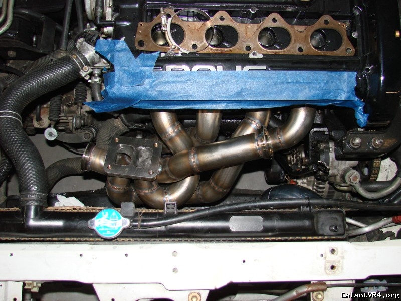

-Sch 10 1.5" 304 stainless pipe.
-TIG welder set to D/C at about 100 amps, 3/32" Tungsten, 3/32" 304l Filler rod.
-*Completely* Back purged with argon. (Inside of the pipe to be welded)
-Never re-weld again.
This is what Shearer does, and what every good fabricator does.
If your manifold has all these things considered into it, it will last forever. No coatings, brackets or other band-aids needed.
You guys are making serious horsepower now-a-days, welding skill should be a given.
Shearer is nice, but, backyard Honda guys have been making manifolds like this for YEARS.
