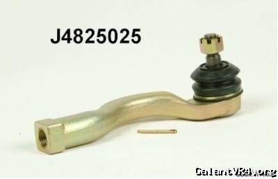

Try searching again under my name, I definitely mentioned this and the parts are on my car now. It may be in my build thread. If you are nice I'll also take a look on my laptop at work. I believe I have the part no.s listed there.
Edit: Found this old thread which has a picture of the Montero tie rod end about half way down.
Bushing Thread
It only has one part no. but you should be able to get the other side through CAPS. Can't help you on year though!
