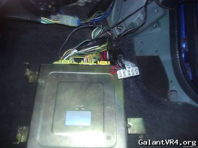

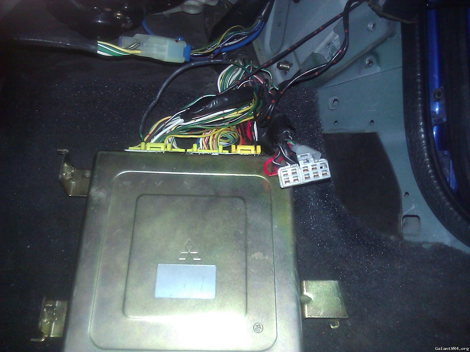

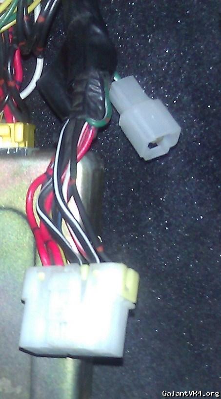

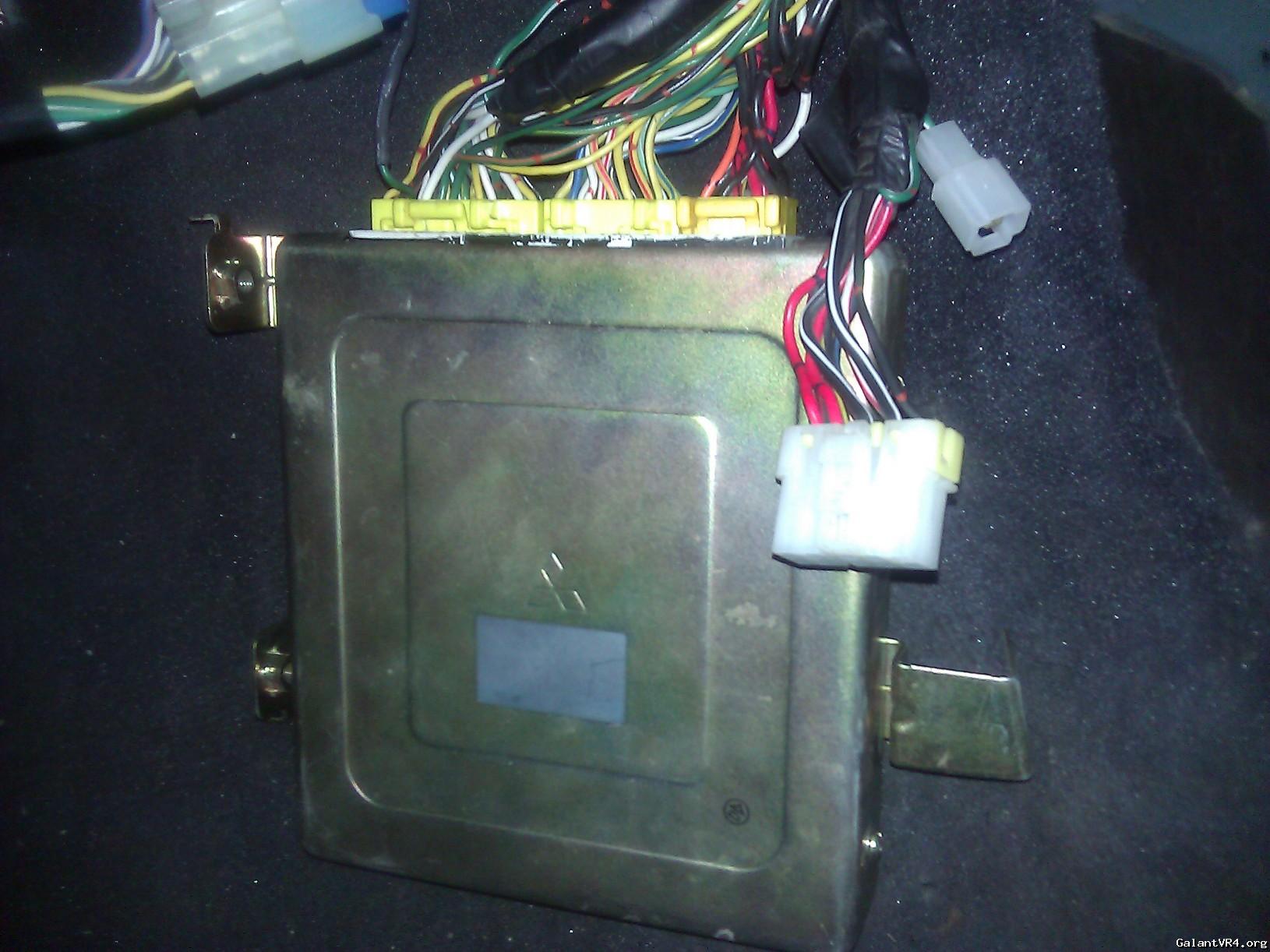

So I believe I'm missing the MPI control relay here, but I'm not sure? Can someone confirm this? It is the larger white plug with nothing attached to it pictured on the right side of the ECU. I'm mainly going by this pic here click
Also, can someone tell me what the other smaller plug is pictured above the larger plug?

Yup... the small one is for narrowband O2 readings.
If you need a MPI relay, I think I have one hanging in the garage.

One more thing... That small single spade connector you asked about? It's a great place to plug in a wideband for narrowband sim with ECMlink V3, so long as you've disconnected the stock o2 under the hood. It beats trying to cut, crimp, solder or vampire clip other wires to the ECU. I scavenged a connector from the junkyard so that when i tied mine in, it plugs in like a stock piece. Easy in, easy out.
