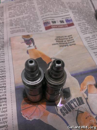

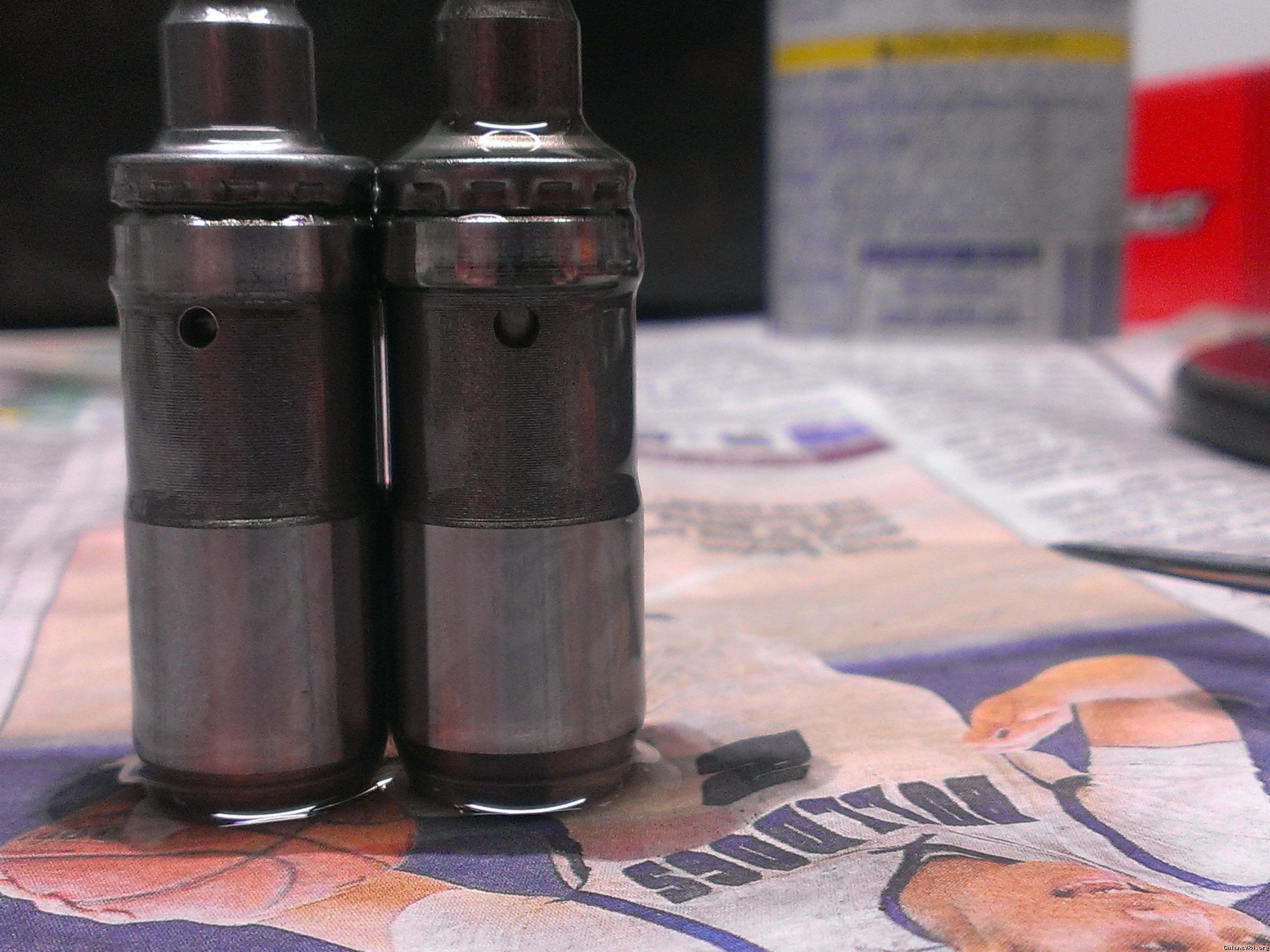

Got a set from engnbldr. not as nice as the last set. The new one is on the left one i got last year is on the right.
Both holes are smaller on the new ones. Some of the caps are very loose and pressure can escape from underneath them. Not too happy with that. I'm going to try to crimp them down tighter. I emailed him about them. He told me his distributor passed away and has found a different source since last year. He can't get the other ones anymore.

I am in search of these 3g lifters but it looks like engnbldr's new 3g lifters are not as good as they used to be? any other purchasing options? can't i just go buy a set for a 3g eclipse or 00-05 sonata from rock auto?
I just picked up a set from him, too. Good thing I checked this thread.
tektic
Dec 19, 2012
1,498
ronkonkoma, ny
When I asked about it he said that the holes are smaller to reduce lifter calapse at high rpm.
He also mentioned the caps don't need to seal oil pressure. I don't know if that's true or not.
